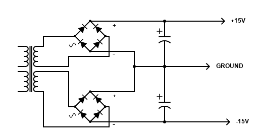

Any idea what i can do (audio oriented) with a single secondary 0 - 44VAC toroidal transformer, 290VA..... i have one sitting on the bench....

Many class D amp circuits / boards run off a single rail DC power supply and that transformer would make about 62V DC unregulated.
If you can get another identical transformer, you can build a dual power supply for a class AB amp in the 150-200W / 8 ohm range.
One transformer for the positive rail and the other for the negative rail. I built an amp this way in the 90's which I still use.

)44 * 1.4) - 1.4 = 60.2 v. Just about perfect for a first generatioin solid state class AB amp like a Armstrong 621 or a dynaco ST120 . The speaker capacitor prevents burning the speaker if a solder joint pops loose (As my diy bike battery charger did today).

would you be kind to share the schematic of how you built that power supply with two transformers... thank youMany class D amp circuits / boards run off a single rail DC power supply and that transformer would make about 62V DC unregulated.
You could use this circuit at 50v it will easily give 100watts and considering your transformer is 44vac you should get close 60v once rectified and smoothed. I would replace the output devices with something a bit more modern 2SA1943/2SC5200 and 15032/15033 predrivers
