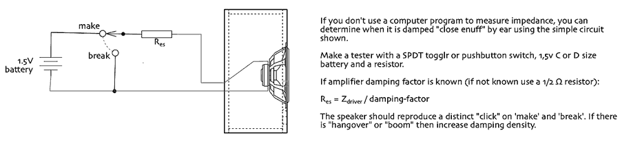

I played around with the vent damping and the impedance is flat but it is elevated, is that ok? Also I pulled the woofer and swept it in free air and the wiggles at ~250 and 500 Hz are still present so it's something in the driver itself.
The flatter the better. It is a small box so perfectly apeirodic is likely not within reach.
GM’s click-test might be useful.
In the end, what does it sound like...
dave
dave
GM's click test is a good idea. I may have gotten over zealous with the felt on the rear panel, there was enough to do 3 layers so it's probably 1.5" or more of heavy felt. I didn't glue it so I can take one or two sheets out and see if that improves things. They sound very good to me, I have them sitting on a pair of SB-3000 subs so there is no lack of bass.
