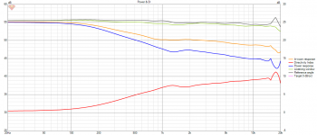

I - finally - did measure my ST260 with a BMS 4538. Measurements at 1m and 100mW. Simulation 1m/2,83V targeted for use with an 10" driver I have somewhere....
Graphs represented with LMS software but measured with Clio 12.5´
TNT; can´t wait for yours as the 5530 has been on my list for a long time....

I'm nor sure I will be able to produce all those angles..., but I trust the WG 🙂 I will do on axis SPL etc for sure.
How did you do the last "Simulated" one?
The 7k drop, whats the reason for that?
I´m using LEAP5 for simulations. Done that for 20+ years. The dip is from the driver - don´t look at it, the normalized curves and DI tells more about the WG. But as the driver makes +20kHz nicely one can see that the WG is doing it`s job well 😉I'm nor sure I will be able to produce all those angles..., but I trust the WG 🙂 I will do on axis SPL etc for sure.

The BMS driver, I believe, has two diaphragms. That's where they transition. I've seen this many times before.The 7k drop, whats the reason for that?
Nope, this is a single D simple one. Small with 38mm voice coil.Hi
