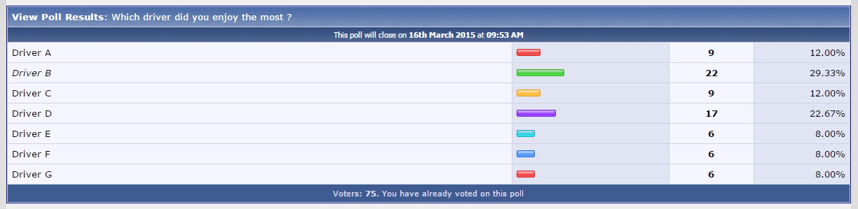

The Big Reveal
Here is a snapshot of the results circa 16:00GMT.
470355d1425831425-subjective-blind-comparison-3in-5in-full-range-drivers-results-mar-9-2015-circa-1600gmt.png

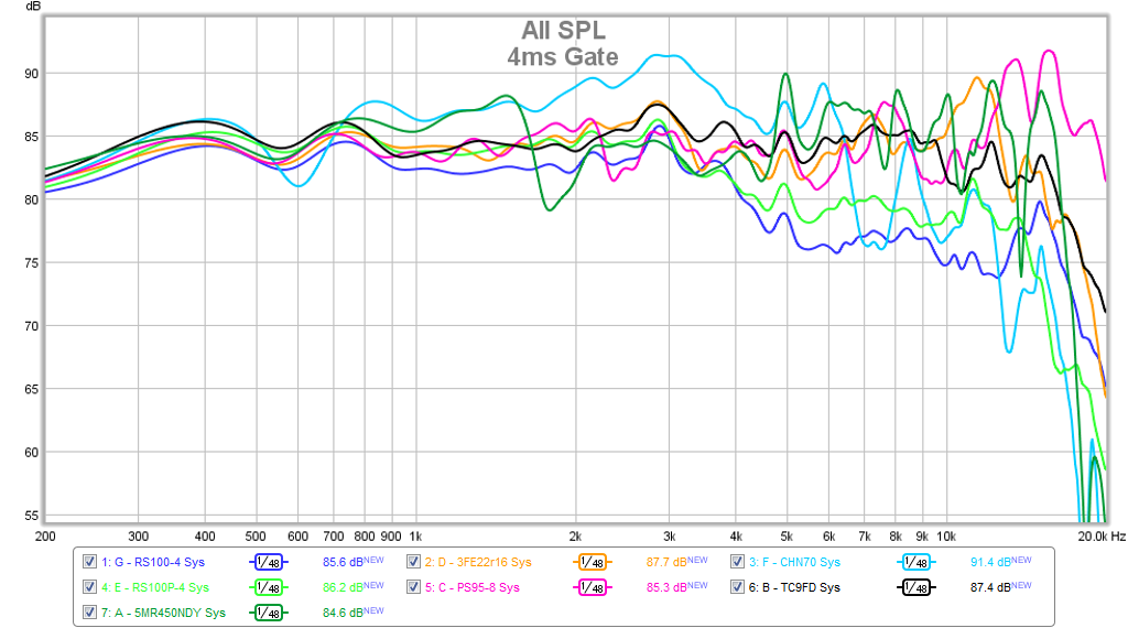

Here is the high resolution 1/48th oct smoothed with 1ms gate before and 4ms gate after data:
470357d1425831899-subjective-blind-comparison-3in-5in-full-range-drivers-subjective-blind-comparo-reveal-4ms-gate.png
A = PRV 5MR450NDY
B = Vifa TC9FD
C = Dayton PS95-8
D= Faital Pro 3FE22r16
E = Dayton Audio RS100P-4 (paper)
F = MA CHN-70
G = Dayton Audio RS100-4 (aluminum)
** more data to come **

The winner is the TC9FD. No surprises there...

And again it has been demonstrated that drivers with a smooth frequency response are preferred. Thanks for putting this test together X.
attachment.php
Frequency response is NOT meaningless. It is still the number one criteria for every driver. No other performance characteristics can make up for a good frequency response.
If the driver isn't smooth it needs to be equalized -- even a TC9. This works for some drivers while others are beyond repair.

I prefered E followed by G. G for a slightly brighter balance if wanted. The others were too bright for my liking. And the downward upper tilt on the RS drivers helped to fill out the thin midrange, all of them need more BSC imo.
The one I ran away from was F. The MA driver, no surprise it's the least linear.
I don't know why frequency response flatness comes as a surprise, it is the no.1 parameter required for good sound quality.

My exact thoughts on this. Maybe the slight on axis rise for D in the top octave flattens power response a bit? It's still pretty flat throughout most of the range.

hum d appears to have the least deviation across the displayed bandwidth (flattest response) but did not win why?
I had rated D high at first glance, but for me it lost in a direct comparison to B. So G and E were second and third for me after B. So there is more than just an even frequency response I reacted to.
