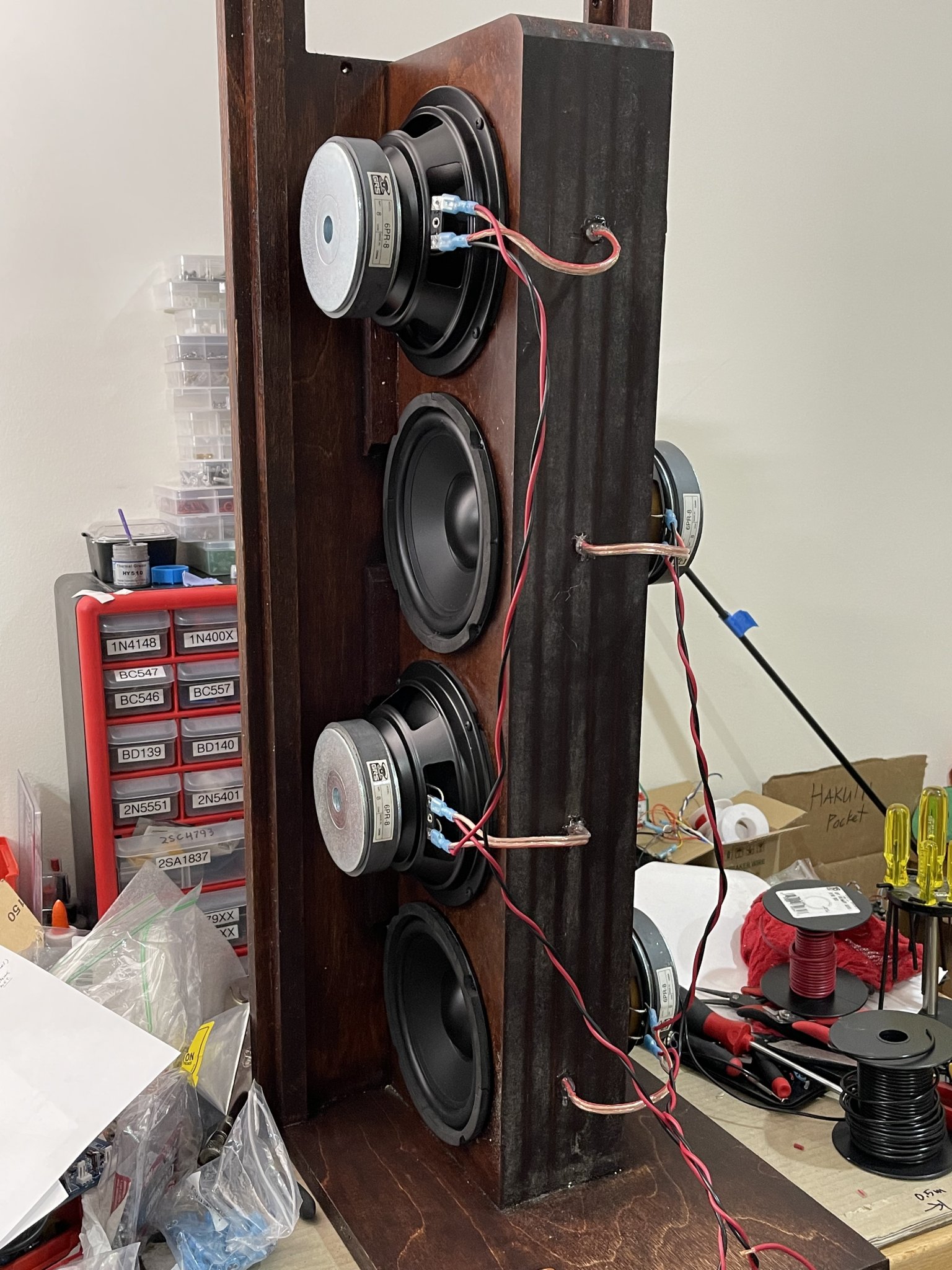

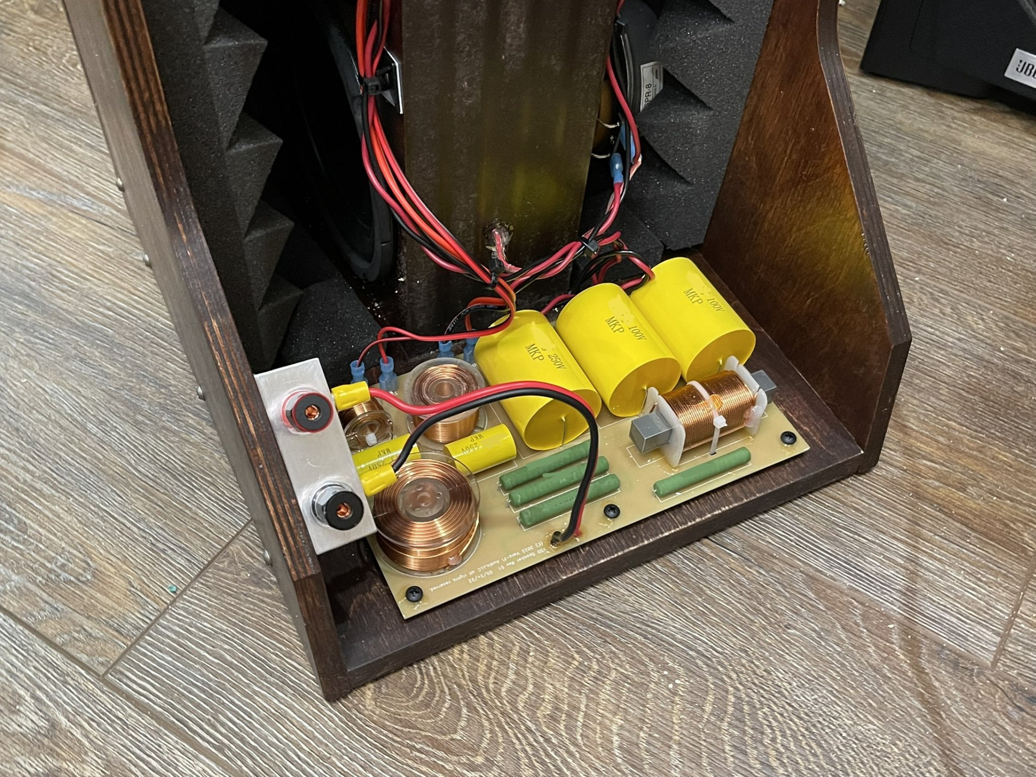

I used 16ga double zip cord lamp wire for the parallel connection to the pairs of woofers and 16ga red/black wire for the mid and 20ga red/black double wire for the tweeter. I crimped all connections with Faston terminals. I may have used some twist wire nuts for the final series to parallel connections.
Here is woofer wiring diagram:
I tidied up the wires with zip ties and stick on anchors and connected to XO board at the bottom:
Hope that helps.

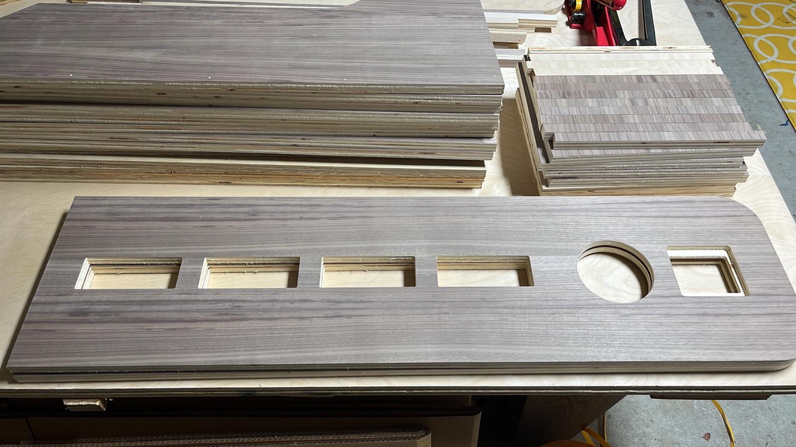

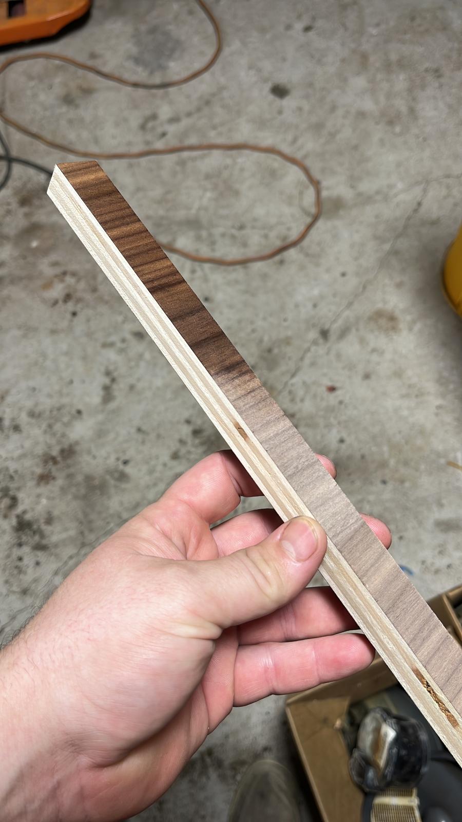

Earlier in this thread here. But I’ll repost below. Cost of walnut veneer plywood flat pack is $750 ($600 for plain birch veneer plywood). UPS shipping in CONUS is $150. Pickup in Texas available to save on shipping. It is possible to ship to EU for circa $150 using shipping forwarder - described earlier in thread.

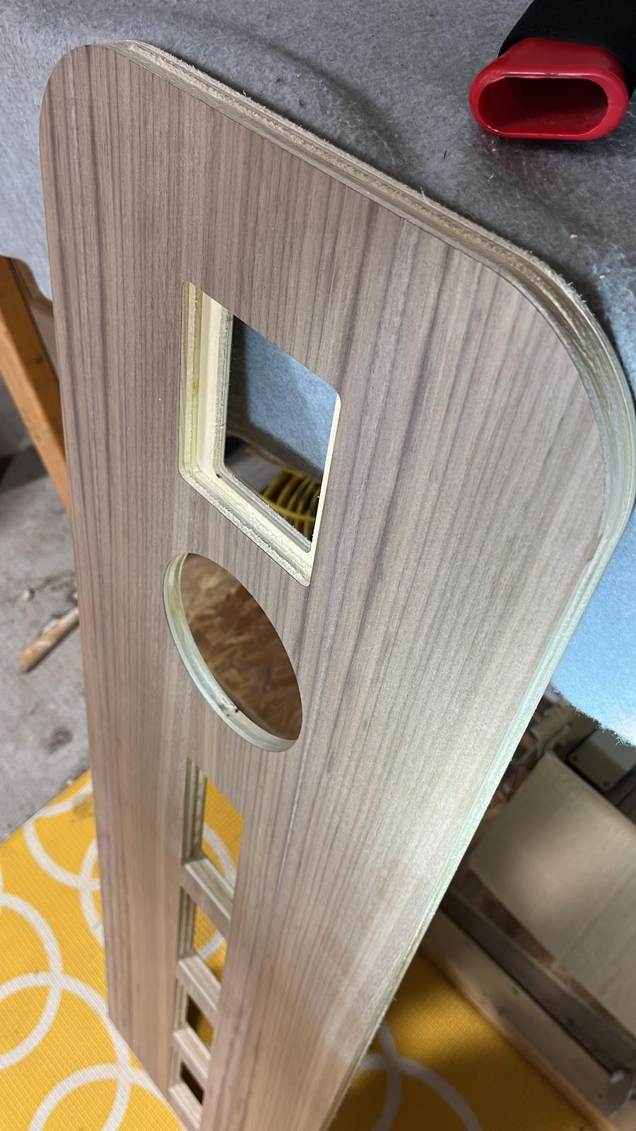

Once you oil it the color comes out much deeper:

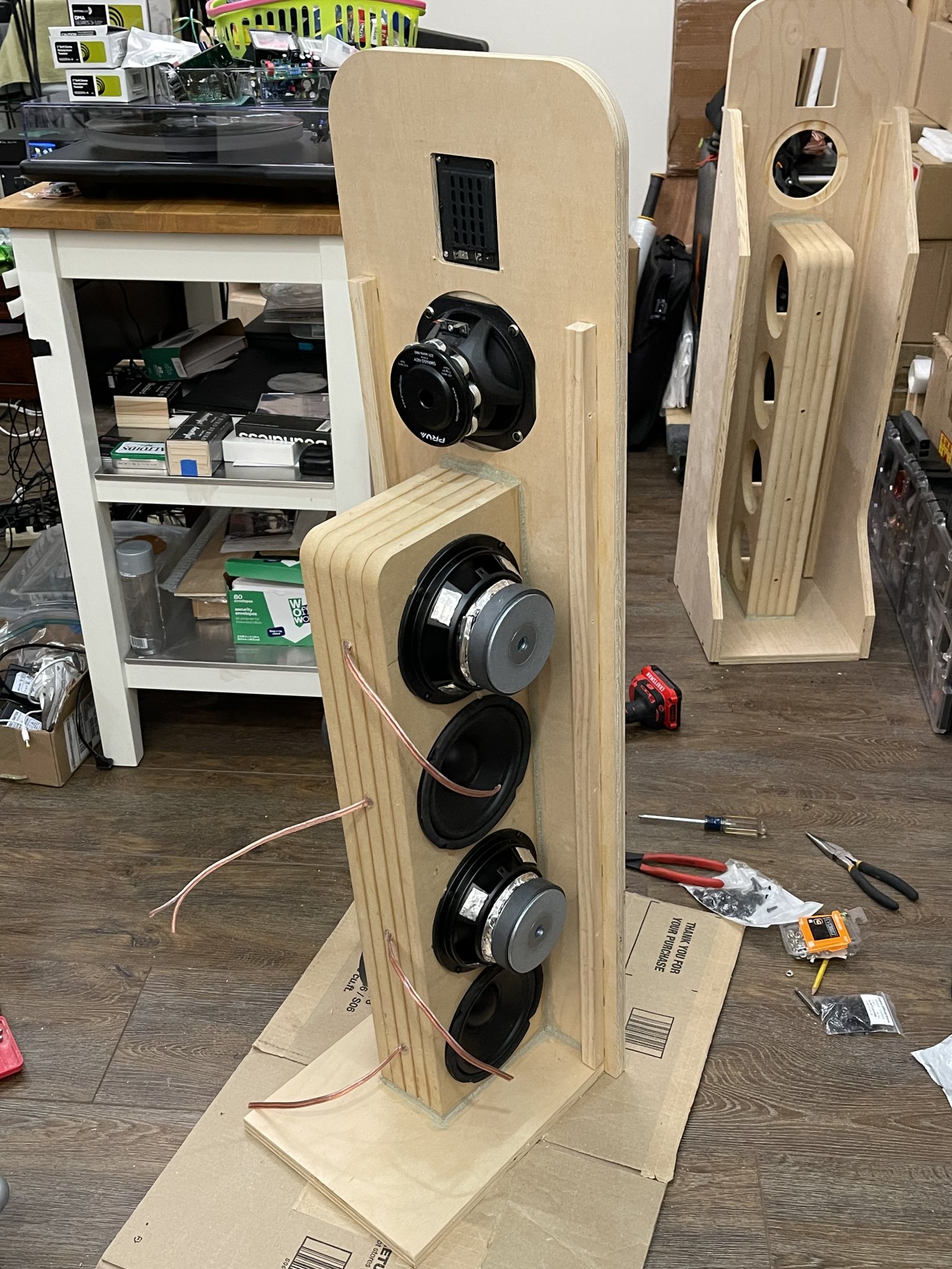

Got a bit more work in this weekend. Drilled holes to allow woofer pairs to be wired together, wires installed, remounted woofers. Crossovers ready, just need to decide on wire for mid and tweeter. Then, the other speaker. Slowly getting it done.

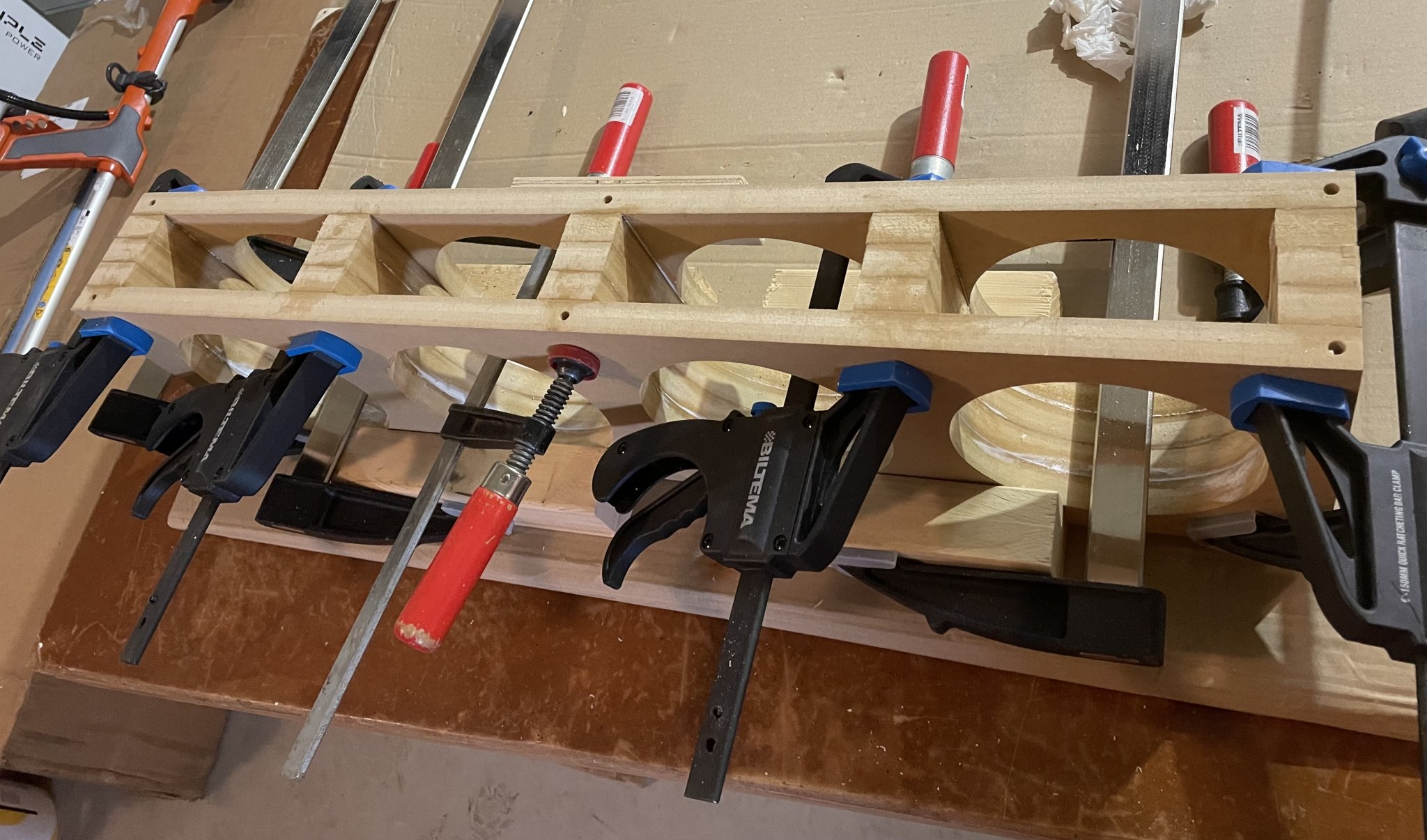

I had dowels so it was easy to get the parts to fit.

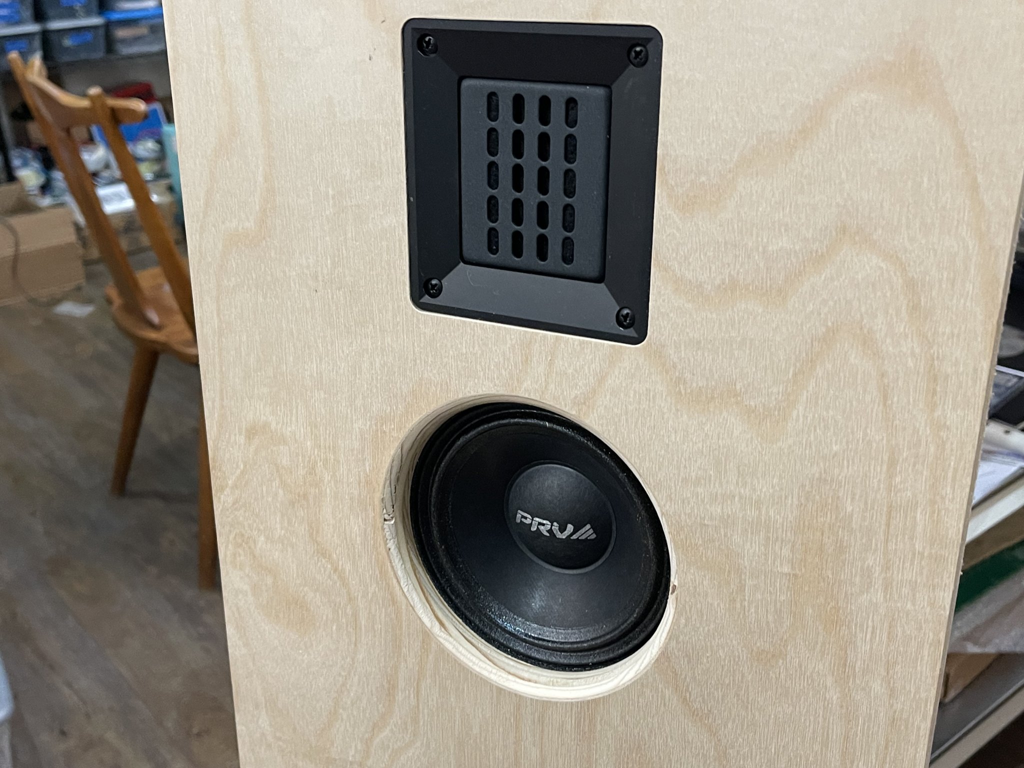

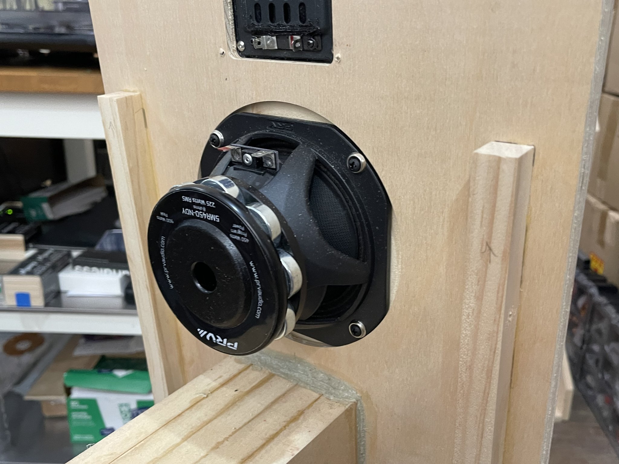

I finally got all drivers installed on one speaker today.

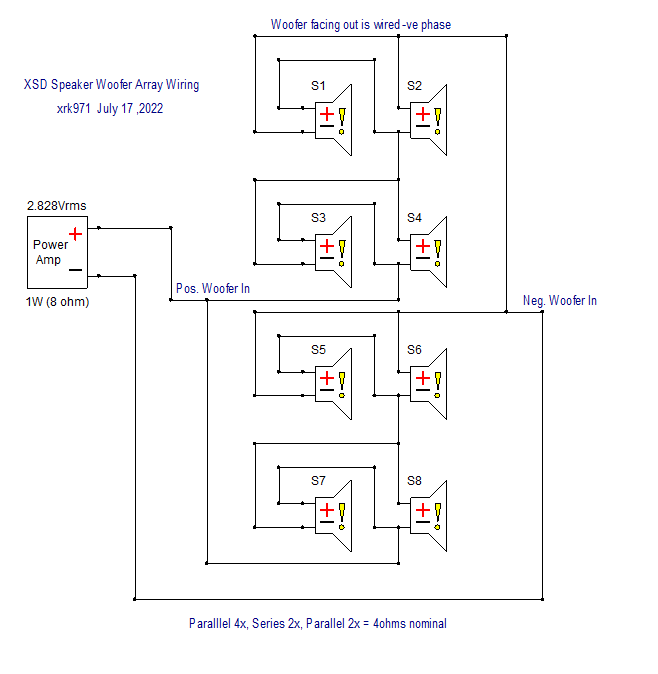

Thanks! My spool of all copper 16ga clear jacketed speaker wire just came today. I didn’t want to use ordinary black and red wire as it sort detracts from the visuals when next to the wood. I’ll try to get one speaker wired up today.
Looking at the woofer wiring diagram:
Each driver pair is in parallel (4ohms) with the one with magnet facing in set to reverse polarity. Two sets are then wired in series (8ohms). Those two series are then paralleled (4ohms). Or P4/S2/P2 for 4ohms nominal.
