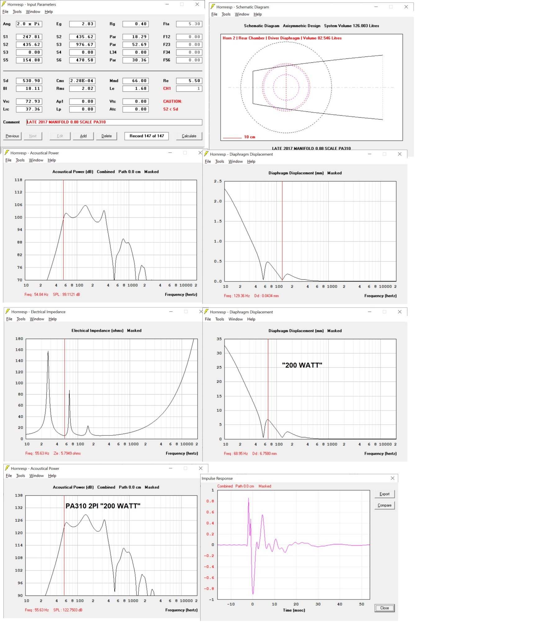

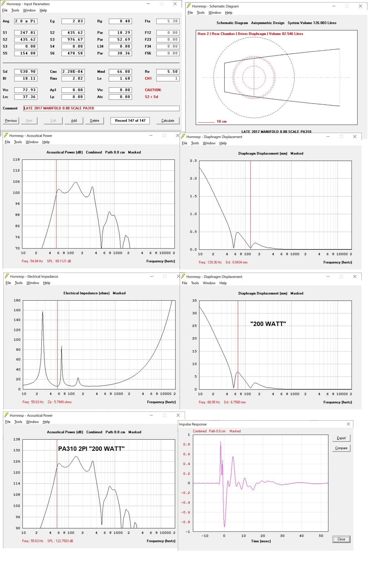

here's a stab based on that JBL 14" driver - at 0.88 with PA310 (already have that driver) - looks like a 55Hz speaker

anyhow here's the PA310 in the 0.88 scale manifold.

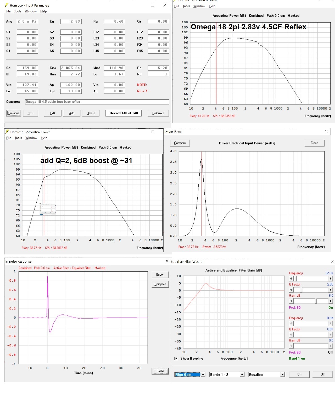

and for comparison - my builder's speaker - a 4.5 cubic foot reflex with Eminence Omega 18 whose specs are suited for 6th order work and they can have nice impulse response. (he doesn't do that stuff)

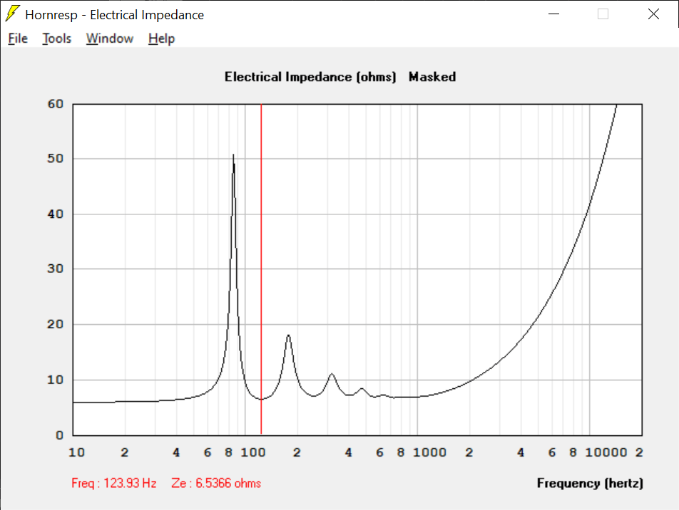

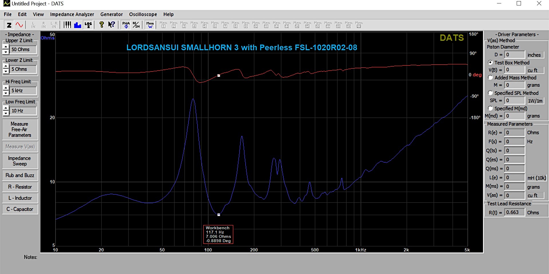

Here's input impedance for smallhorn3 loaded with a Tymphany 10 "pro" speaker.
also - a predicted impedance
