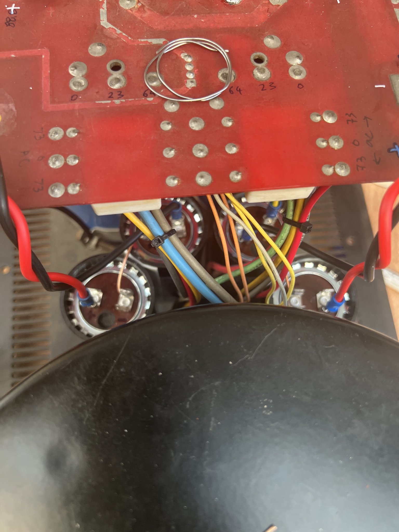

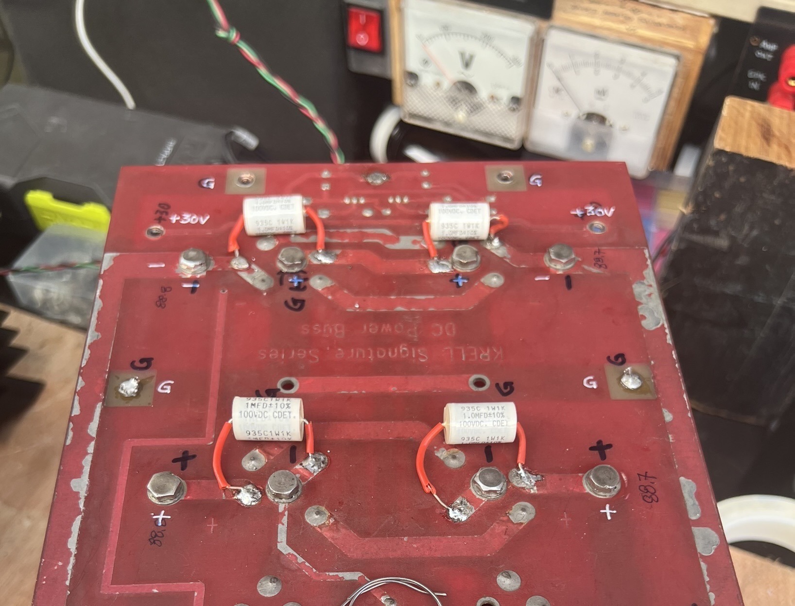

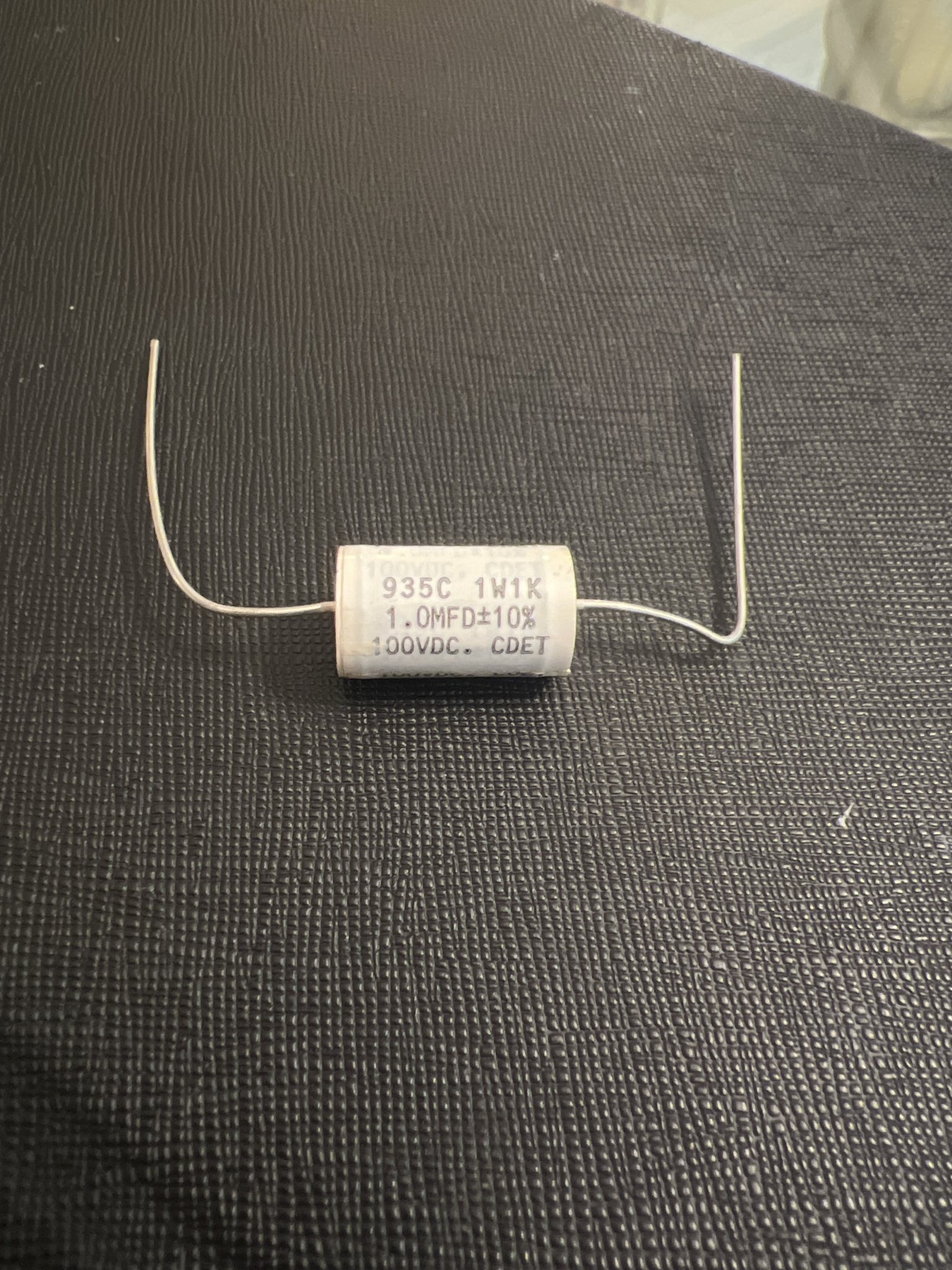

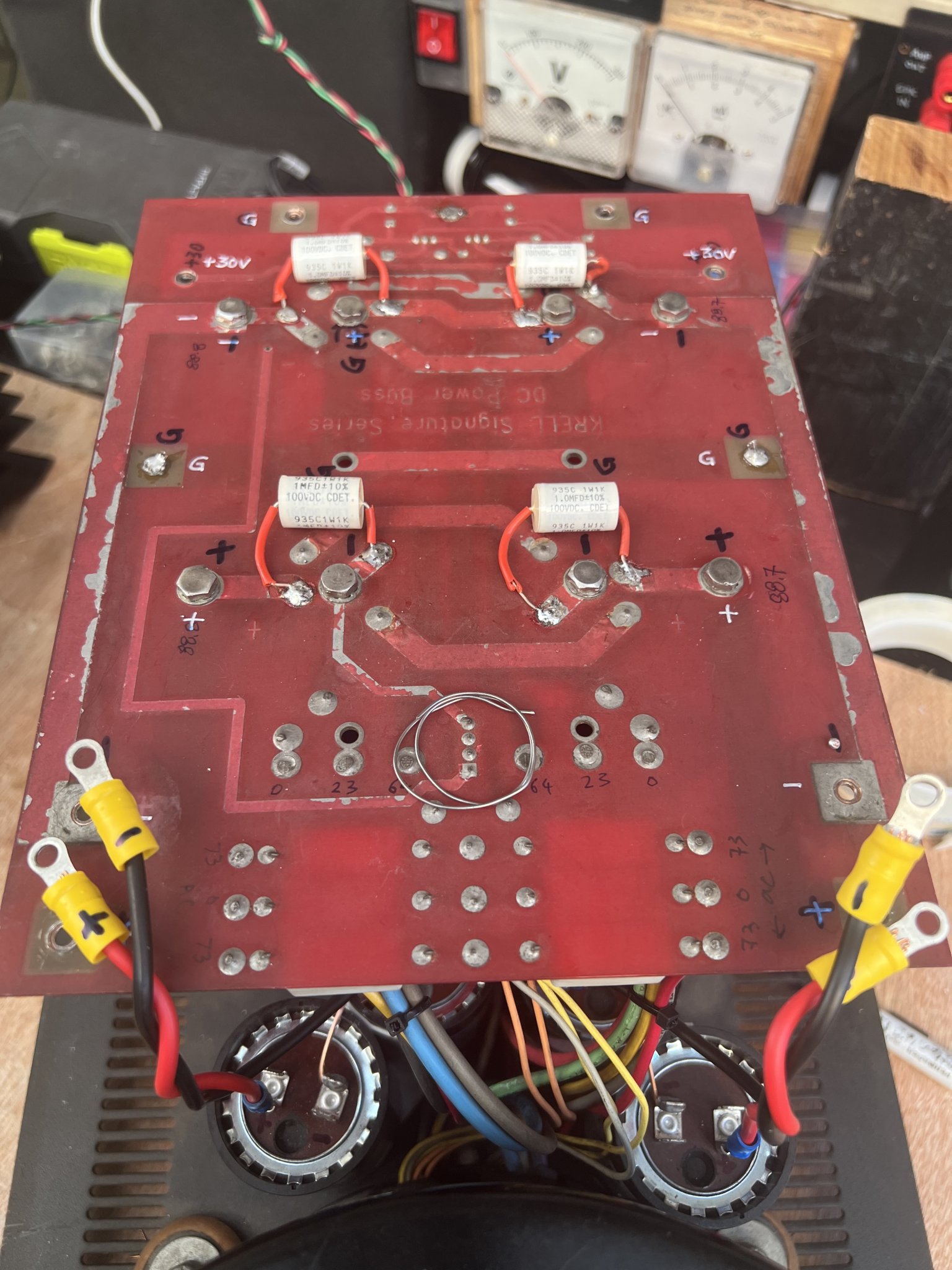

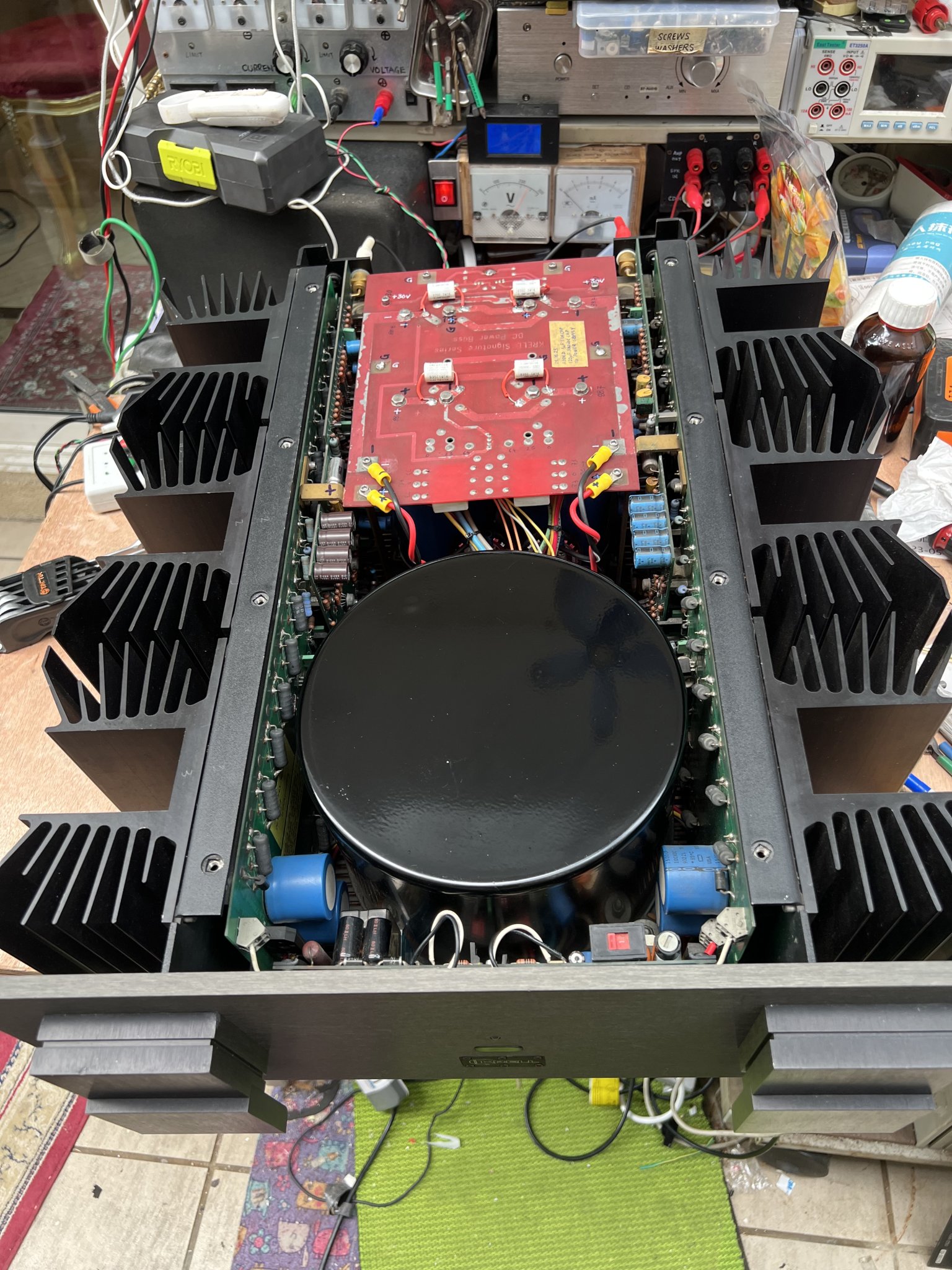

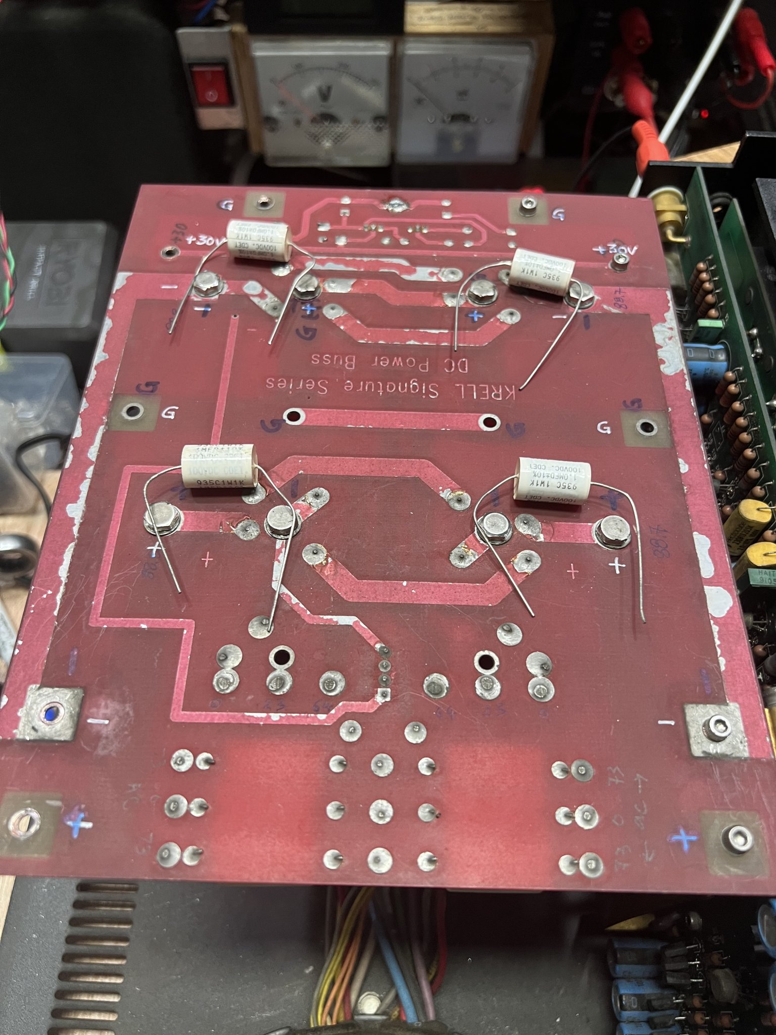

After repairing the Krell 250, I proceeded to upgrade the amp which deals with the power supply section. The first one is an easy tweak which all modern audiophile grade amplifier incorporates. This is to bypass the large electrolytic filter capacitors with small value high quality film capacitors. In this case I use 1.0uF 100V polypropylene film cap. Four pieces, one across each of the 68,000uF capacitor.

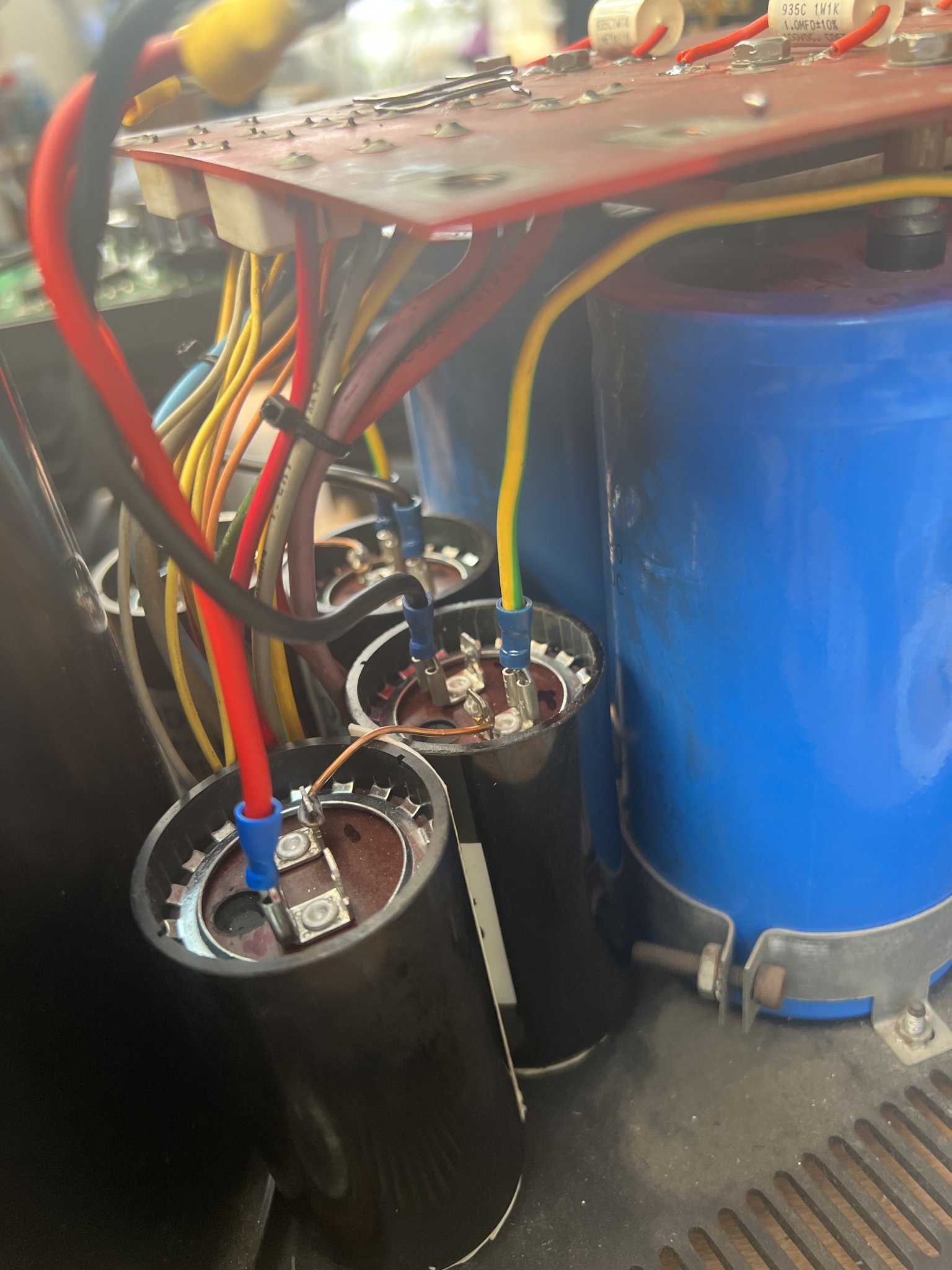

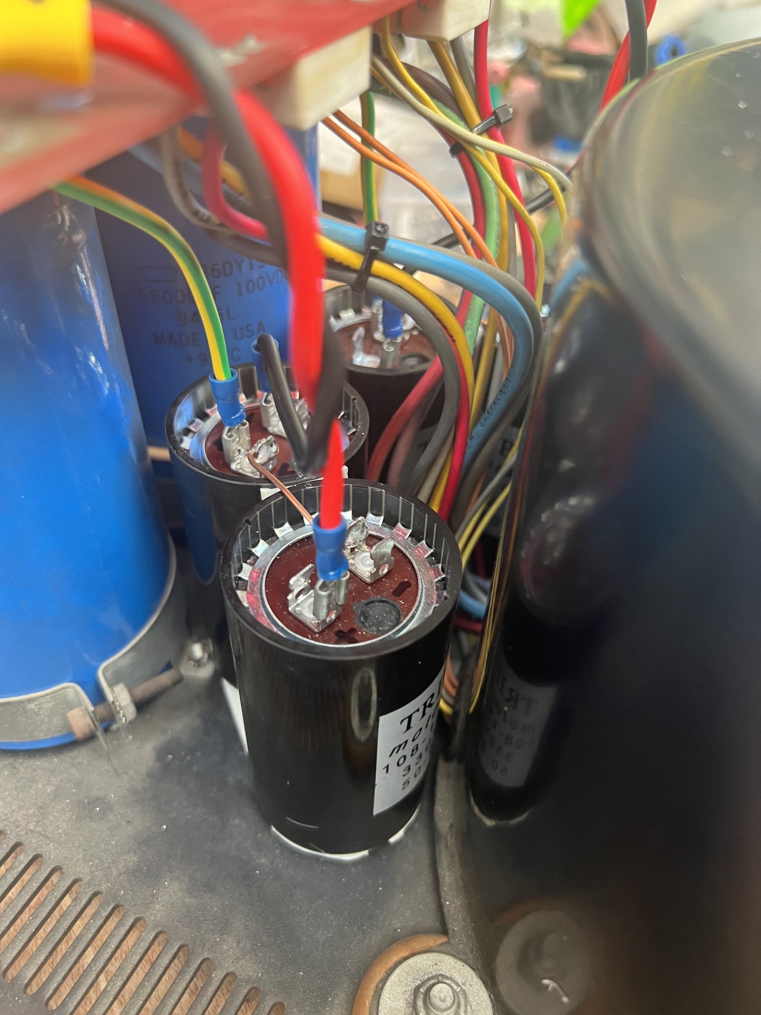

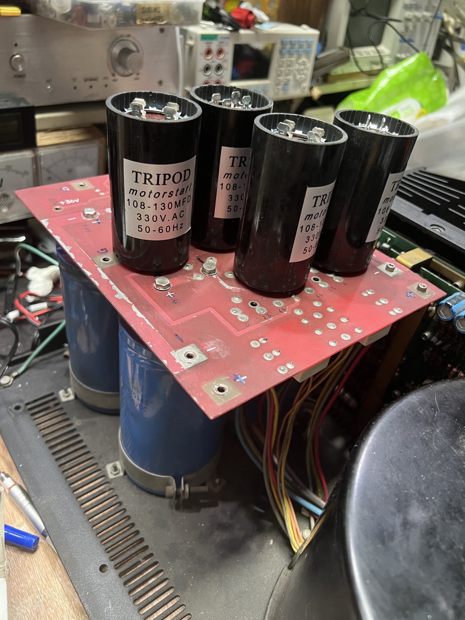

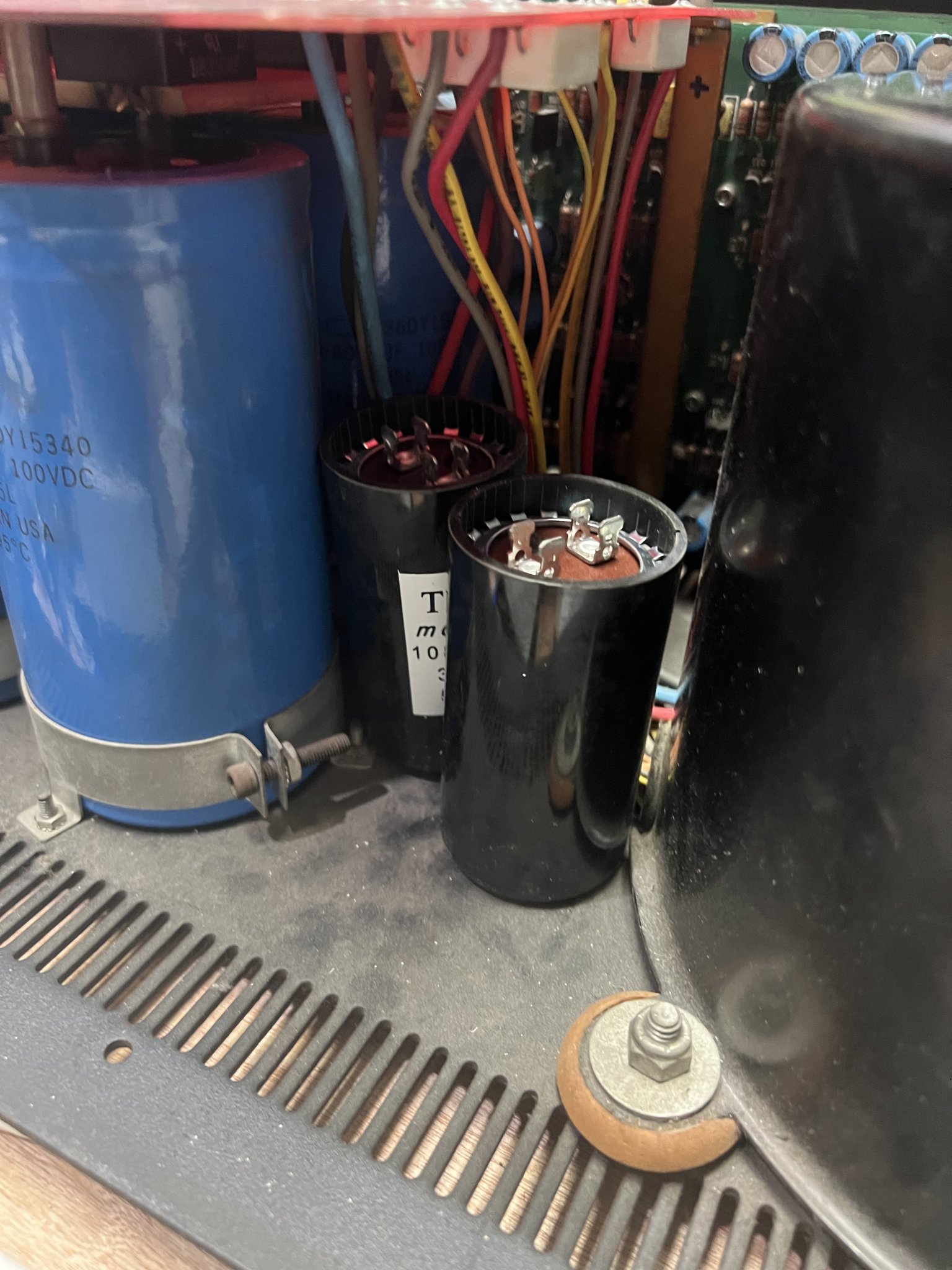

The second is slightly more elaborate as it involves adding 4x 120uF motor start 330Vac capacitor. I copy this idea from another fellow DIYAUDIO contributor, ZenMod. He makes many contributions and idea on the Pass Labs forum. It is said make very significant improvements to sound quality. Especially in the high frequencies.
