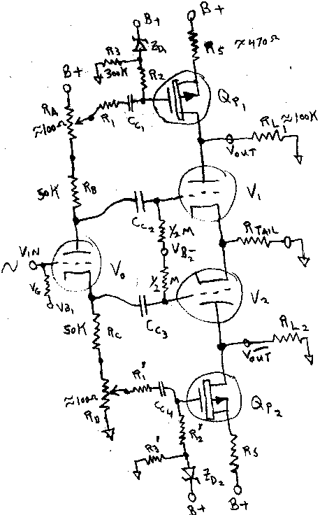

I posted this scheme over on the "Diff Drive" thread, since Rich Walters got me started thinking about it. (derived from DePalma's splitter there) But it may be of interest here for a P-P driver. It should be able to drive decent loads.
Explanation:
The P-channel Mosfets are set up so as to operate in "near CCS" mode. The drives (Ra, Rd pots) to the Mosfets are adjusted so that the driver tubes (V1, V2) continue to operate with constant current WITH their actual loads attached (which would presumeably be some output tube grids and their biasing resistors).
This is slightly different than a CCS load, since the P-chans are adjusted to actually provide the output current so that the drivers still operate at constant current despite the load. The drivers (V1, V2) are low impedance outputs though, so they still maintain control of the output voltages.
This allows the driver tubes to operate in CCS constant Mu mode, even with load currents present. So this is an improvement over ordinary CCS loading.
I have drawn triode drivers for V1, V2 in the diagram for simplicity, but these could just as well be pentodes with screen feedbacks from the output plates (crossed feedbacks).
The interesting unknown here is what happens if the P-chans are adjusted for a little more current drive than the output requires. Then the V1,V2 drivers would begin to operate with a little less current when pulling down the load.
Since tube distortion increases with more loading generally, this would now provide anti-loading (or neg. resistance loading) for the driver tubes. Maybe one could adjust out some residual distortion from the V1,V2 tubes that way (providing they don't oscillate).
Don
PS: could use the same scheme for a P-P output stage too.
