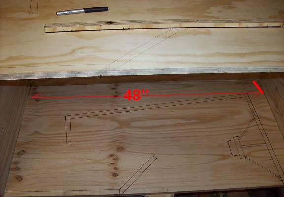

1/4 wavelength of 70 Hz is about 4 feet. How is a 5" reflector going to "reflect" this in any appreciable way? That's a bit like trying to stop and change the direction of an ocean wave with a spoon (ok, that may be a bit of an exaggeration, but still)...
Based by your diagram, *maybe* replacing part of one parallel surface with a surface with a shallow slope might change the 'Q' of the resonance between the two walls a bit. This might explain why a shallow slope works better than the steeper 45 degree reflector. But then again we're talking about a 5" difference, max.. The mathematicians here can work out how much the Q will change with that difference (it's Friday night and my mind is more on beer instead, LOL), but I suspect that it's not going to be much. However, it should be possible to get better results by just lining one side (e.g. the end closest to the driver) with enough fill to cut that resonance significantly.
Further down the horn the reflectors will get larger, and therefore more effective at lower frequencies. But still, none of them approach 4 feet in width...

Well Brain, the problem(s) with acoustics is often more complex then our first thoughts, especially on Friday nights! BTW in an open-field environment you would be right. With a spoon you can’t stop an ocean wave, but sure a spoon (with enough backup) can bend a beer ‘jet stream’ that is leaving a barrel under pressure. This is a matter of controlling environmental circumstances. A horn is all about controlling the environment for the sound waves.
Now back to your question; sound waves with bigger wavelengths then the surface they reflect from, will simply bend. They can’t leave the box nor causes the corner enough friction to change the energy of the sound waves into heat. So for the sound wave there is only one solution and that is bending and following the path we carefully set out for them.
Standing waves however are the result from sound waves bouncing (reflecting is a better word actually) between two parallel surfaces. The more bends we have in a horn the more parallel walls are introduced and the more ‘spiky’ the outcome will be.
Every bend in horn design means a loss in energy by the introduction of unwanted physical side effects. One of problems is a different expansion factor within the bend. The other factor is that the waves runs into a straight wall and can possibly change into a standing wave. In that case the energy will partly bounce forwards and backwards between the walls until its energy is gone (actually changed in another form of energy).. This we will hear (and see in our measurements) as a dip.
With reflectors you can strive to a more optimum wave bend with less differences in the expansion path and more importantly to prevent standing waves. If you make the reflector to big it will influence the horn path negative by obstructing the sound wave instead of bending it. If you make it to small it wont have the effect (or minimal) what you are after.

If you look at Sanders Tham, you see 3 places where standing waves can develop (and they all have similar length). My point in the picture of post # 37 was that Jbells suggestion for reflectors will not deal completely with the standing waves because of two reasons:
1.) There are still enough parallel surfaces where standing waves will develop (I marked that with the green area). Jbells example of his significant improvement of 4dB was to solve his problem at 70Hz. This means he had two parallel walls around 122cm (48inch) causing a standing wave.
2.) The second reason needs more explanation. How a relative small and shallow reflector can give such results is a matter of careful placement and understanding of standing waves. In literature (published in AES papers for example) you will find experiments that show that walls start to suppress standing waves as soon they have a > 10 degree difference. However this is frequency related. The higher the frequency the bigger the angle you need. If you want to suppress standing waves over the whole spectrum you need an angle of about 30 to 40 degrees between the two walls. That’s why most walls in recording studio’s have each a traditional angle of about 15 to 20 degrees.
Now, Jbells 4 dB example was at 70Hz and Anders Tham problem is around 175Hz. It means that a similar angled reflector of 12 degrees for the Tham is not going to be as effective. Therefore I suggested more steep angles. The problem with steep angled reflectors is they start to narrow the horn path. Instead of reflecting they start to obstruct the sound waves. That’s why I think you cannot get away with just 2 reflectors as Jbell suggested. In my opinion the Tham would benefit from multiple reflectors that ‘see’ each other. But the use of multiple reflectors will give unwanted side effects and Jbell was trying to warn us for that...

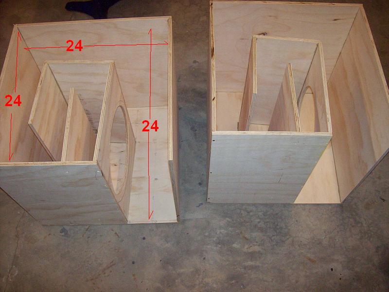

Brian:
As I said a few posts ago... I'm not going to convince you of anything.
When you build the cabinets, test the cabinets, change the reflectors and then retest -- then we can have a discussion. Building one or two cabinets and only adding bracing as your effort of 'improving' the cabinets... well that doesn't address the standing wave discussion we are having. If you've never built a cube or some cabinet with dimensions that are all multiples of each other -- you've never seen an extreme example of standing waves, so therefore you dismiss it as 'not possible.'
Part of the reason I abandoned the cube was for this reason, I was always messing with the reflectors...
One more study on standing waves and where they actually occur...
My POC#1 is basically a tapped pipe, split into four equal sections of about 19.5" each, then jointed together to form a box. Now, this should produce the WORST possible result with respect to standing waves, as three of the components of this box have walls that are the same distance from each other (19.5").
According to Everest, the first standing wave should occur at (1130*12/(2*19.5), which works out to approximately 350 Hz.
Now, here's an actual measurement of that alignment:
The green line is the predicted response from HornResp.
The blue line is the measured response. It shows several things, amongst this being (1) the driver was not properly sealed to the box, hence the dip and peak at the lower end of the passband, (2) the effect of a 100 Hz 12dB/octave LP filter, (no surprise there - I was driving the sub using the subwoofer channel from my receiver), but I want to bring your attention to is (3), the point at which the predicted peaks and nulls start to depart from HornResp's predictions. From the graph, it's clear that this is starting to happen above 300 Hz and actually closer to 400 Hz - a very good correlation to the 350Hz fundamental predicted by the above equation, above which the response will be affected by the box geometry.
