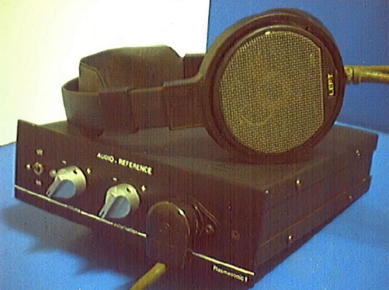

In the video, we speak at one point of a solution with two rows of wires developed by Jean-Claude Fourrière which had a poor performance.
These are the only full-range loudspeakers made by this gentleman in the 90s. The size was enormous and the performance tiny.
The loudspeakers had made a very good test in a French audio magazine and were presented in preview at an audio exhibition in Paris, before the first marketing. Mr Fourrière used a 500W McIntosh amplifier to make them work. Unfortunately a transformer caught fire in the enclosure during the sound show and the company closed sometime later.
The company also marketed "Plasmasonic" headphones on the same principle.
