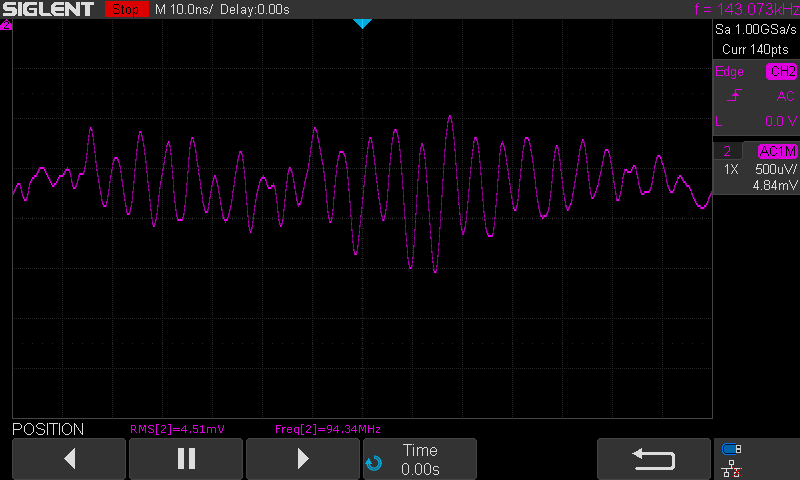

@euro21 shorting the input and measuring at the secondary of the IST, I can measure RF 70-100MHz noise. This is the same I can measure simply holding my scope up in the air. Placing a loop of wire to make an antenna out of my scope, same frequencies are measure all over the chassis, higher near the ISTs. I live in a densely populated area and there is a cell tower less than a mile from my home, so perhaps I live in a very high RF area and the D3a cannot function well here.

It is very difficult to imagine how such low frequencies can be generated by self oscillation, with such a plate load .100MHz, sure, but not 1MHz... Time constants for 1MHz will not be found from ordinary stray L and C, with a R load, especially now you have tightened the layout up.To rule out any interaction of the IST and the D3a, I disconnected the primary and loaded the D3a with a 5.1K resistor. Measured at the plate, same oscillatory pattern
Perhaps the spurious audio spectrum in square wave testing is generated in the power supply?

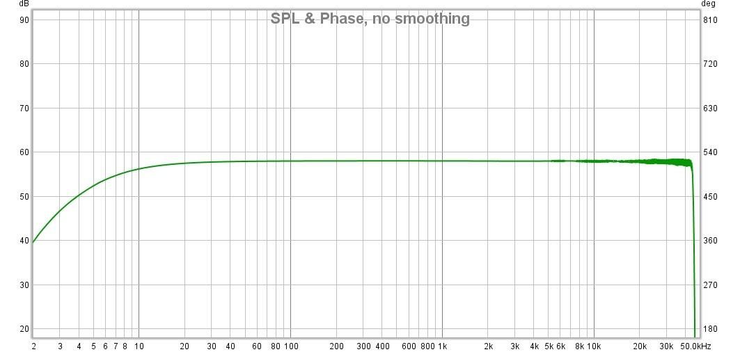

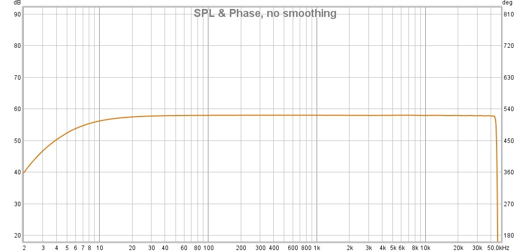

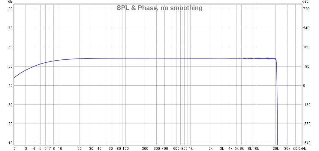

I removed the D3a and did an FR sweep of just the HY69 output stage with the signal input at the HY69 grid and got the below.
The audio band oscillations/ringing persist despite the D3a being out of circuit. I then removed the HY69 and did an FR sweep of just the D3a stage with the output taken at the IST secondary using my Linear Audio Autoranger for signal input and got the below.
Which is quite an improvement. This would seem to suggest the issue is primarily in output stage.

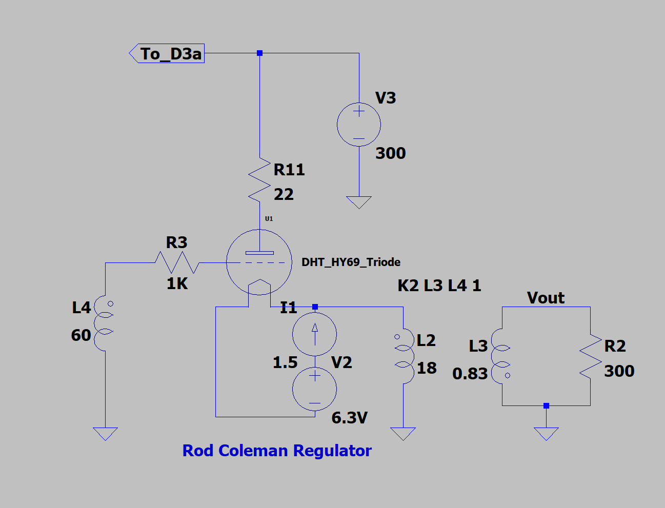

Not shown in the schematic, but G2 is tied to the plate by 100R CC and G3 is tied to cathode at the negative end of the filament regulator, as is the top of the OPT primary.
![HY69 Output.png HY69 Output.png](https://www.diyaudio.com/community/data/attachments/1165/1165793-6c3f475ccad89f43f3b334e1a97d573f.jpg)

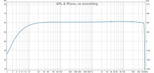

![HY69 FR (1).jpg HY69 FR (1).jpg](https://www.diyaudio.com/community/data/attachments/1165/1165765-74bb4246f5b1f7c59d7fe8f84066b206.jpg)

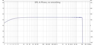

![D3a FR.jpg D3a FR.jpg](https://www.diyaudio.com/community/data/attachments/1165/1165767-23e8e722901be9d017ba050717d91727.jpg)
I'm willing to entertain that, for FR right now I'm using a MOTU M4 DAC/ADC paired with Jan Didden's Autoranger. But I've been meaning to pick up the Diglent Analog Discovery 3, I've invested a lot into this build, so seems as good a time as any to upgrade my audio analyzer setup. Worth noting that I've measured several amplifiers with this setup and have not seen these artifacts.
Not dissing your equipment. It’s just that any equipment can mislead. Not even confident that equipment is your problem. Rather than something assumed is not as believed. The symptoms as described are not responding to treatment that should at least significantly change them based on the diagnosis and the treatment attempted. It’s not adding up. In the end it will be something simple that has been overlooked. I wish I could tell you what it is.
Post #345 had measured sweep results of each stage, with some anomalous signal levels approaching 20kHz in the HY69 stage FR. Given focus on output stage, can the output stage be tested using the same measurement setup but with perhaps some base level configurations, to see if the same anomalous response occurs. Eg. output stage powered, but input and output probes at the same location (such as input and output). Another configuration could be FR from input to output but with anode connection removed. Another configuration could be FR from input to output but with HY69 grid grounded. Also not sure why the FR plot stopped at 20kHz ?
Given you are using a MOTU M4 and autoranger (powered from a USB feed), can you clarify if either or both are effectively powered from the mains ac, or say solely from a battery in say a laptop ? Stray noise and earth loops via the mains can be a concern, as well as quirky USB based comms and some forms of response aberrations (eg. such as in the FR plot of the D3a stage).

@trobbins sorry, yes the top FR plot was stopped at 20kHz, I adjusted the sample rate and FR sweep to max 48kHz for the second plot. Both the MOTU M4 and Autoranger are powered from a laptop.

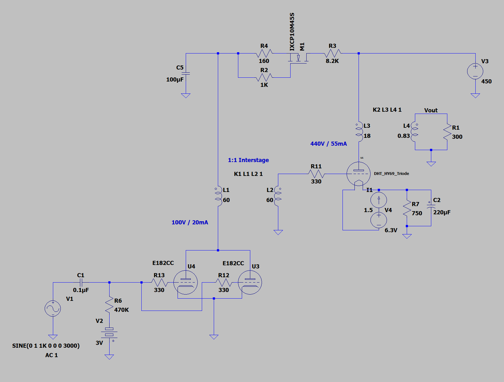

Gentlemen, I am going to throw in the towel and convert the output stage to a conventional common cathode stage. The output transformer is well suited to load the plate of the HY69 (6.5K primary relative to the HY69's plate resistance of ~1.8K). The additional gain of the HY69 (mu 6.5) will allow me to convert the input stage to a more stable tube, likely 5687 / E182CC with the sections paralleled, which I have used even recently in a very similar circuit successfully.
I will battery bias the 5687 / E182CC input stage with a 3V CR2 battery and ground the cathode, the end result will look like this.
I'm confident this will solve my problem, whether it be self oscillation in the input stage, or high frequency noise in the output stage due to a high impedance ground pathway for the filament. Thank you again for helping me troubleshoot, it's helped me come to this conclusion, which I think is the best path forward.
![HY69 Schematic.png HY69 Schematic.png](https://www.diyaudio.com/community/data/attachments/1166/1166066-2a864a0603754c2c992e3fa1d3972a3c.jpg)

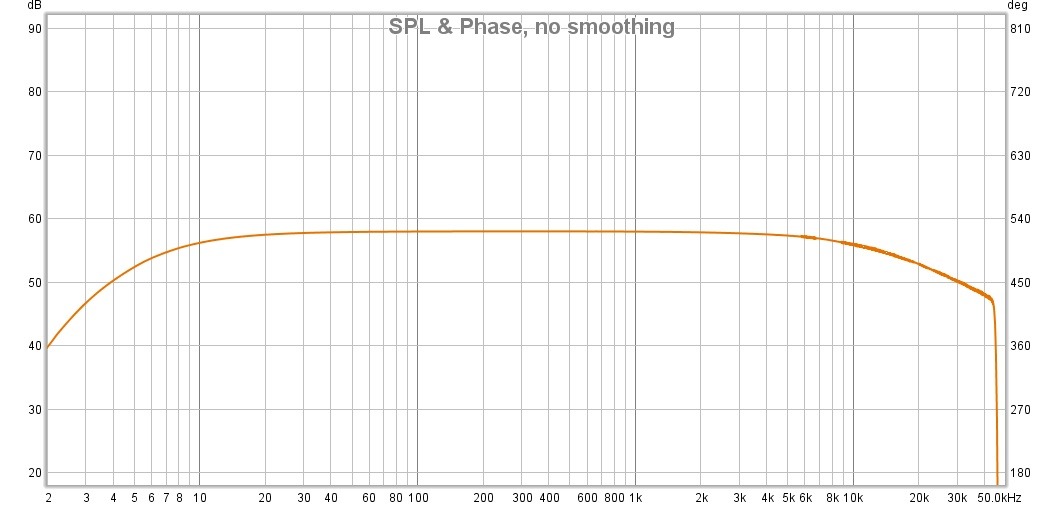

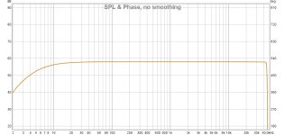

I took one more stab at the issue above and narrowed it down to the toroidal filament transformers. I substituted an EI core transformer with electrostatic screen instead of the toroidal and got a perfect FR without any high frequency noise. Problem is, these EI core transformers have so much leakage flux, the circuit is flooded with 60Hz noise, the reason I switched to toroidal in the first place.
FR using the EI core with signal input at the HY69 grid wired as a cathode follower.

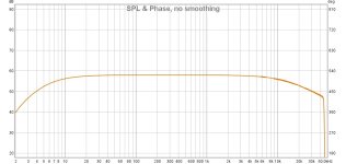

I went back to the toroidal, thinking perhaps maybe it is ringing and a better snubber might help. I used Mark Johnson's Quasimodo to dial in a perfect secondary snub, but alas the same noise persists.
FR back on toroidal with the snubber.
I've also tested the circuit in a common cathode configuration with the transformers in the anode and cathode bias rather than the cathode follower and this noise does not show up, it is only when wired as a cathode follower with the toroidal filament transformers.
These toroidals have primary-to-secondary electrostatic screening, overall the quality seems very high from Toroidy. Any thoughts on what it could be if it isn't coupled noise from mains? If the toroidals can't be salvaged set up as a cathode follower, I'll either have to go to EI and accept a 60Hz hum, go common cathode with the toroidals, or try a third round of filament transformers.

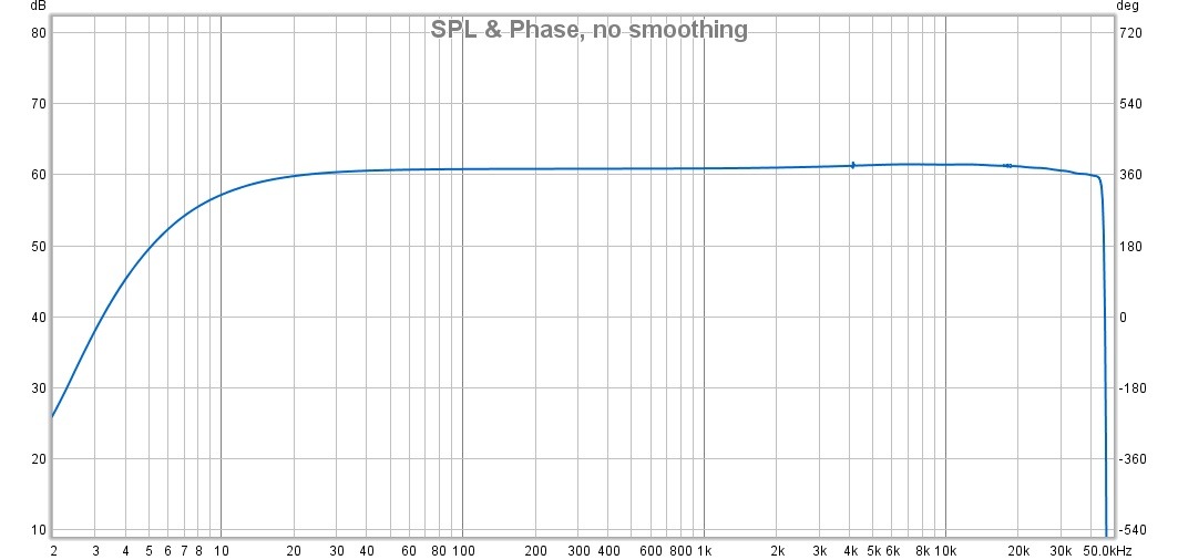

![EI Core FR.jpg EI Core FR.jpg](https://www.diyaudio.com/community/data/attachments/1170/1170238-4987e3f7315714e0db90f5acbc310c5b.jpg)
![Toroidal Core FR.jpg Toroidal Core FR.jpg](https://www.diyaudio.com/community/data/attachments/1170/1170239-8ad8cd89406990217ff772582e697e81.jpg)

Toroids have much better frequency response than they have a right to as mains trafos. If the noise is coming in off the line you may have to filter it on the primary side. Common mode choke, X-capacitors. You may have a rectifier ringing somewhere else that is getting through this transformer.
The problem with the EI solution appears to be pickup of stray field in a high-impedance cathode (plus high-Z grid circuit); and it's possible that the trouble with the Toroidy solution is similar.
The impedance of both grid and cathode rises with frequency (inductive); this may explain why only high frequency couples through from the Toroidy.
It is relatively easy to try countering the impedance rise with RC networks across them. It may be a matter of finding a balance between noise suppression and risk of FR limitation or sound degradation, but I suspect that low values of C will suffice, since the noise is coupling through low values of C.
It's possible that the HF noise couples from the Toroidy primary to grid or cathode wiring, so judicious foil shielding or shielded cable may help. The whole of the filament heater circuit is part of the cathode, so the coupling distance of all components of this must be considered.
The other possible method is to feed the Toroidy with a 1:1 mains transformer - an encapsulated type that lives outside of the enclosure. Now one side of the primary of the Toroidy can be connected directly to ground, and a cap placed across it. This should put an end to external HF noise.

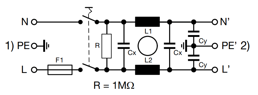

I do have a filtered IEC in place from Schurter, for what it's worth.
![Mains Filter.png Mains Filter.png](https://www.diyaudio.com/community/data/attachments/1170/1170363-ae5db6d5e6905eae008cf00debe5c87d.jpg)

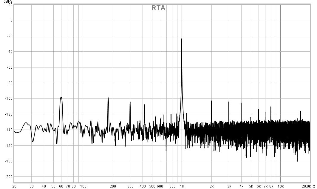

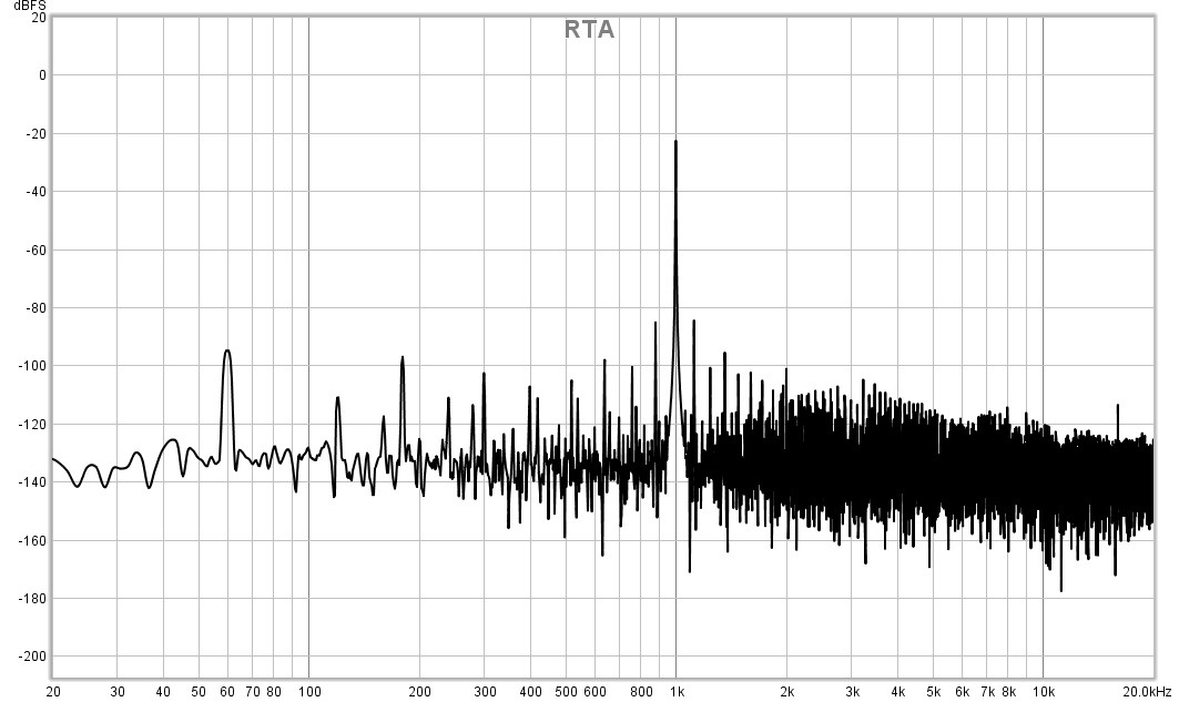

Here is a 1kHz spectrum of the output stage at about 1mW output into 300ohms. As you can see, very ugly noise floor and harmonics. With the EI core, it is clean and low distortion. Low frequency stuff is being picked up by my measurements, no hum in practice.

@6A3sUMMER thanks, it is an aluminum chassis. The 60Hz noise was due to magnetic coupling between the mains/filament and output / interstage transformers.
@Rod Coleman I tried your isolation transformer suggestion today with my MGE / Topaz transformer. Grounded one end of the toroidal primary, 1uF across the secondary. No difference unfortunately. Maybe this design just isn't viable with the cathode follower and toroidals given the high impedance path to ground. Works fine in common cathode series feed. Pains me to change it but perhaps it is the best option. Seeking out new filament transformer I might just find myself in the same predicament - LF noise with non toroidals, or HF noise with toroidals.
Here is the EI core spectrum for comparison.
