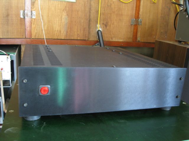

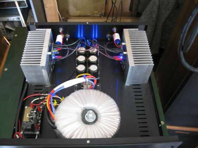

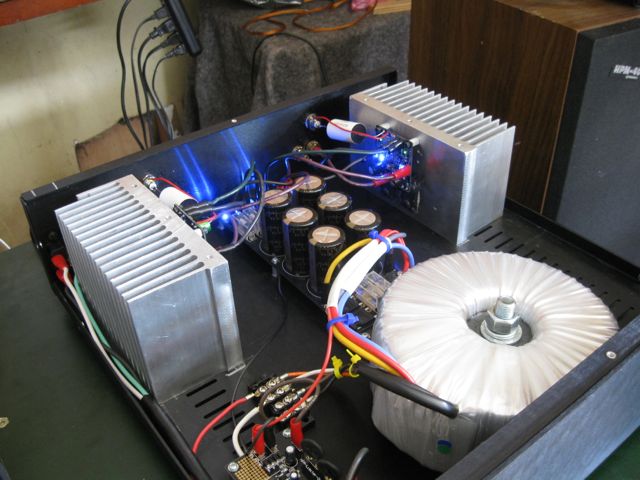

I did blow my 200 boards on my Infinity RS2B, they are wery hard to drive with impedance around 2 ohm. So it vas time to uppgrade.
I started making my own chassis.
First version.
Nxv-300.
630VA 2x33volt.
30 pc Philips 2200 uF 63 volt.
Second version.
Nxv-500
800VA 2x50 volt.
12 pc Elna 10000 uF 80 volt.
Third version.
Nxv-500 R2.
1000 VA 2x 55 volt.
42pc Roe 2200 uF 100 volt.
First version.
Nxv-300.
630VA 2x33volt.
Second version.
Nxv-500
800VA 2x50 volt.
Third version.
Nxv-500 R2.
1000 VA 2x 55 volt.
First version vith nxv-300.
