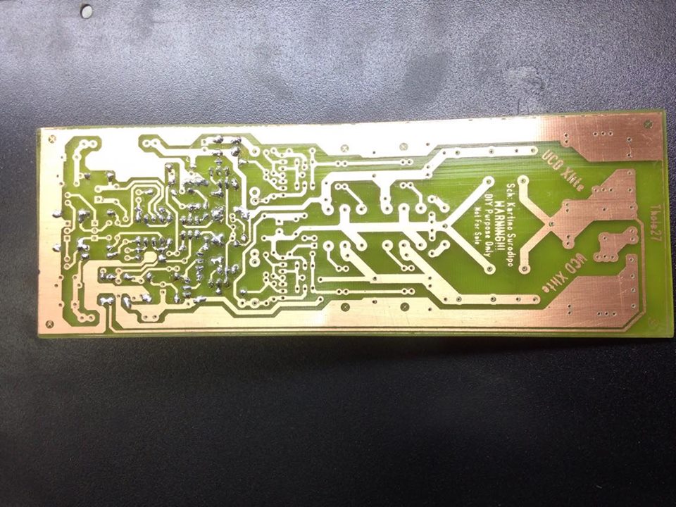

Kartino work in progress😉
udc xlite
Good afternoon Kartino, my name is jonas, I'm trying to mount the amplifier "ucd-xlite v.2 final". But I'm just burning components, I have several schematics here I tried to mount the "ucd xilina" among others but I'm not having success, I would like your help if I can send the pcb pci design, I can pay for it if that's the case .... My name is Jonas, I'm from Brazil.-

Bridge is not yet tested by myself, but someone said he has test it successfully.
And what component should change to make the pwm go to the 300khz, and another thing when the power increases the pwm falls, ie it fails, as if it were missing current, amps in the sector of 12v, and what maximum power that I can extract from this amplifier .
Seems it is poor quality of parts
Like Master Bruno Putzeys said: No tricks but good parts. In Class D this is the rule.

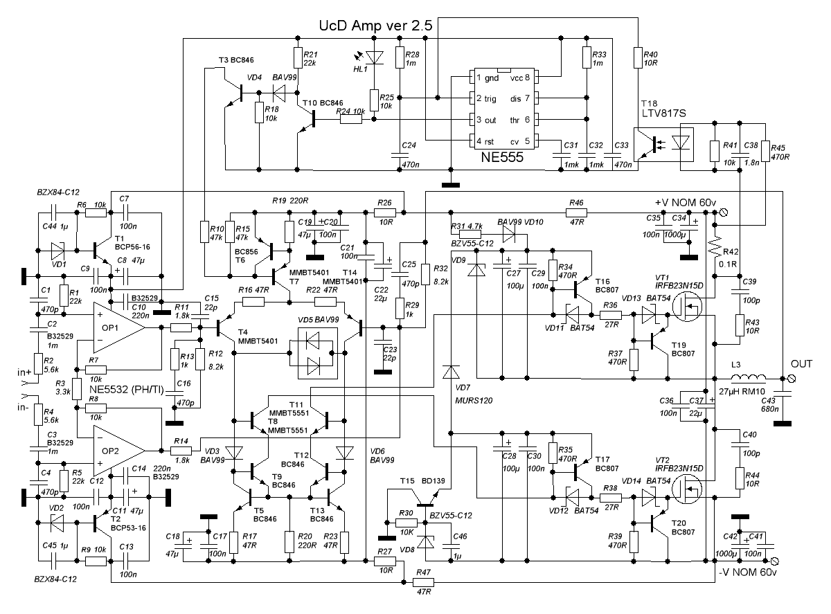

hi katrino i had made this amp , the version of classd from ru the amp was nice and clear the only disadvantage is that i never had good fets i used irf540 for low power and irfp250 for hi power. when i used hi voltage like +/-70vlts the amp failed i suspect it was the fets but now that i have irfb4227 and many smd parts e.g mmbt5401/5551 mmbt 4403/3903 i will revist the project.
by the way how many voltage are you using with your discreet version? also your load and output fets that you have used?
