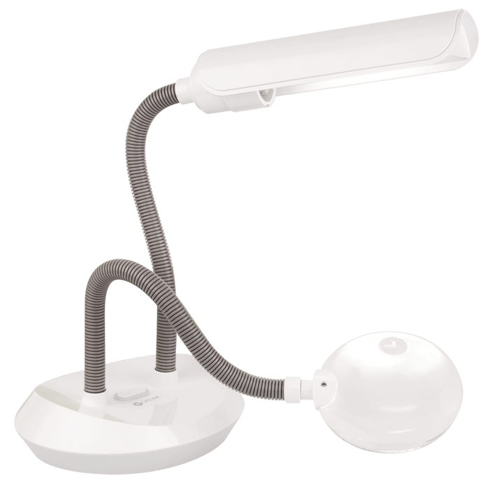

Love mine, great for the aging eyes when trying to solder circuit boards.
I have not found magnification over 10X being useful for that type of application, even a 3X is a huge improvement.
Go above 10X and it is difficult to synchronize your small hand movements against what your eyes see through that massive lens.
The LED lighting is effective. Mine has something like 6 steps, which just switches on more of the string. USB driven.

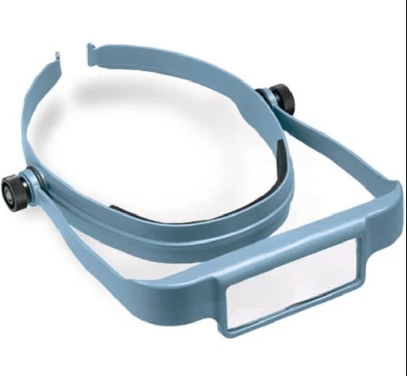

I've tried several ones but was never happy with them. In the end I started using the OptiVISOR's and absolutely love them. You can get them in a wide range of powers and they have clip on lights available. Best of all (for me) is that I retain stereo vision and depth perception with them. Just make sure you get the genuine ones made by Donegan and not knock-offs.

I've been using an Optivisor for a few years now, and it has changed my life. I like the ability to aim my bench lights where I need them, independent of where my eyes are positioned. Certain operations are best when the light is from the side(s). Highly recommended, and it works great with my prescription glasses. Just flip up the Optivisor to resume normal vision.

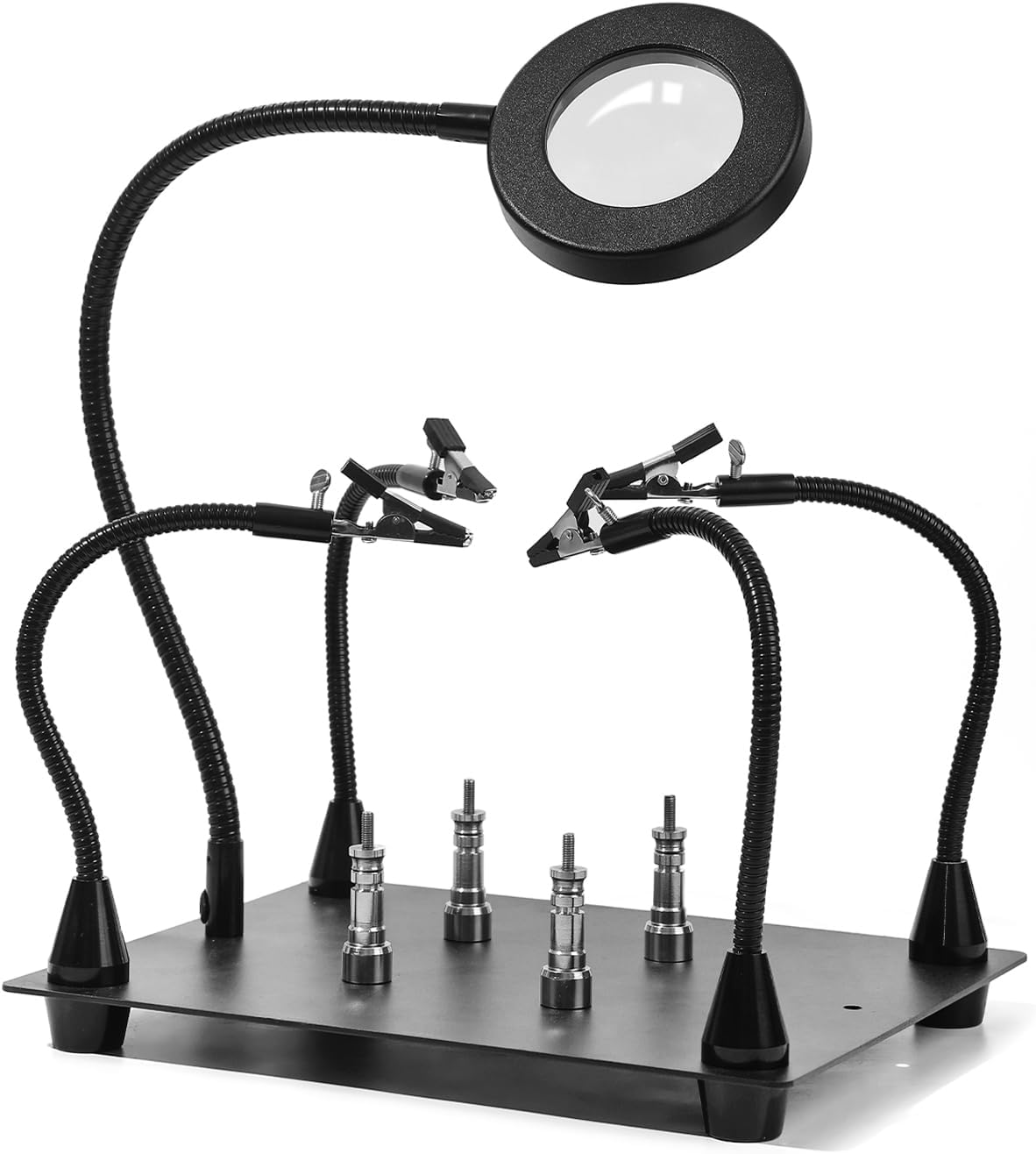

This is what I use

I have the Donegan Optivisor with the mag loupe option. With Opivisor you can get different magnification options. I have three different lenses but generally stick to the DA-3 (1.75X) lens most of the time. Keep in mind, that when you go up in magnification you will decrease the focal length.

I'll fourth the Optivisor. I wasted a lot of money buying a magnifying lamp and fitting it to my bench. It has a circular fluorescent tube with a decent CRI (Colour Rendering Index) but it's too awkward to use (and it gets in the way when not being used). The Optivisor (DA3) is way better. LED lamps have much poorer CRI, but that doesn't seem to bother me for detailed lighting. For general lighting, you do want a high CRI (90) to be able to read resistor colour codes. Microscopes want a ring light fitting to them and LEDs are fine there.
