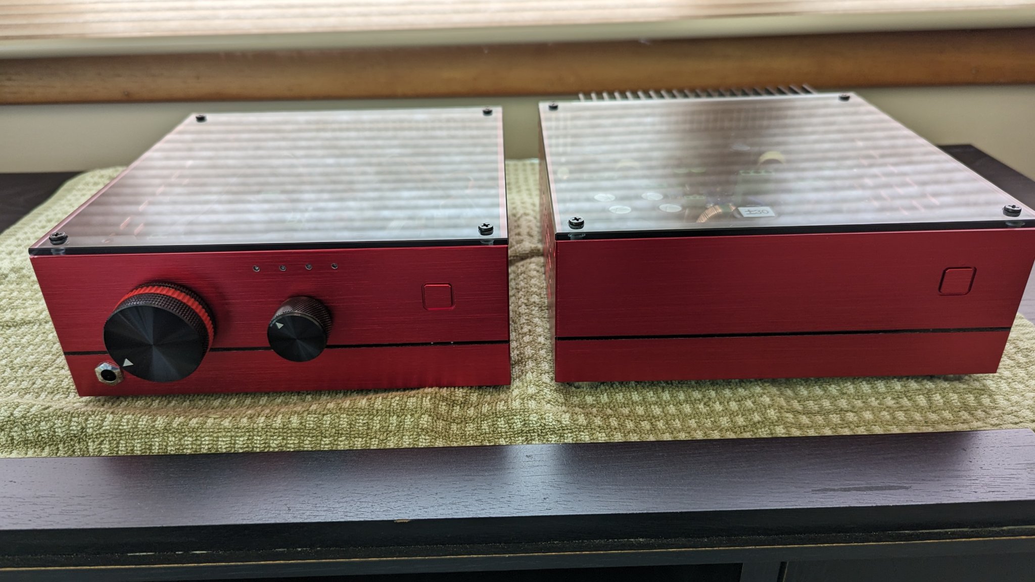

My latest preamp/switcher project and build. This pre offers all the normal functions you'd expect in a pre, along with a couple selectable features. The design and layout of the board was done by fellow DIY'er, jhofland. It is based on the excellent OPA1656 chip, and other support ICs along with a few TH parts, and external breakout boards for volume, selector and headphone. The PCB is double sided and turned out beautifully. It has a fully, self-contained and integrated PSU. No power brick required.
This project had it's roots in my desire to have a matching preamp, to mate with a recently completed Modulus- 86 amp build.
Latest Preamp and Modulus-86 amp.

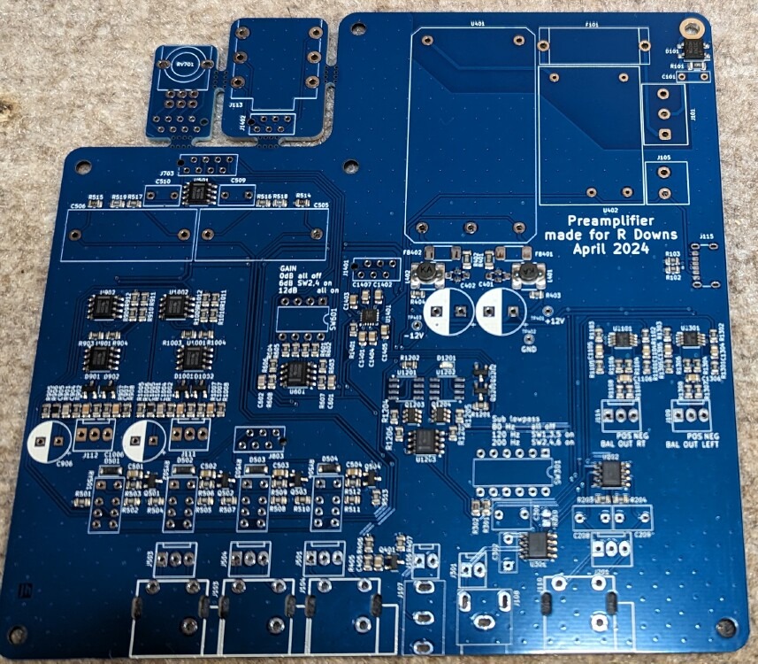

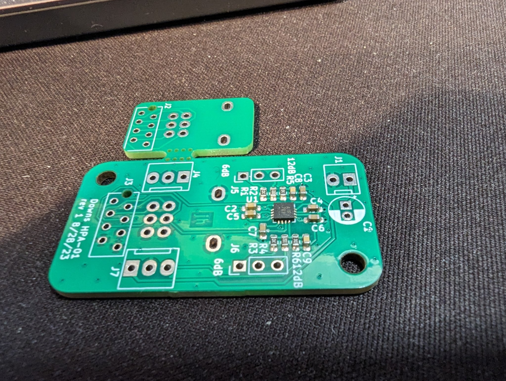

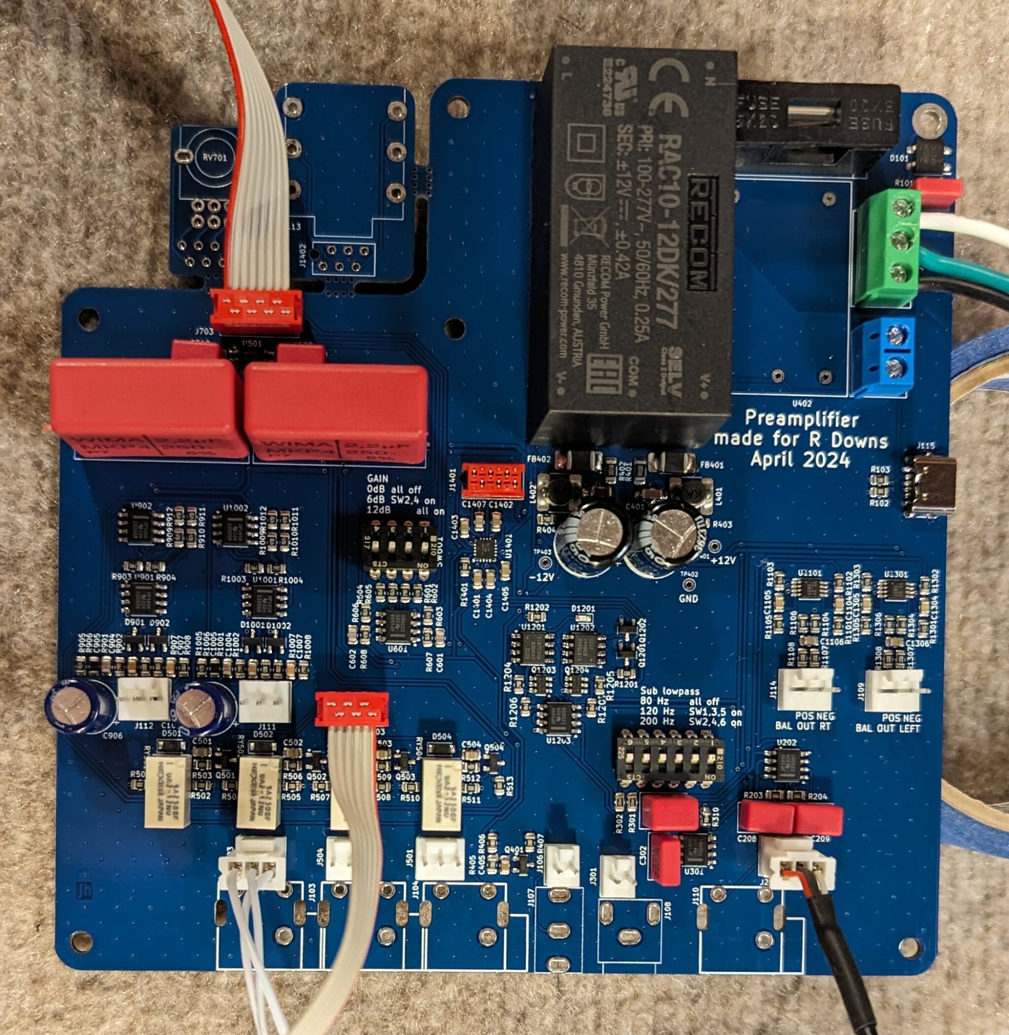

As mentioned before, the guts of the pre is a double-sided preamp PCB. The design specs feature;
o - Based on TI's OAP1656 opamp chip.
o - Uses TI's OAP1637 fully differential chip.
o - Uses Analog Devices' MAX79220 headphone amplifier.
o - 1 balanced input
o - 3 single ended inputs
o - 1 balanced output
o - 1 singled ended output
o - 1 separate headphone amp
o - 1 subwoofer output w/selectable crossover at, 80, 120, or 200Hz
o - 1 12V Trigger out jack (3.5mm)
o - adjustable gain at 0dB, 6dB, or 12dB (onboard 4-pin DIP)
Other features include;

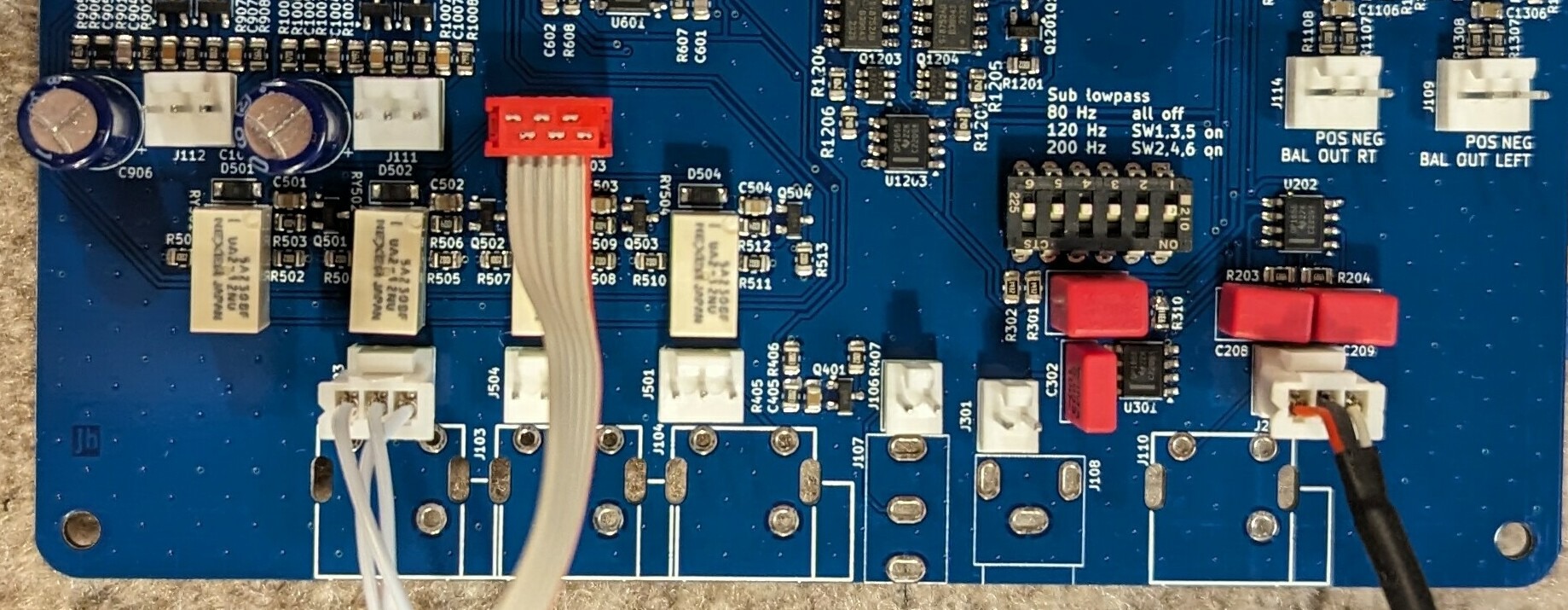

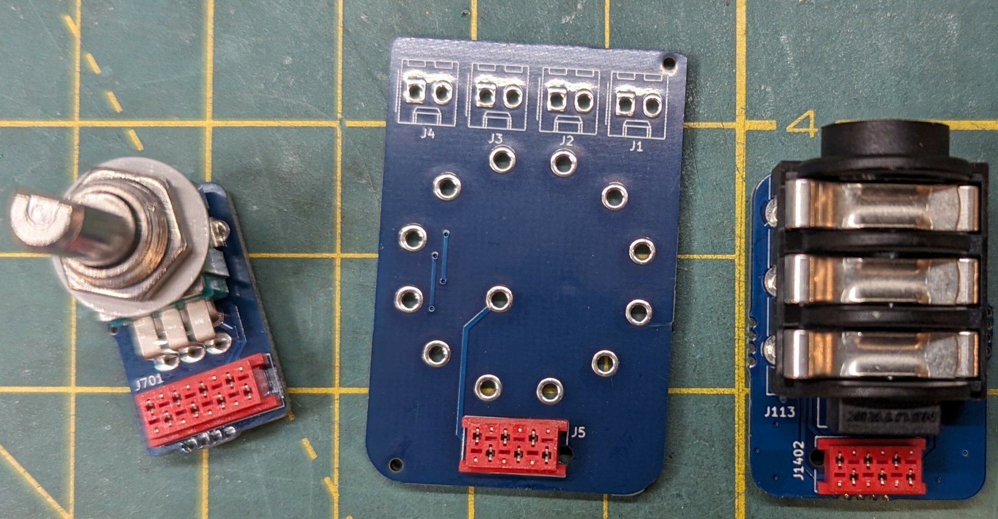

o - Use of small breakout boards for the;
(1) the volume control pot
(2) the input selector with LED KK connectors
(3) Headphone output jack
Micro-match connectors are used for connection from the main board to the above remote breakout PCBs.
o - All I/O is also available with the use of MolexKK 2 and 3 pin PCB headers.
o - All onboard and integrated PSUs. No power brick to contend with.
o - Integrated IEC connector on read panel.

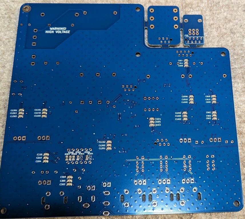

Top/Bottom view of the PCBs;
Here is what the fully populated board looks like, sans the 5V power module.

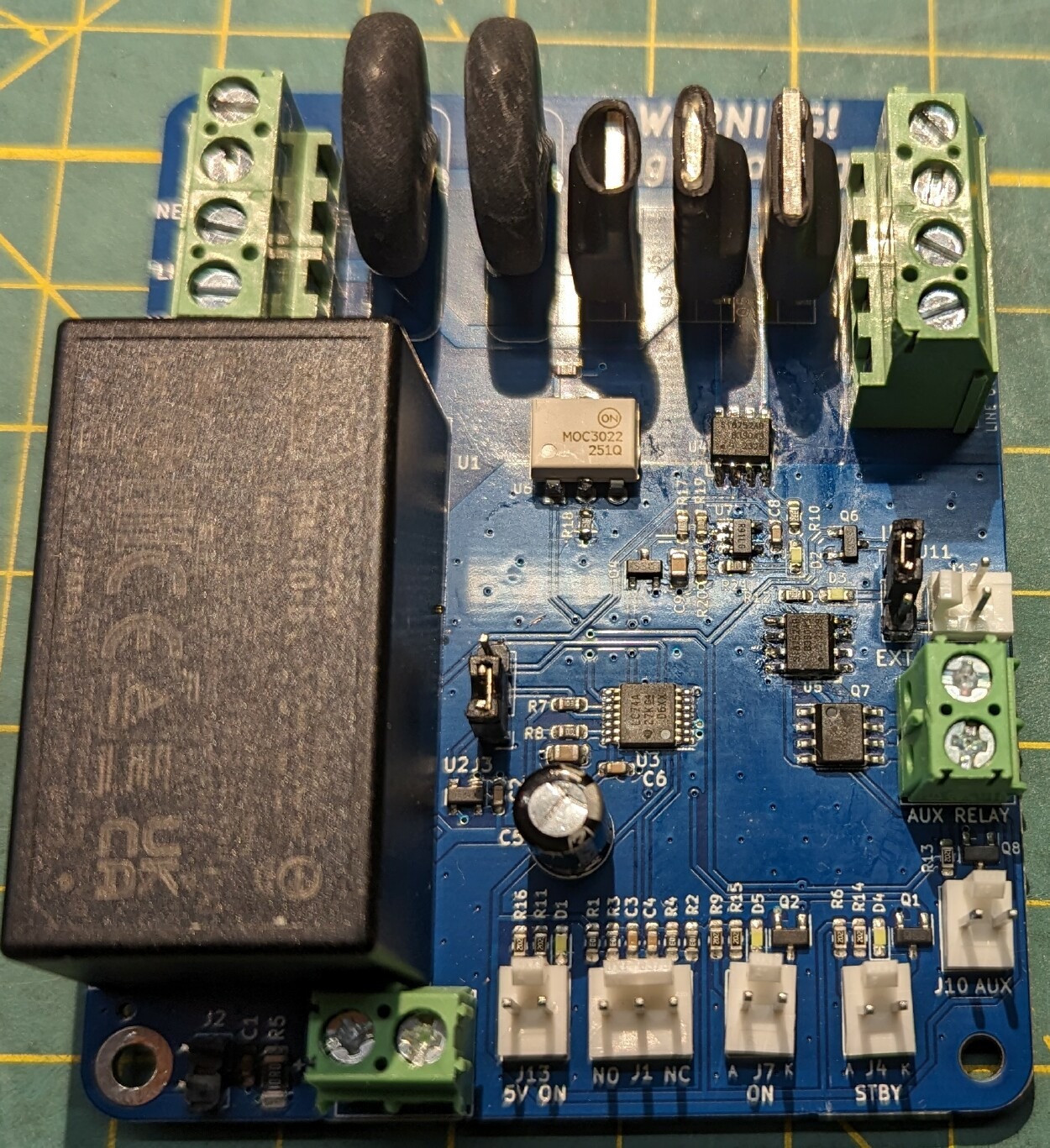

Another feature I like to have, and is on all late model PC cases - for about the past 20yrs - is the momentary on/off switch on the front or top of cases. To take advantage of such a switch you need some sort of low-voltage switch to trigger the mains, or simply act as an inline switch to a PSU. In past projects, I've used a small softstart switch (also designed by jhofland), that is ideal for a MO switch to turn on new builds. It provides for using a single switch, and even the Power and HDD LEDs also on the front panel of mini-ITX cases. I use these in almost all my projects over the past couple of years.
Remote low-voltage softswitch.

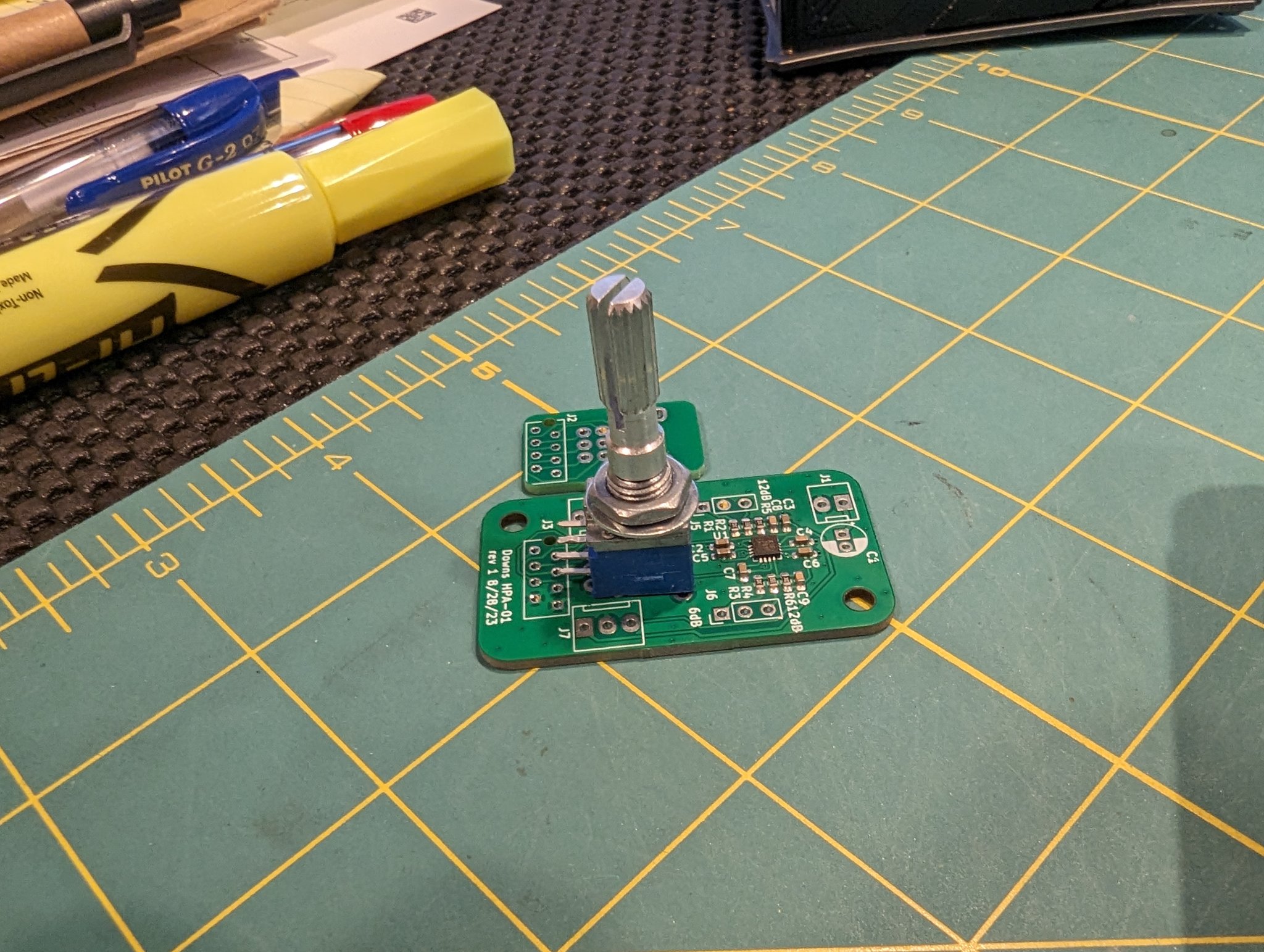

Also designed into this preamp are the breakout boards for the 3 operational features like; (1) Input selector, (2) volume control, and (3) headphone jack. Putting them on breakout PCBs allow for different mounting/placement options. The Micromatch (TE Connectivity) connectors and cables are used to connect them to the main preamp board.

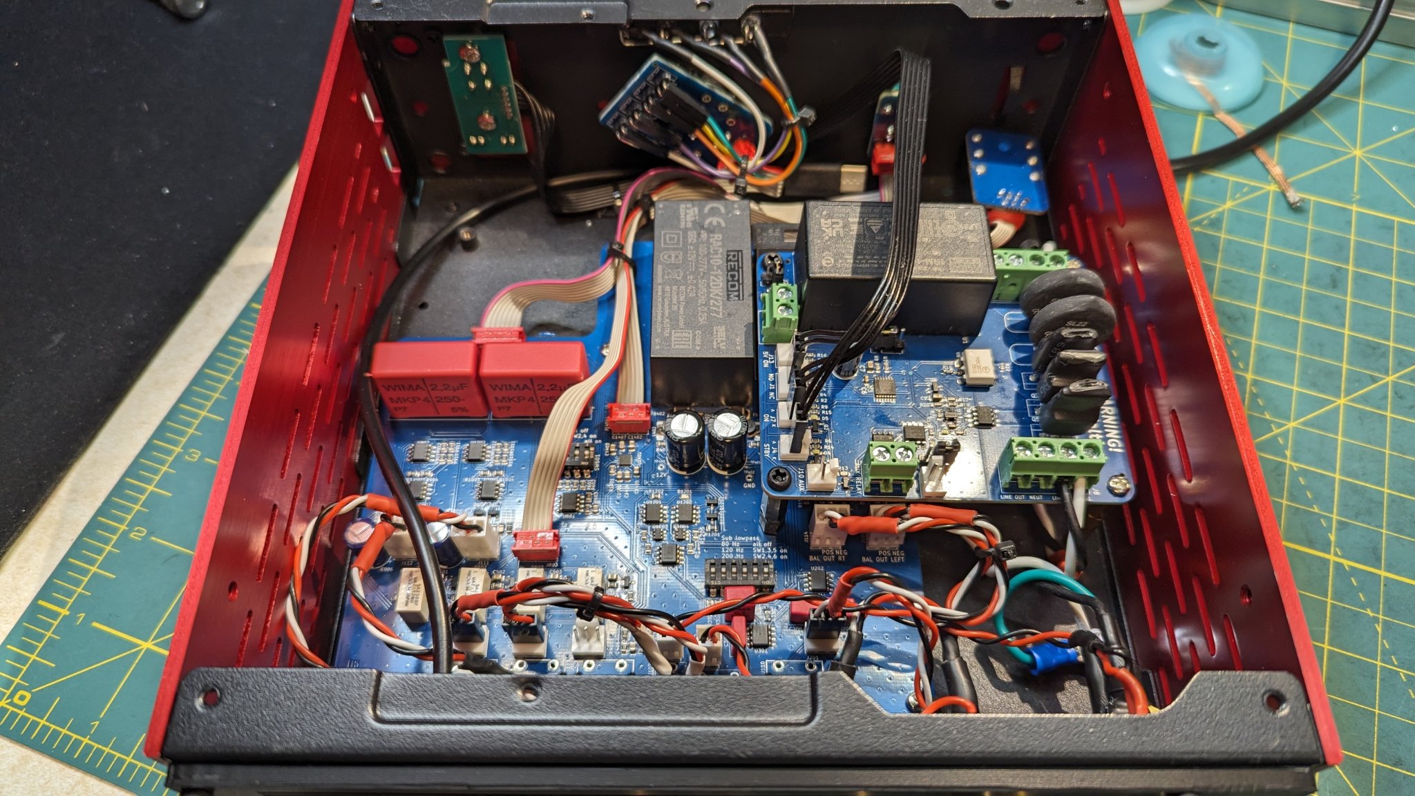

Here are a few images of my build in process.

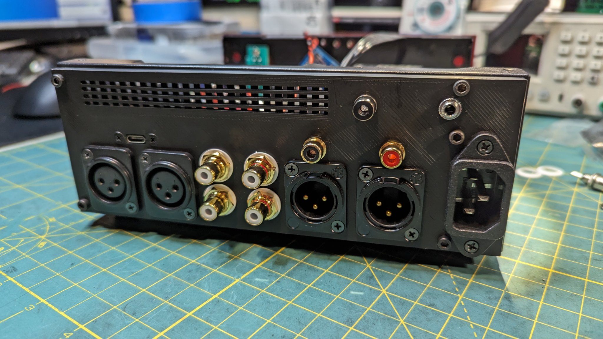

Final layout of the Back Panel. (4MM thick 3D printed)
Fully wired up preamp.

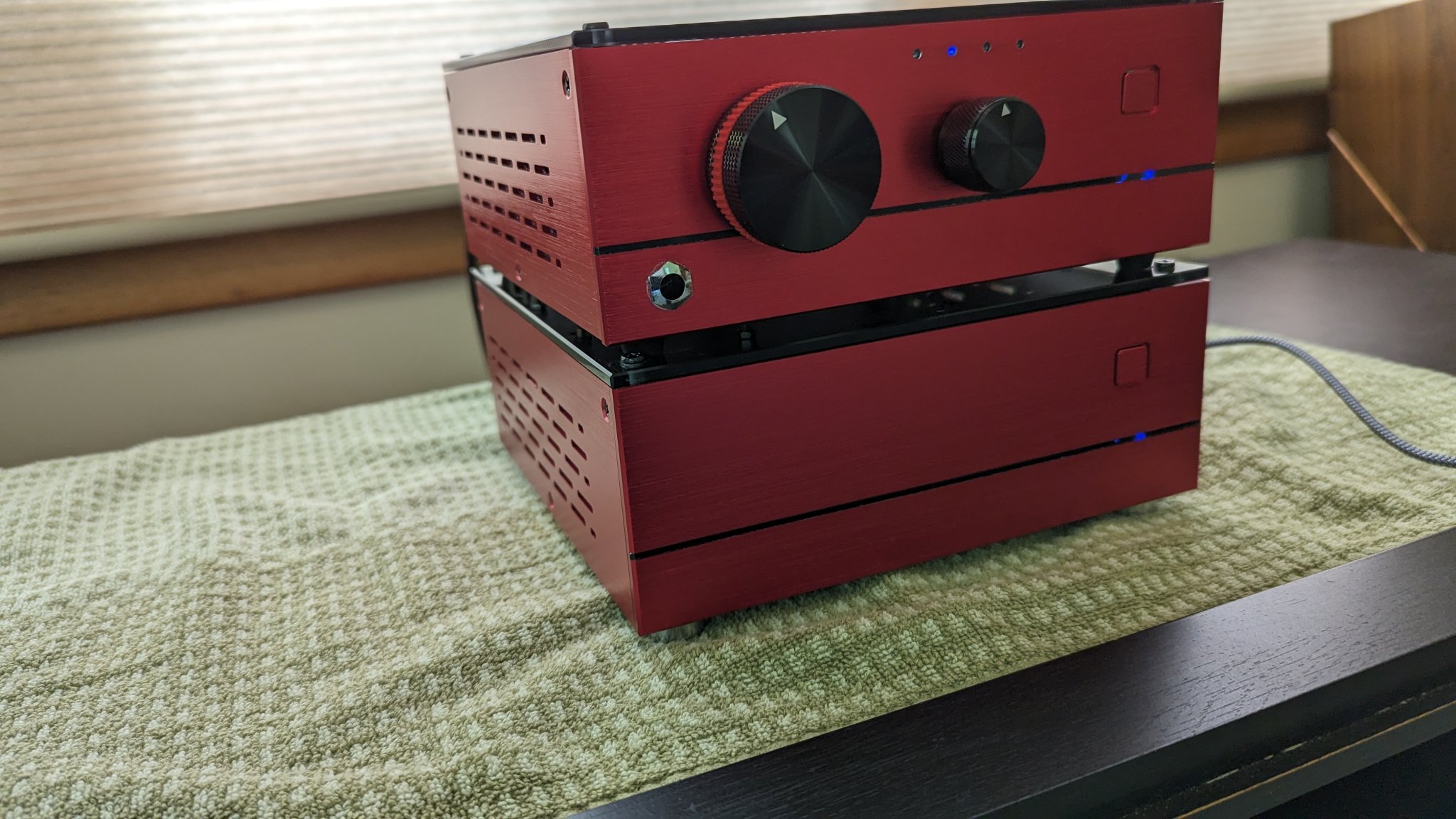

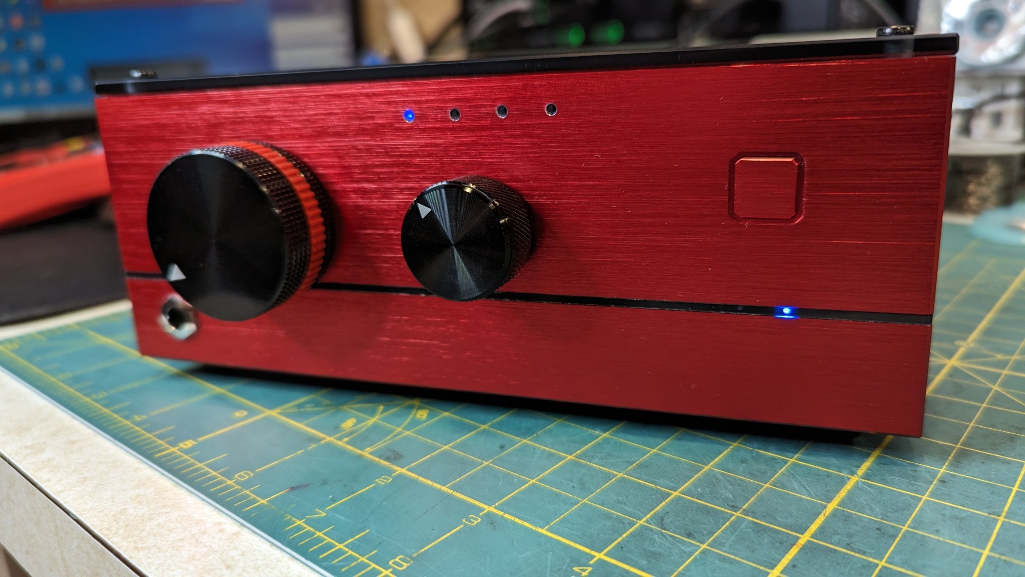

Fully finished and closed up preamp with smoked glass top.
The dynamic duo.

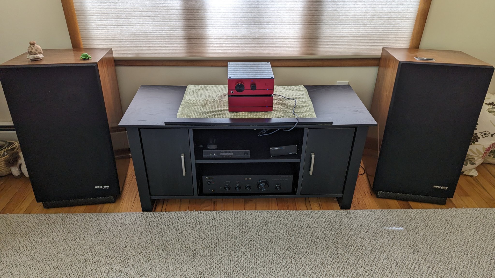

Temporary living room testing setup with vintage, HP-100 4-way speakers. The combo sounds so awesome, and the dynamics are really something you've got to hear.

The two of them has turned into a labor of love. The Mod-86 was finished first, but then there was a critical issue discovered with my latest version of the remote-start, that neither Jan or myself could find at first. Jan ultimately found the wrong value resistor that had been loaded/placed wrong by JLCPCB. This is the second time JLCPCB has loaded a wrong part resulting in a no-worky situation. It was easily fixed and the AC switching side was working fine.WOW WOW WOW!!
Fantastic job on your preamp Rick! A lot of planning, trimming and drilling went into the chassis. You and jhofland created a potent little red preamp.

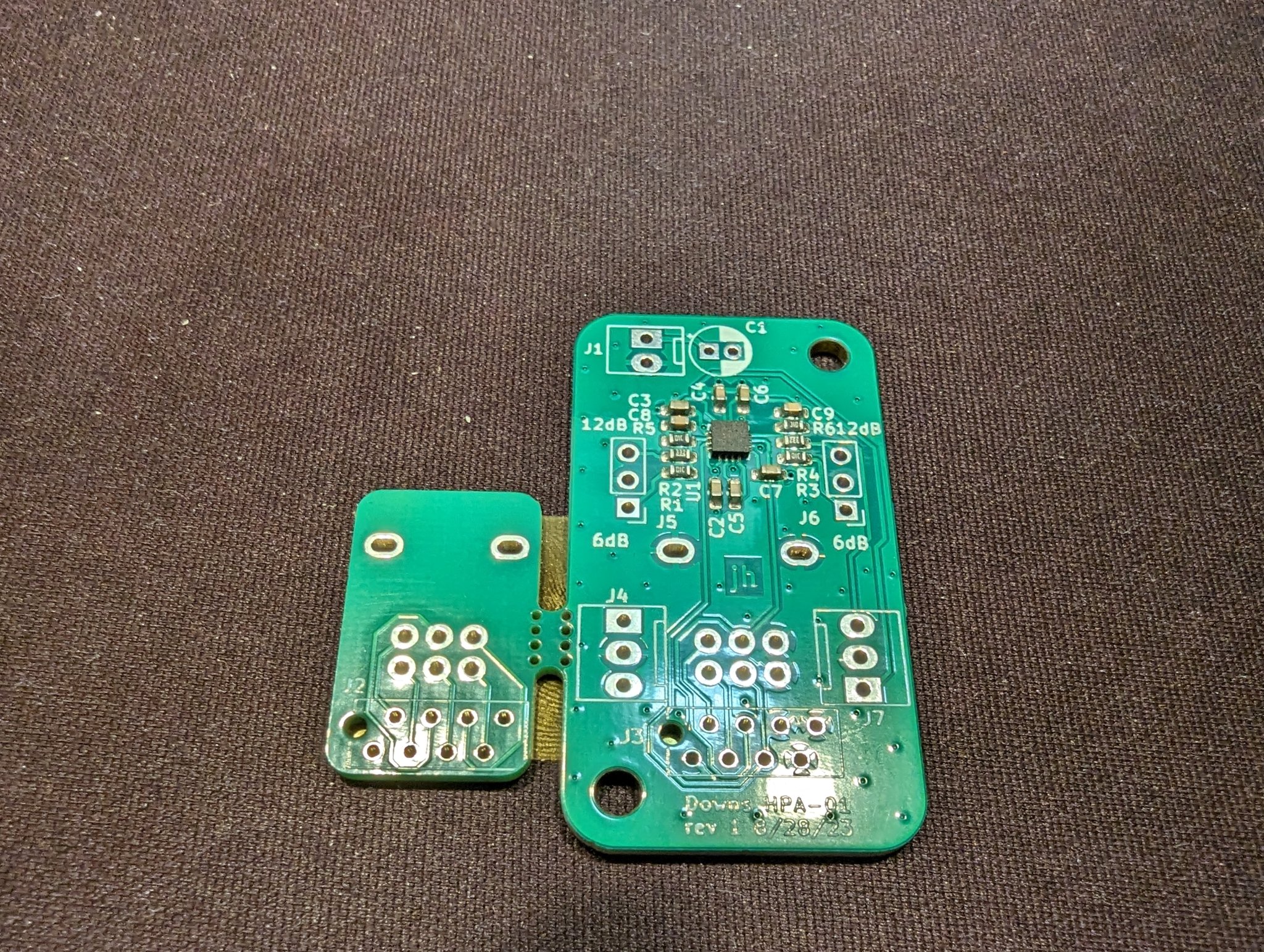

Admirable work, OP. The usage of idc connectors is a genius idea and something i too wanna try after seeing this.
Not only is it convenient it also opens the path for future upgrades because if you wanna try a better volume pot you can just make a pcb for that pot and swap out the old one- no need to tear down the whole machine or desolder anything. Ive been doing that with my old preamp but never thought to bring those connectors into the mix. (Been using molex but the wire stripping ect is a pain)
Also, can i also ask you what volume pot that is in the picture and if you find it lacking in any way? The cheapest pots always suffer from channel imbalance and i wonder if you found one that avoids the issue
The little Micromatch (MM Datasheet) are very versatile - especially on small PCBs. And, ribbon cable can be easily affixed to the connectors simply by using pliers. And in my experience, they seem to be very robust. The little volume control pot is an ALPS (RK09L12D0A1T). It's a 10k Audio pot and is very smooth in operation. I've never experienced any channel imbalance using these pots in various projects.

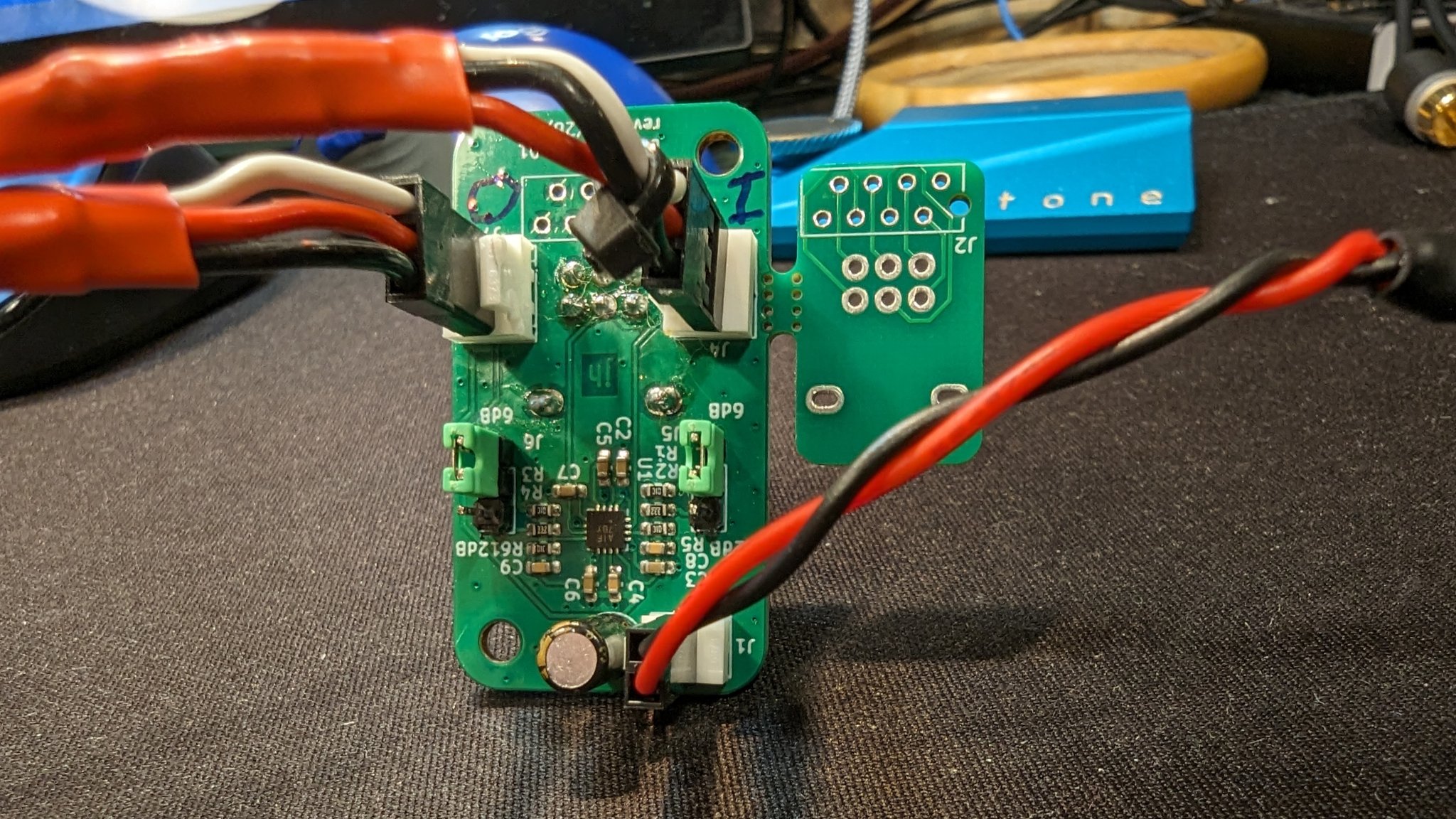

Speaking of volume pots.... Below is a little headphone amp that you can connect to any line level project. It uses the same pot as the preamp. It's both unique and versatile, because the amp was designed around the VC pot, and can be mounted directly on the front panel, or remotely using the little breakout board with Micromatch connectors and ribbon cable. See images below. I have a few of these, professionally fabbed up PCBs with all SMDs. All you need to add are the through-hole parts.(mostly KK connectors and 1 electrolytic cap) It uses the same excellent Analog Devices/Maxim (MAX97220) headphone amp part used in the preamp. PM me if interested in this board.
Rick

That is a great-looking preamp/power amp stack! I love the chassis and how you were able to customize an existing chassis to fit your needs. Nicely done.
The local (to me) assembly house that I use uses multiple levels of automated optical inspection (AOI). Each component part number has an image associated with it and it is verified through AOI that the correct parts are populated in the correct spots before the board even goes through reflow. It's verified again and the solder joints inspected by AOI before the board is packaged up. But then I also pay more than I would at JLCPCB.
If JLCPCB can't figure out how to assemble boards correctly, there are other outfits out there who can.
Tom
Wow. That speaks volumes to the lack of controls at JLCPCB. Having to replace one resistor is annoying. Imagine ordering 250 boards and having to replace a resistor on each of them and then repackage the boards. That would quickly eat up any savings gained by going with a cheap outfit.Jan ultimately found the wrong value resistor that had been loaded/placed wrong by JLCPCB. This is the second time JLCPCB has loaded a wrong part resulting in a no-worky situation.
Tom
Thanks for commenting. I would have opted to do balanced input on the Modulus-86, but simply could not fit everything in such a small chassis. I'm not sure how much 'fidelity' I'm missing by not doing so. The Modulus-86 is a very transparent sounding amp, with lots of dynamics and clarity. And even with a decision to go with a lower voltage PSU, and hence lower output wattage, there's seems to be plenty of headroom for my particular listening needs. It seems to pair well with my vintage HPM-100. I guess I'm a taking a risk w/o speaker protection too.That is a great-looking preamp/power amp stack! I love the chassis and how you were able to customize an existing chassis to fit your needs. Nicely done.
Tom
Another downside with using JLC for anything, but the simplest of circuits is, they often either don't stock certain active parts(even some passive ones), or don't have enough on hand. So, in the past I've had to get the boards finished with what they do have on hand, and then leave the unavailable parts off the finished PCBs. Then I get to hand solder a couple ICs myself. Now that would be unbearable if I had to process 250 boards! With my low volume it's not a problem. I guess with their commercial customers, the designers likely use the parts JLC stocks and spec accordingly - where they can.
Rick
