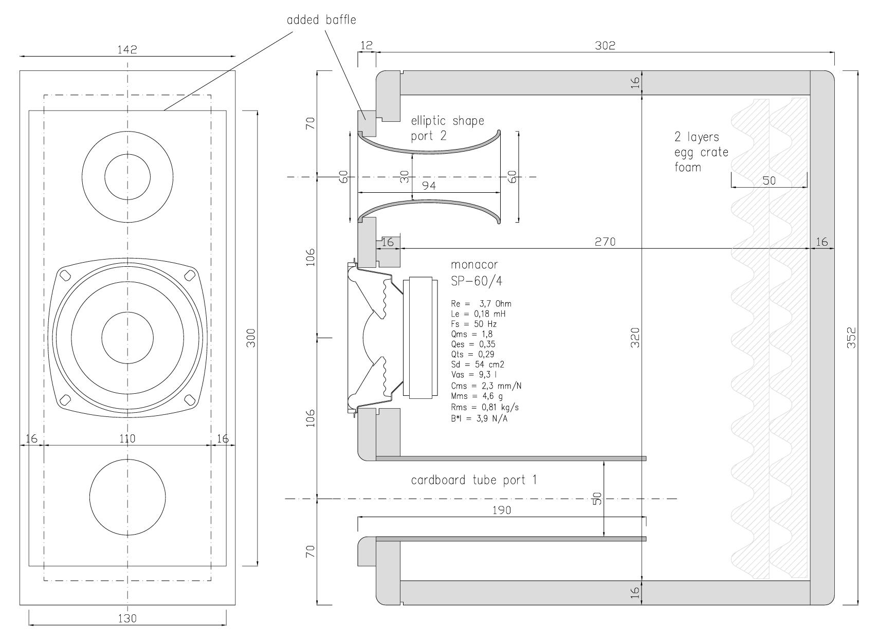

attached a plan showing the exact loudspeaker setup for the last test. dimensions are all in mm.Can you please provide the cabinet dimensions, dimensions of the cylindrical port, location of port on baffle, wall and baffle thickness and a link to the driver for a rough simulation?
the TSP come from hobby hifi (german magazine) and seem to be quite accurate.
![240220-port-test_loudsp.png 240220-port-test_loudsp.png](https://www.diyaudio.com/community/data/attachments/1183/1183891-af61ad486ece6c408403a5ae0f1269fa.jpg)
the added elliptic wall port is installed where the former tweeter was.
the 50 mm interior diameter cardboard port has a wall thickness of about 3 mm.
the 3d printed elliptic wall port was 3d printed with PLA, thickness 2 mm. the relevant interior shape follows a rotated half-ellipse, long axis 94 mm, short axis 30 mm, thus opening diameter 60 mm, central diameter 30 mm.
one of the ports was each stuffed airtightly for measurement.
(further documentation sent to you via personal message!)

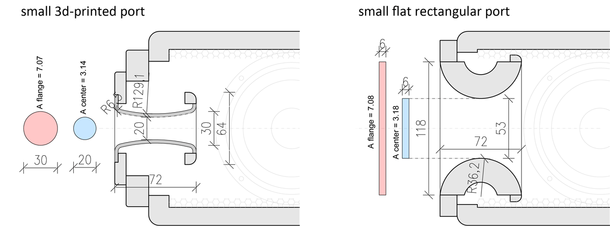

I took the small 3d printed port for chamber 1 and replicated the flange and center cross section surfaces, but with a very thin rectangular shape (6 mm):
![240222-smallports_plan.png 240222-smallports_plan.png](https://www.diyaudio.com/community/data/attachments/1184/1184581-753c28252be56f41051e7f9a5e08a706.jpg)
![240222-smallports.jpg 240222-smallports.jpg](https://www.diyaudio.com/community/data/attachments/1184/1184588-25c45d56f9cbf9abe682fa57416ac1d9.jpg)

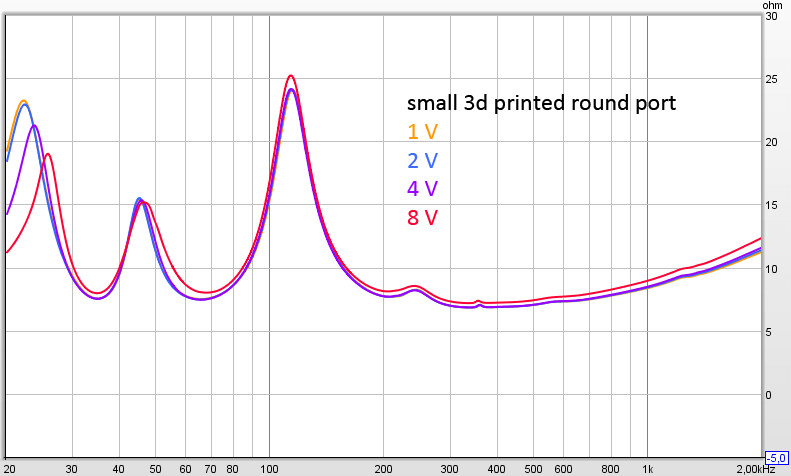

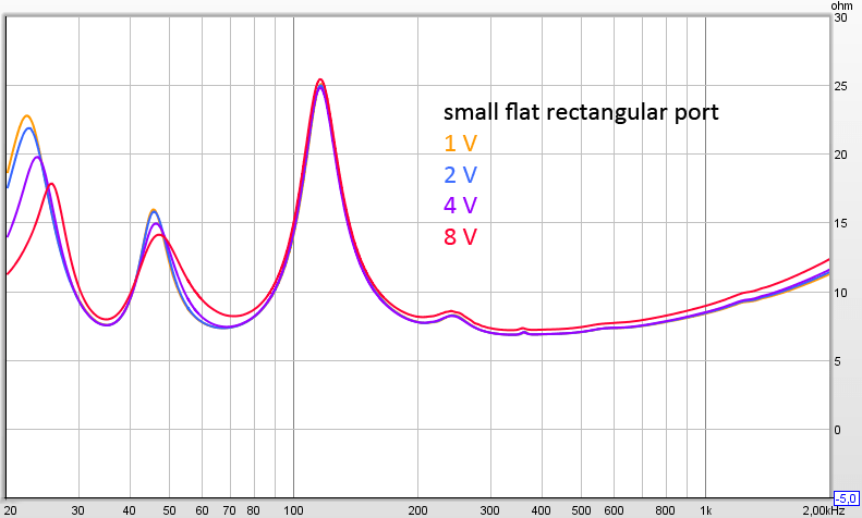

the impedance measurements for different amp output voltages (I should add, this is the amp output which will be reduced by the 8 ohm impedance measurement resistor!)
small round 3d printed port:
![240222_mini3d_imp.png 240222_mini3d_imp.png](https://www.diyaudio.com/community/data/attachments/1184/1184582-1b4d645e8fdd39c55dd4f3e64c241558.jpg)
and the small flat port:
![240222_miniflat_imp.png 240222_miniflat_imp.png](https://www.diyaudio.com/community/data/attachments/1184/1184583-e257ebb1654e86546e5af4fac22d44ab.jpg)
there is a slight difference for the 4 V and 8 V middle peak and upper valley. the flat port seems to restrict the airfllow slightly more.
furthermore there might be a slight tuning difference between the ports (upper peak!).
at low levels the ports seem to behave quite similar, despite the very different flow surfaces. the boundary layer effect doesn't seem to have a huge influence.
please disregard the lowest 25 Hz peak. this refers to the chamber 2, which did not change.
however, as I noticed before: the small chamber 1 ports restricts the airflow below resonance for high levels and thus lowers the lowest impedance peak.

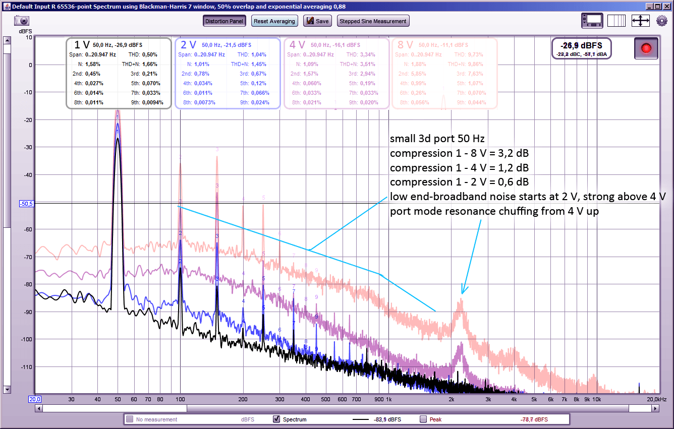

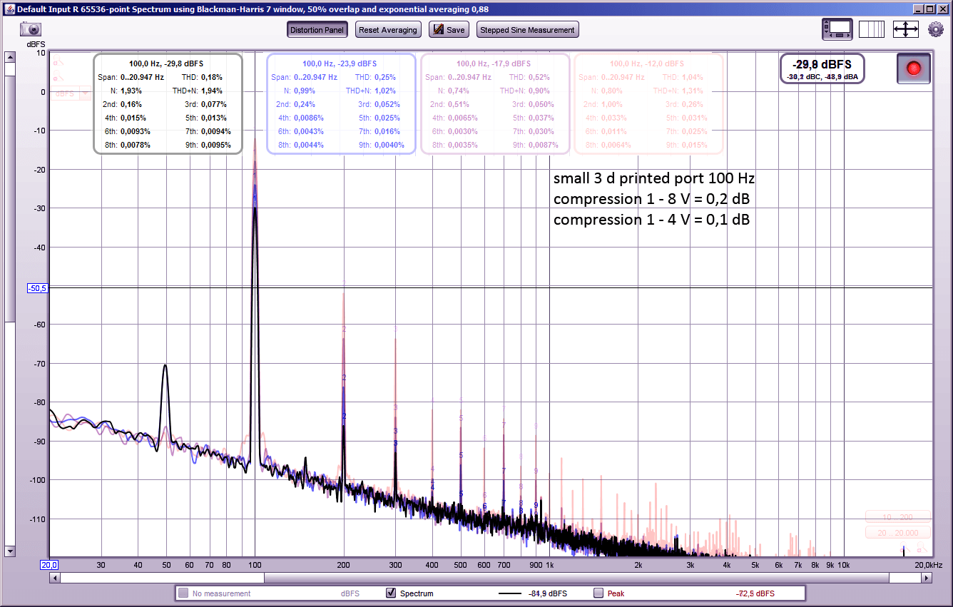

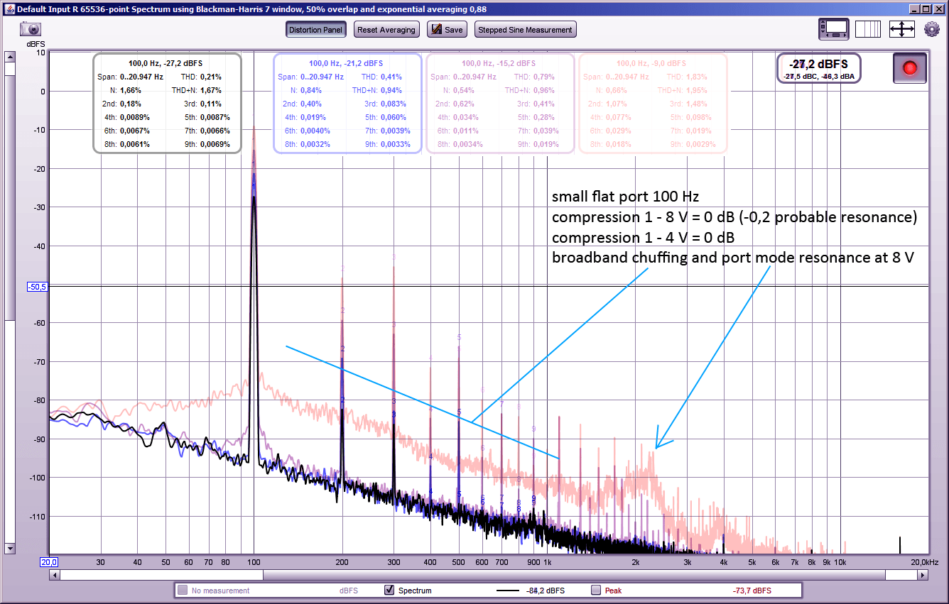

now, to check for the turbulent airflow tendency, the chuffing-RTA-spectrum graphs, for 100 Hz and 50 Hz each:
100 Hz small round 3d printed port:

100 Hz small flat port:
![240221-miniflat_100Hz.png 240221-miniflat_100Hz.png](https://www.diyaudio.com/community/data/attachments/1184/1184587-4ed0f4a829b69ae808834db538e9ad03.jpg)
50 Hz small round 3d printed port:
![240221-mini3d_50Hz.png 240221-mini3d_50Hz.png](https://www.diyaudio.com/community/data/attachments/1184/1184584-f2b456cc3c9222f73c520eaa448687ea.jpg)

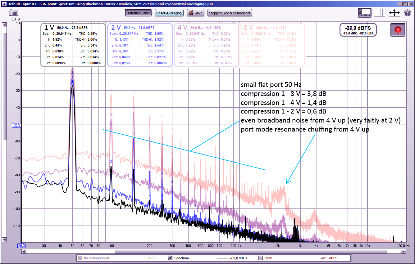

50 Hz small flat port:
![240221-miniflat_50Hz.png 240221-miniflat_50Hz.png](https://www.diyaudio.com/community/data/attachments/1184/1184586-65153b6ff381fe75700b76f205938541.jpg)
with 100 Hz the round 3d printed port behaves very well (strouhal number high due to higher frequency).
the flat port has turbulent airflow at 8 V, resulting in broadband noise and port mode resonance chuffing.
I suspect the loss of port Q with higher levels (see impedance curves) is mainly due to the turbulent airflow.
still, both ports do not compress noticably.
at 50 Hz the strouhal number is reduced and turbulent airflow can be seen for both ports.
the flat port behaves slightly better regarding noise but worse at H3 distorsion.
keep in mind: with these noise levels the ports are not really usable for serious music reproduction at levels above 1-2 V, if tuned around 50 Hz.
compression is very similar for both ports.
port resonance chuffing noise is less pronounced for the flat port (as b_force mentioned above!)
my conclusion:
the issue with both small ports is the turbulent airflow at high air displacement distances.
in relation to that the boundary layer effect does not seem to affect oscillating air very much.
also refer to @andy19191 's explanation of boundary layer thickness in post #302 and my comparison of bigger 3d printed and similar flat ports in posts #157, #165, and #222!

Worst of all, it moves upwards.
The impedance of the rounded port stays much more even.

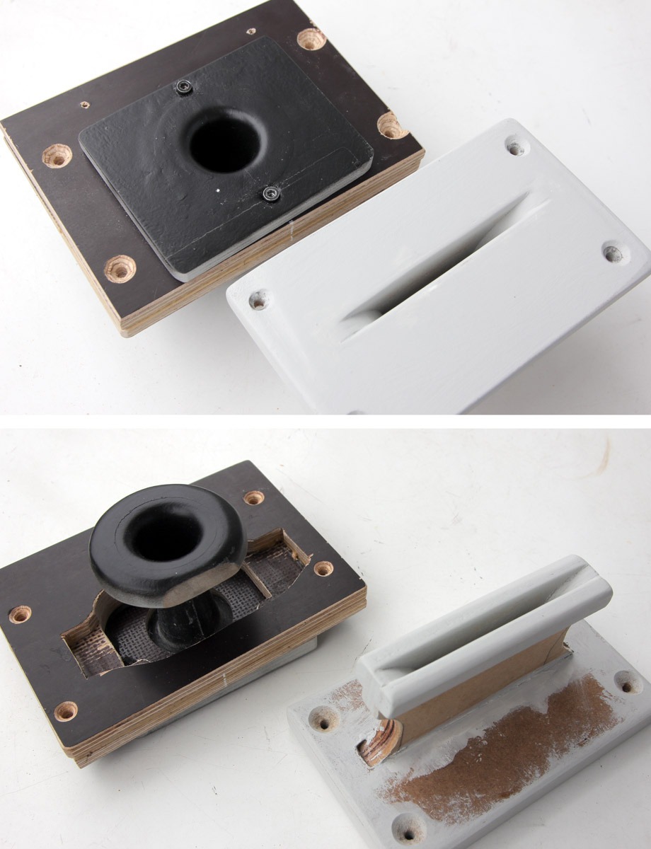

My test was intended to check for negative impact of very thin ports. But your suggestion absolutely makes sense.
The total cross section increase/flare rate remains the same, but the curvature (=air direction change) is much more gentle and might allow reduction of flare flow disruption.

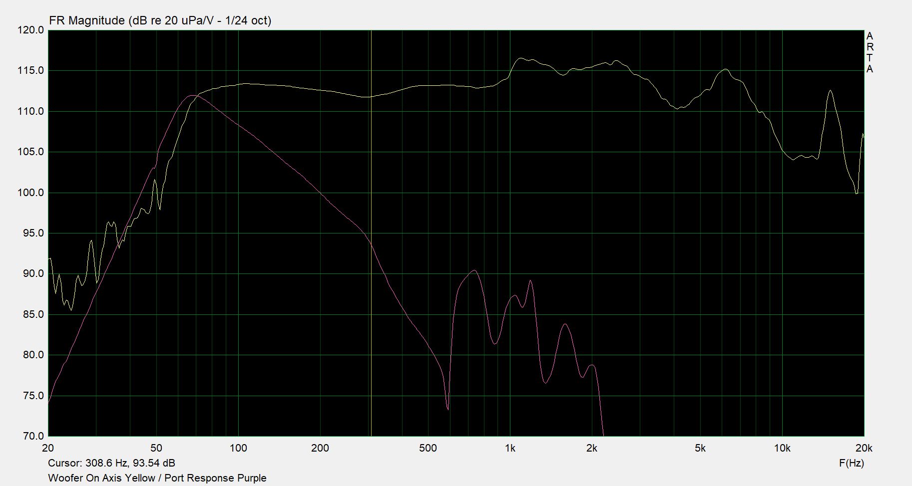

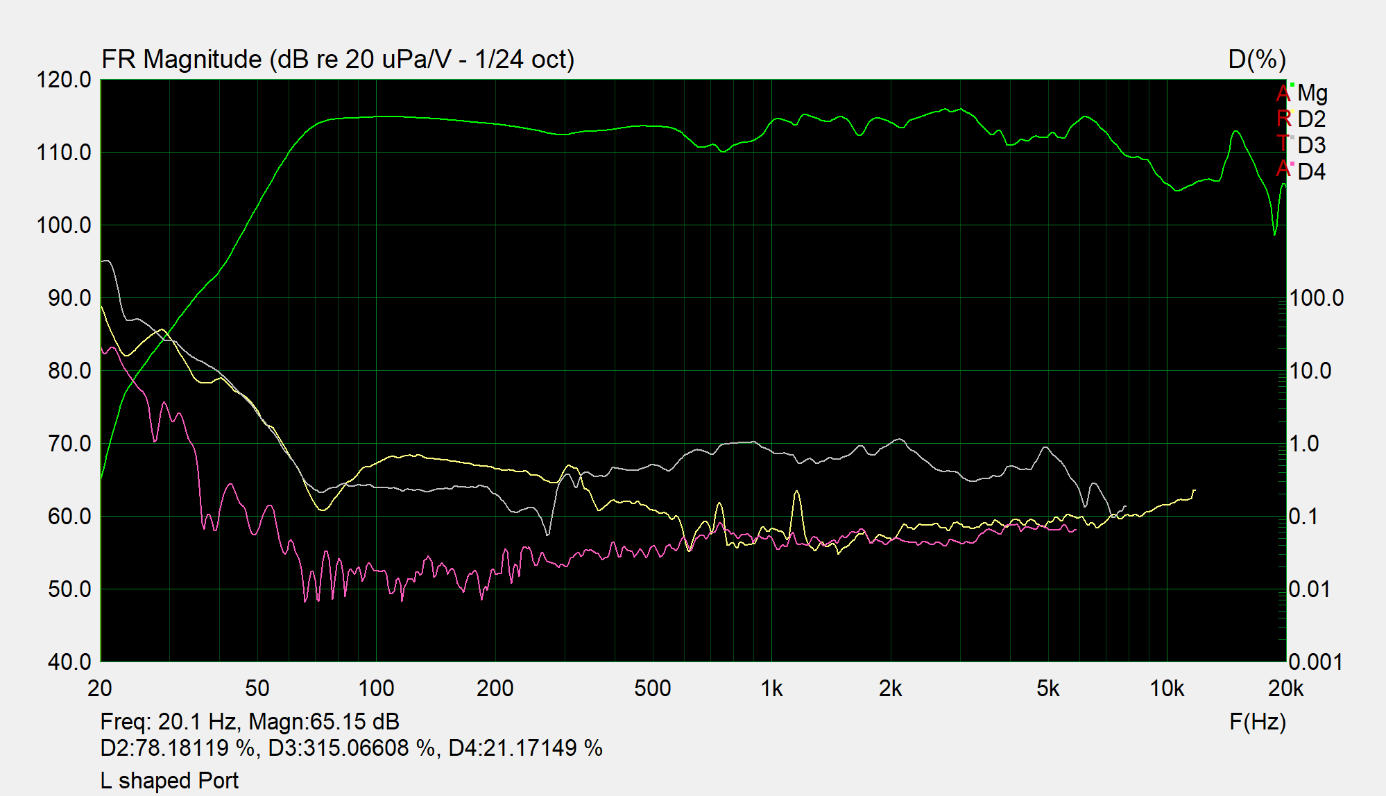

Did you also do impedance measurements as well? At different levels, eventually?

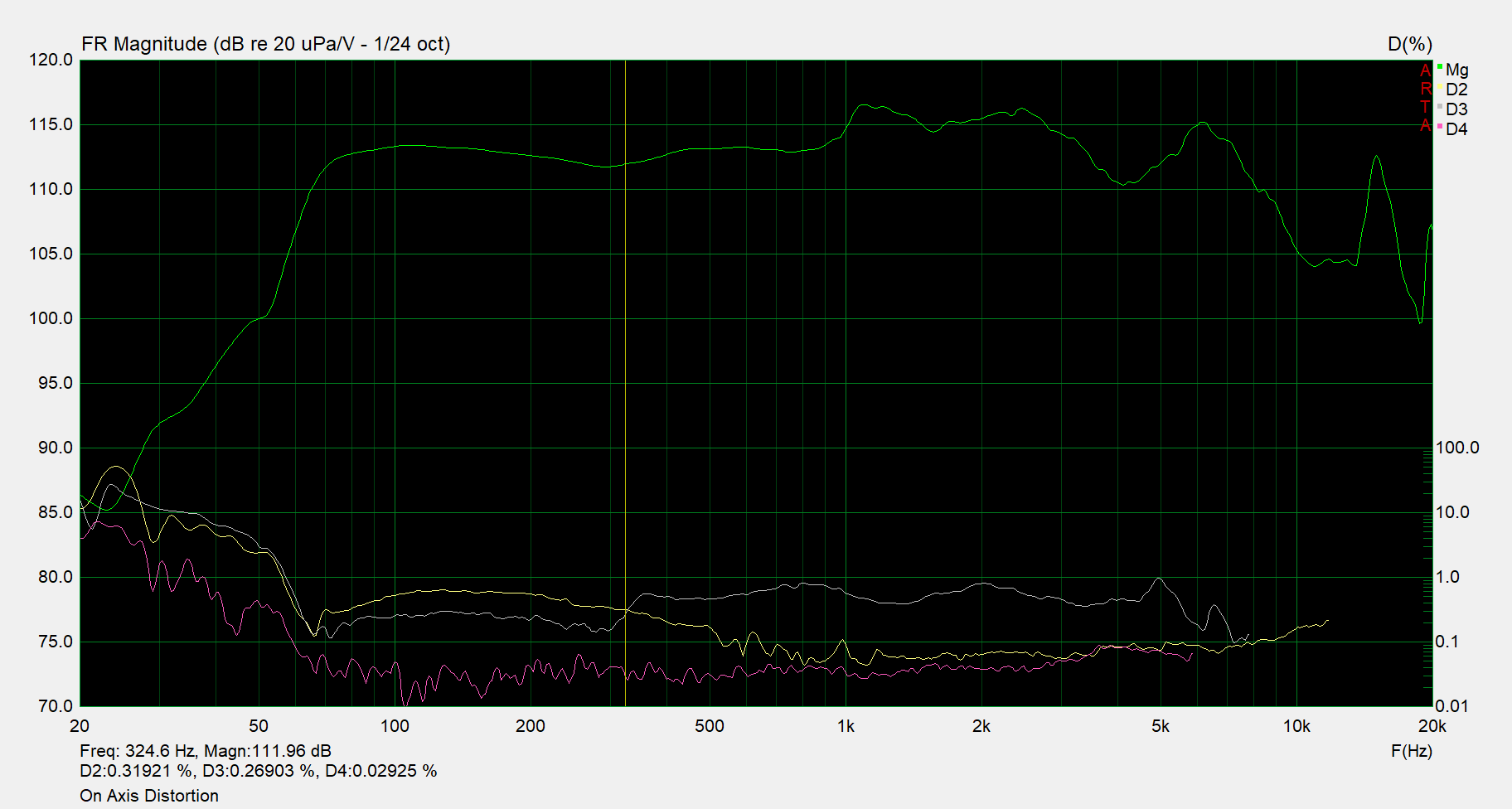

I saw this today and thought it was interesting. Note the flip in the harmonic distortion from primarily 2nd order in the low range to 3rd order from around 300 Hz. Then look at the port response. SPL not calibrated.
I guess this does thend to happen with woofers anyway...so not sure if the port is causing it.
It is, thanks!thought it was interesting

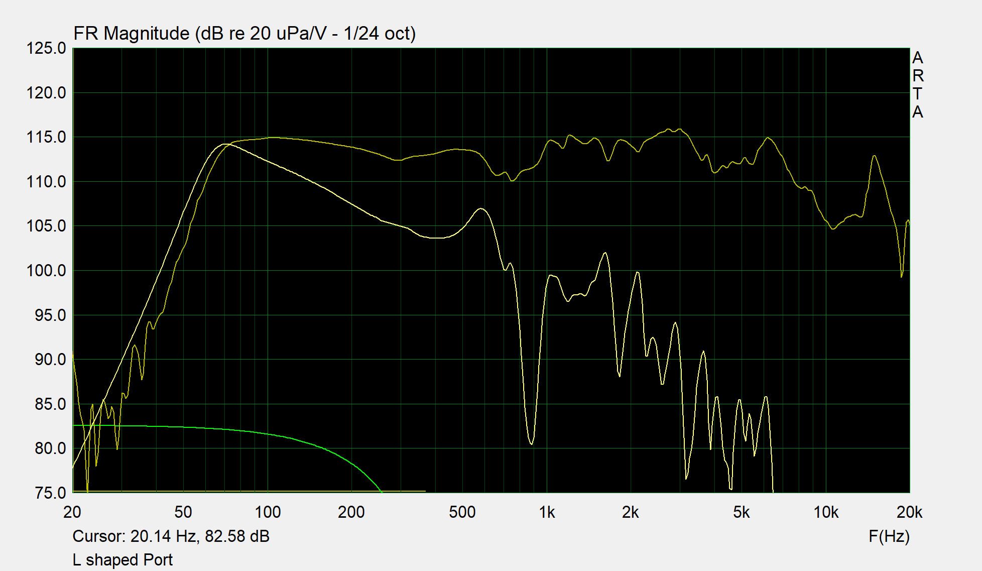

Could you tell me some more about the measurement method? All near field?
I see the following:
- The sligthly falling total response up to 300 Hz rises again above 300 Hz
- the port output drops steeper above 300 Hz
- none of the distorsion graphs seem to follow the port output peaks above 600 Hz considering their respective multipliers
- the H2 distorsion graph is quite even and gets wiggly above 500 Hz. That follows the peak at 1k.
- H3 has a step at ~ 330Hz (thus the H2-H3 flip). Again this just reflects the response peak at 1 kHz, as far as I see. Thus I don't think it's directly related to the port.
