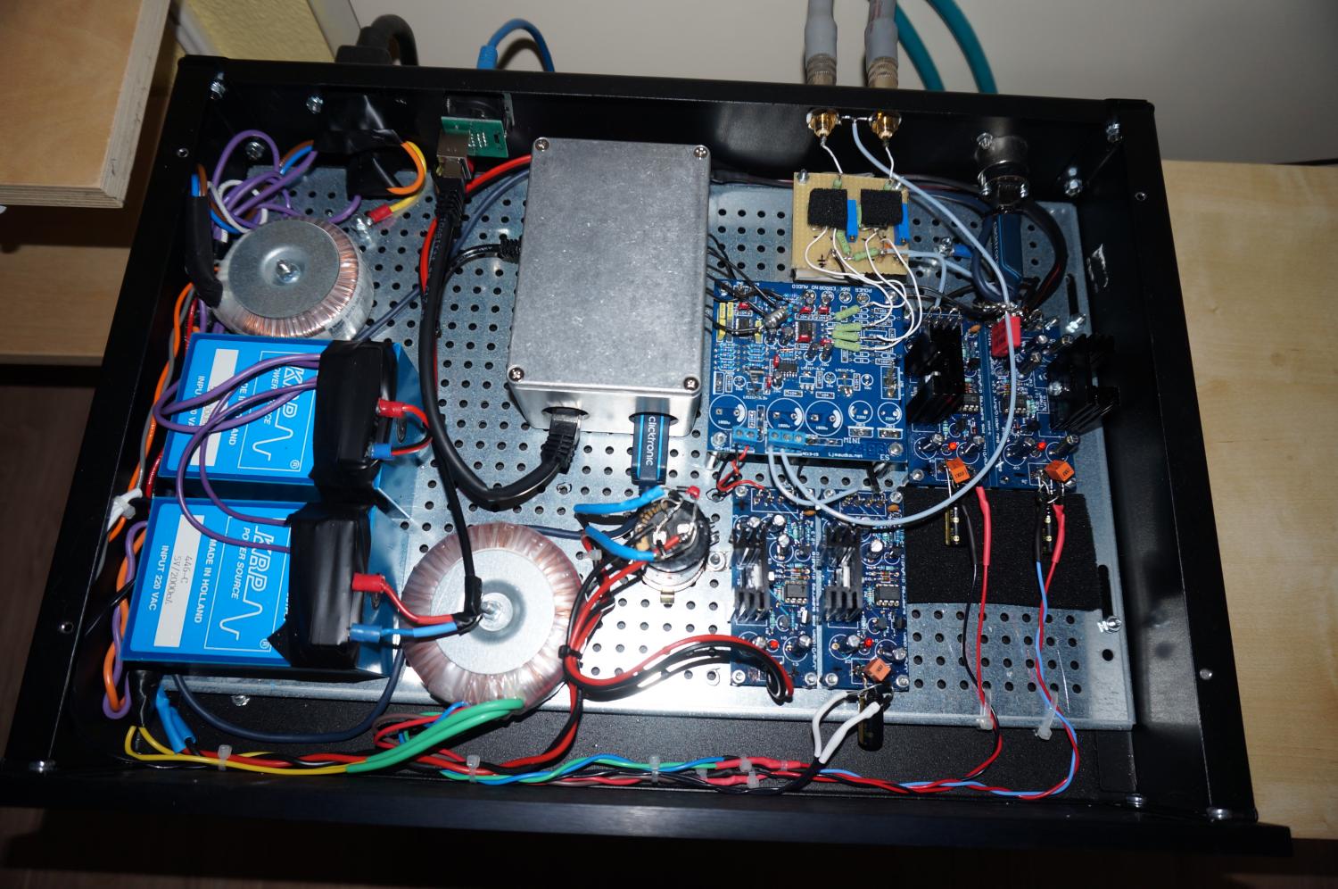

Last year I build a DIY audio streamer based on raspberry pi and LMS (logitech media server)/squeezeplayer.
The streamer works fine and sounds really good. However there is one big problem that I never managed to solve: a loud digital click/pop when changing from for instance playing a flac file to playing spotify content.
The pops are really loud since I use a power amplifier and digital volume control on the streamer itself. There are no digital pops/clicks when changing from local (flac file) audio track since auto(software) mute in alsa works fine then.
The real issue here in my opinion is that there is no mute signal available to mute the AK4396 DAC to mute the dac when there is no "signal".

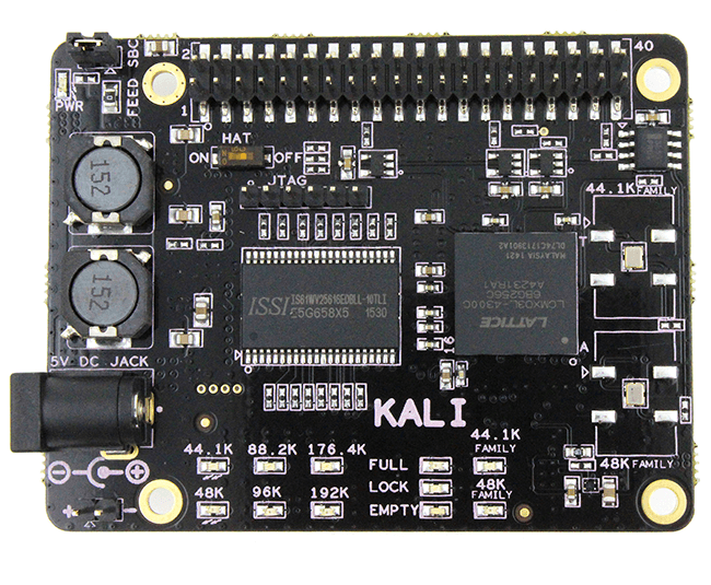

I am using the Allo Kali I2S reclocker to feed my DAC, it has no mute signal but it does have some leds like "buffer empty" , maybe I can use this somehow to mute the dac?
Any ideas/comments are very welcome as this issue withholds me to use the streamer in my stereo setup as I do not want to blow my expemnsive ceramic tweeters.

* Does samplerate change occur during the pop? How does the I2S reclocker behave during samplerate change, what does it do with its pre-filled buffer at samplerate change?

If the board clicks during sample rate changes, normal a simple solution is to have the LMS server resample everything to a set sample rate. However quite a few Dac board use gpio connections to mute the Dac, this is controlled at the driver level. What kernel driver is being used. Perhaps you can just use a different driver that has gpio/mute builtin and connect the gpio to your mute pin.
What is being used to connect Kali to your DAC?
raspberry pi -> Allo Kali I2S isolator -> Allo Kali I2S reclocker -> I2S signals to AK4396 DAC chip
Are "I2S signals to AK4396 DAC chip" being carried over a cable assembly?
If so then from what I've read the cables would need be of a shielded type for example U.FL coax otherwise they would be susceptible to picking up noise (EMI/RFI).

Good point!The reclocker holds 0.7s of data. No point in muting the DAC during the switchover when the actual data to be muted-out will reach the DAC much later.
Still we do not know when the pop occurs. What does that hw_params file say, before the switch and after?
I did some tests, indeed the loud plops are when sample rate is changing but not always.... I had to switch 10 times before I got one loud crack/pop. I was afraid my speakers tweeters
would be launched and hit me...
Very good. The key question is: Did you encounter a pop WITHOUT samplerate change? The change does not have to always produce the pop, it depends on sample values at that moment - if they have low level around the transition time, the pop (samples discontinuity) would be silent.
IMO the samplerate change should be accompanied with flushing the reclocker buffer while the DAC is muted. I do not know if the reclocker can be flushed with some external pin signal.
