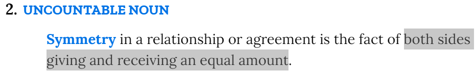

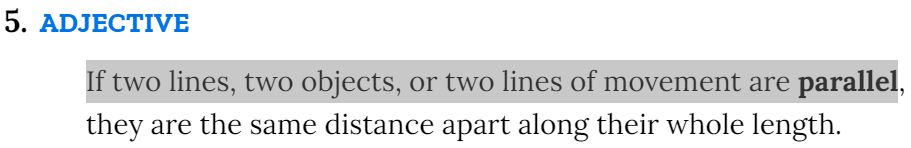

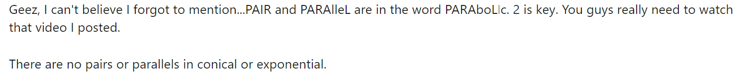

Geez, I can't believe I forgot to mention...PAIR and PARAlleL are in the word PARAboLIc. 2 is key. You guys really need to watch that video I posted.
There are no pairs or parallels in conical or exponential.

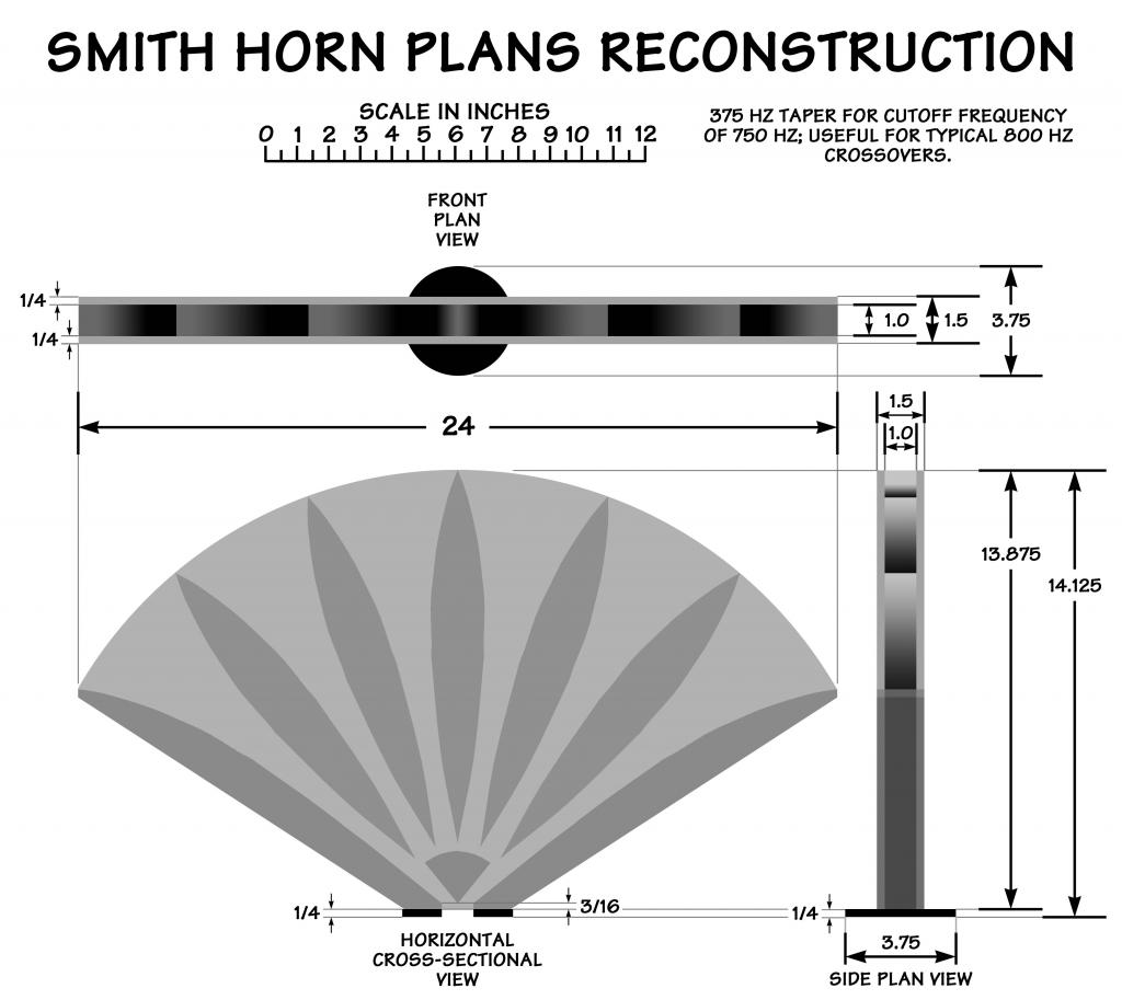

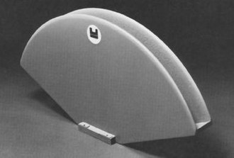

I have seen one, but unfortunately I do not have a photograph of it to post.
The two flat parallel sides were wedge (triangular) shaped, expanding from a width of about 5 cm at the throat end to a curved exit at the mouth end. The length would have been about 50 cm and the width at the mouth was about that also. The two parallel sides were separated by approximately 5 cm. The horn had a parabolic expansion rate, obviously.
The directional megaphone I saw had the same general shape as the horn in the attached photo. Unlike a bullhorn though, it had no amplifier.
(The dimensions were different and the included angle was less than the ones shown in the image below).

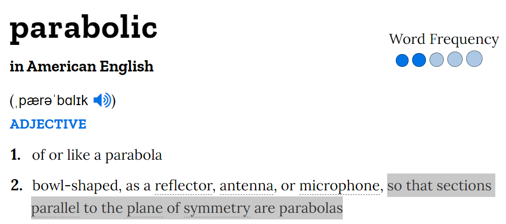

https://www.collinsdictionary.com/us/dictionary/english/parabolic
In that situation, would the model have mixed segments....parabolic for most of the length and then some type of curved segment for the last few centimeters?
The horn would be modelled as a single parabolic segment with the mouth area set equal to the maximum width of the two parallel panels multiplied by the distance separating those panels. Hornresp cannot take the curved "lip" extension into account.

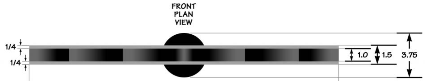

We need to see the mouth view of David's pic to see if it really has a parabolic segment.
It is an exponential horn, similar to the Smith Horn design you posted.
The megaphone I actually saw had a parabolic flare. It was of very simple design with just four flat panels.
This Smith horn look like a parabolic horn.
... but it is actually an exponential horn.
