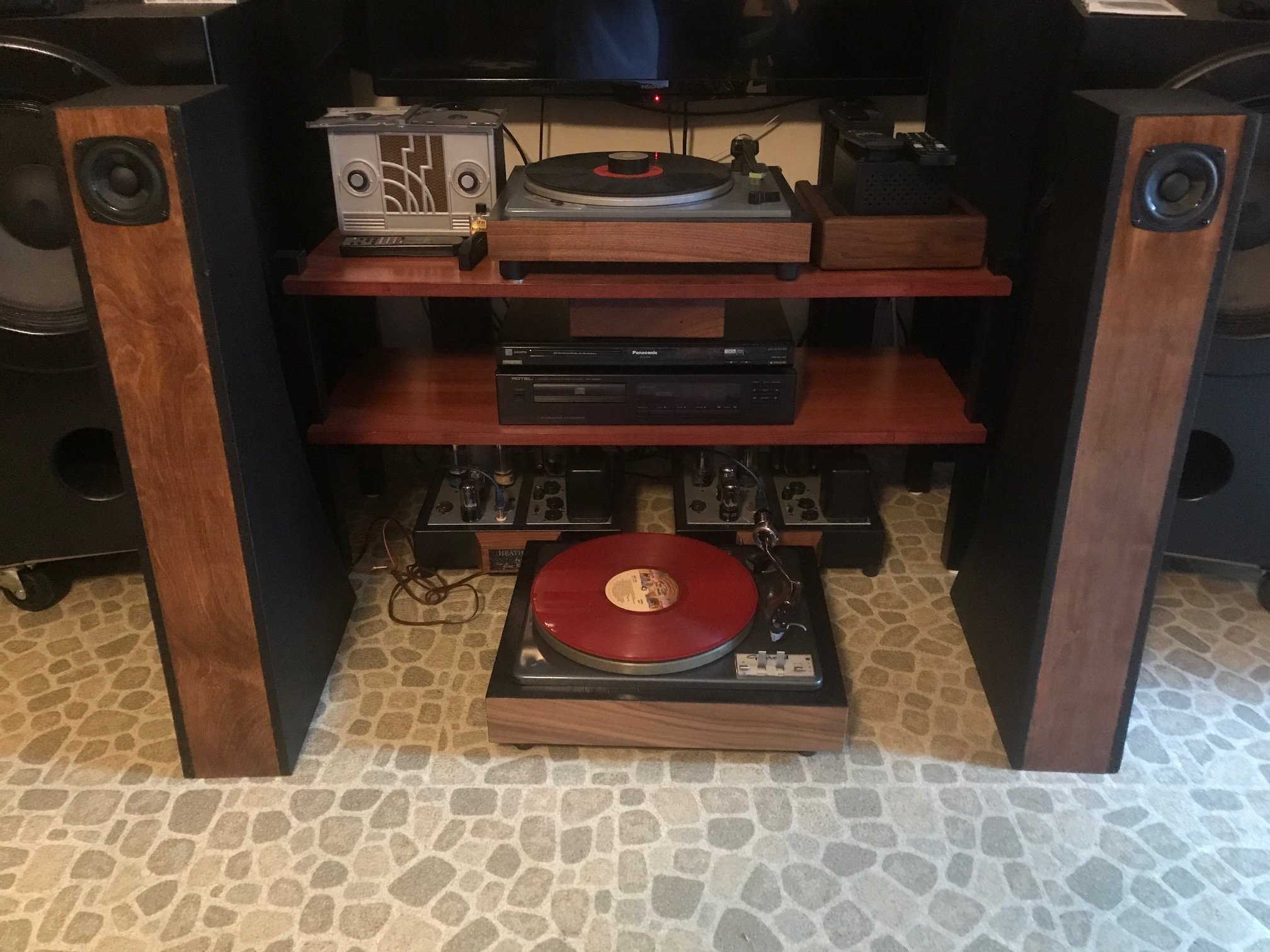

Michael Chua was pretty high on Dayton PC83-8 so I built these. Not wanting to spend a lot, I used green siding board for everything but the front baffle. Front baffle is a scrap of birch ply I had laying around. Used a little Duratex to dress them up. They sound great, great bass, not harsh on the highs! Glad I took the plunge. Thanks to Planet 10 and Scott Lindgren for a great design

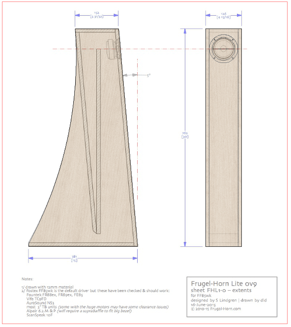

Hi planet10/Dave, would you have a dxf file of the FHL with Alpair 5.3 cutout that I can give to a local CNC shop for a quote? Or any FHL dxf file and I can modify the driver cutout. Just don't trust myself 100% to be able to draw those curved sides. No prob with DIYaudio donation, just let me know what I need to do. (or if you have a flat pack laying around, let me know...)
This is alll i have, a cut plan with blank supraBaffle.
And the drawing of the MA 5.x https://frugal-phile.com/boxlib/markaudio/Alpair5.pdf

At the time I drew the FHL but I did not manage to manufacture it, I have adapted the cutting hole for Alpair-5, here is the DXF with the exploded view for two units on a board (2500 x 1250 mm) of 12 mm thickness.
Roberto
Thank you for your responsethe bass won’t be as refined. The curve is a Ron Clarke innovation that makes the high aspect ratio mouth act more like a more optimum circlular mouth.

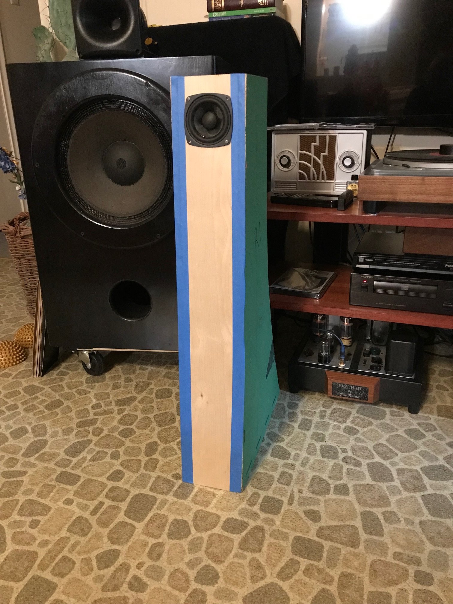

I’m a 50 something year old who’s loved music for half a century but who is just now tumbling down the rabbit hole of DIY Audio. Something drew me to the Frugel Horn Light as a first project (well, I slapped together a 12” passive sealed sub but I’m not counting it). I used some cheap, old 4” drivers from a defunct JBL shelf stereo and some 1/2” birch sand ply. Very cool! Great midrange sound.
I’m playing with “stuffing” and varying the throat width to try to get the best sounding lows. Also have 2 more types of drivers on the way to experiment with. Much fun!
Thanks to everyone involved in the design and refinement. I’m greatly enjoying my initial foray (and first post) into all this.
