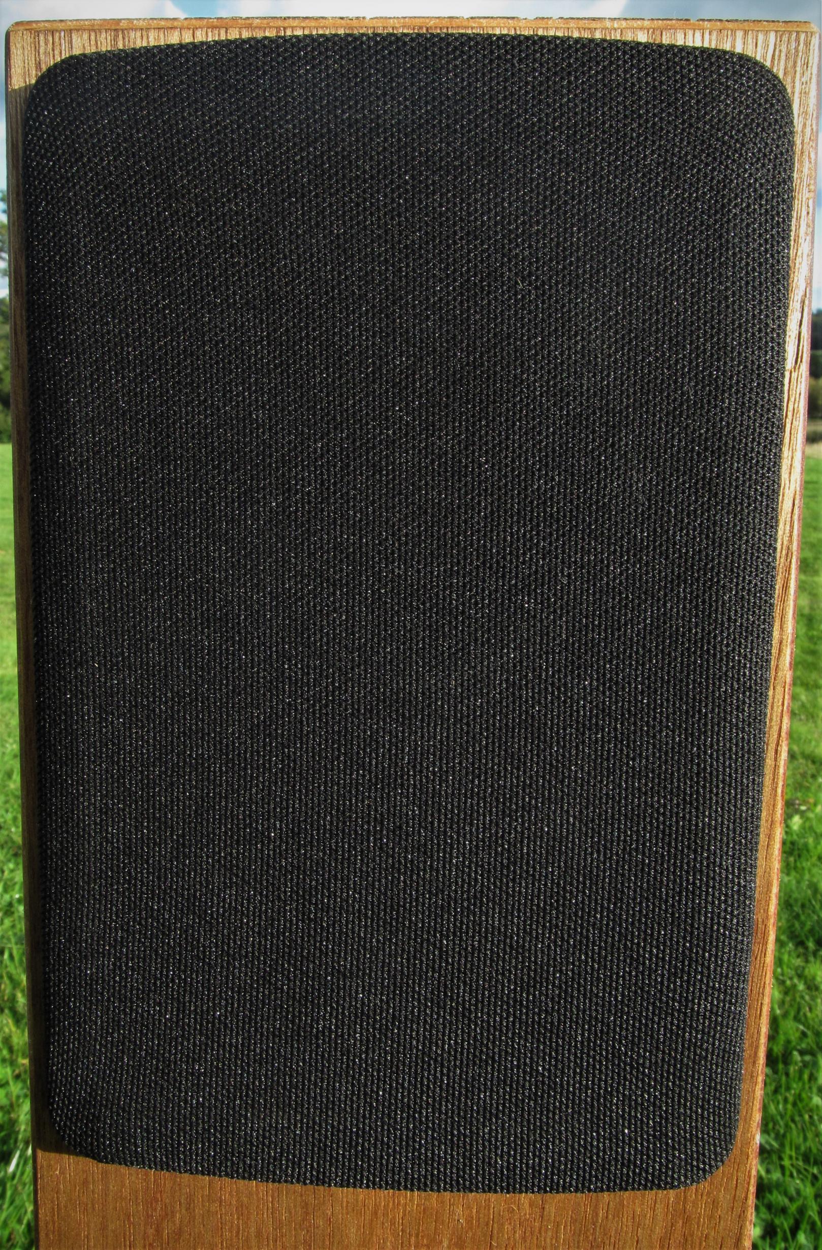

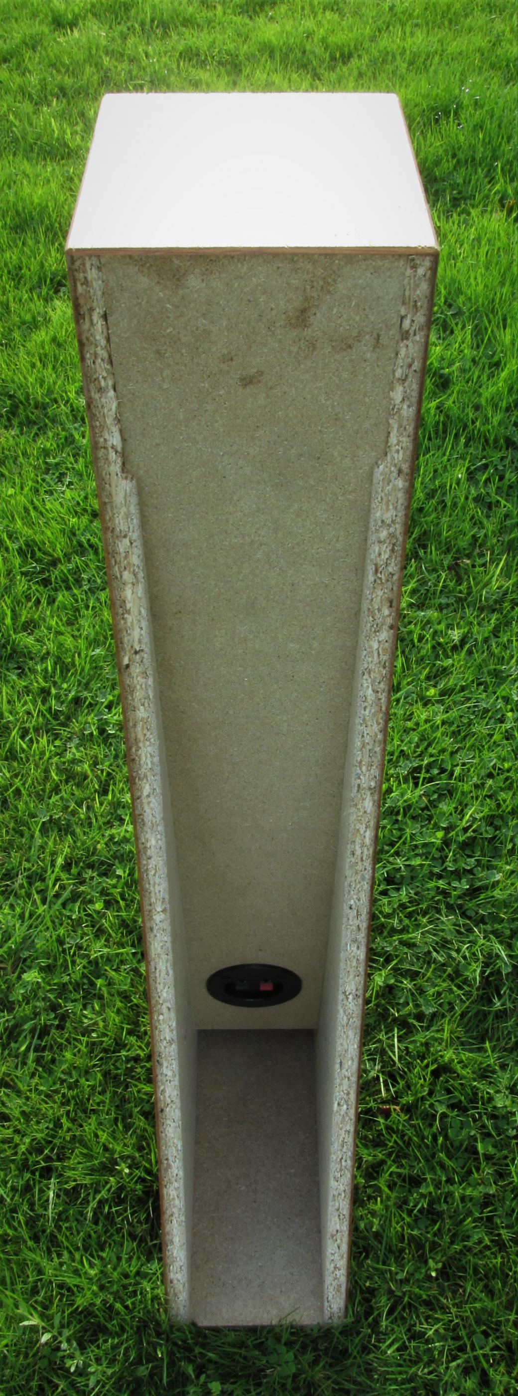

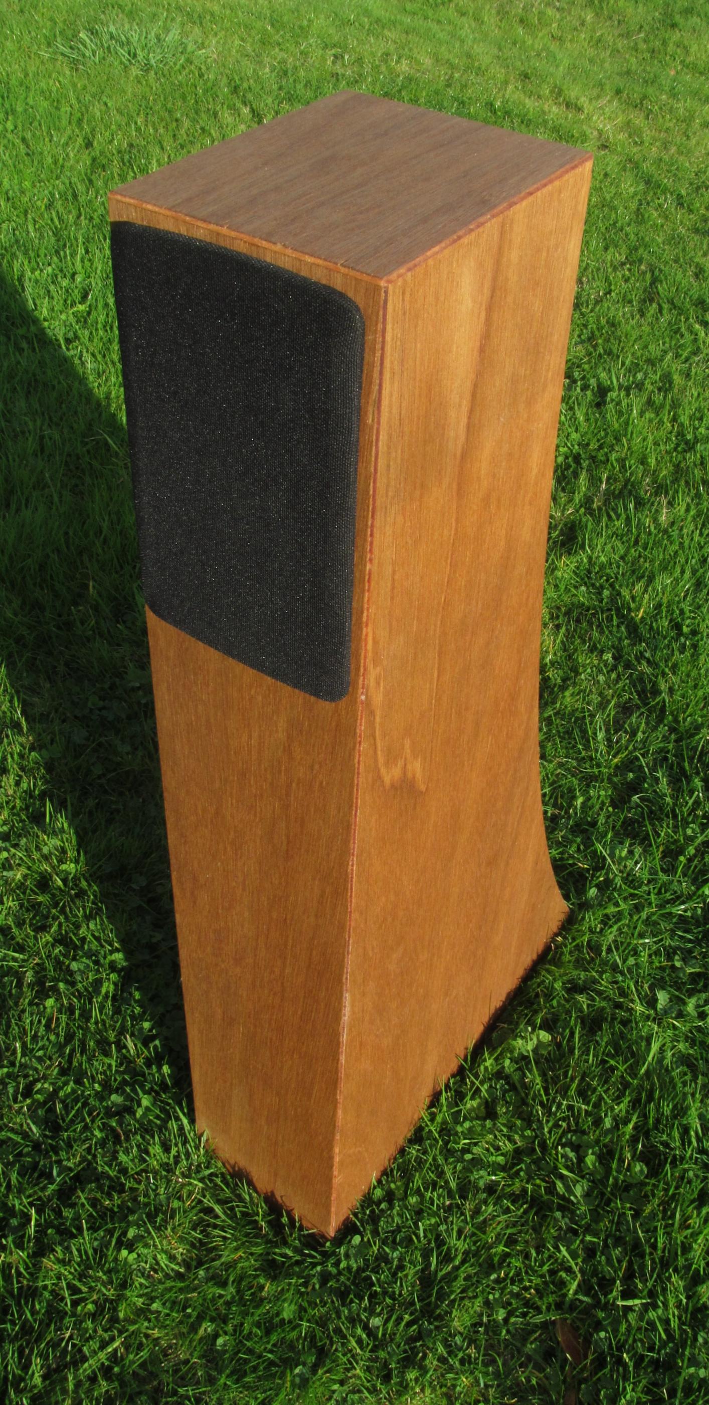

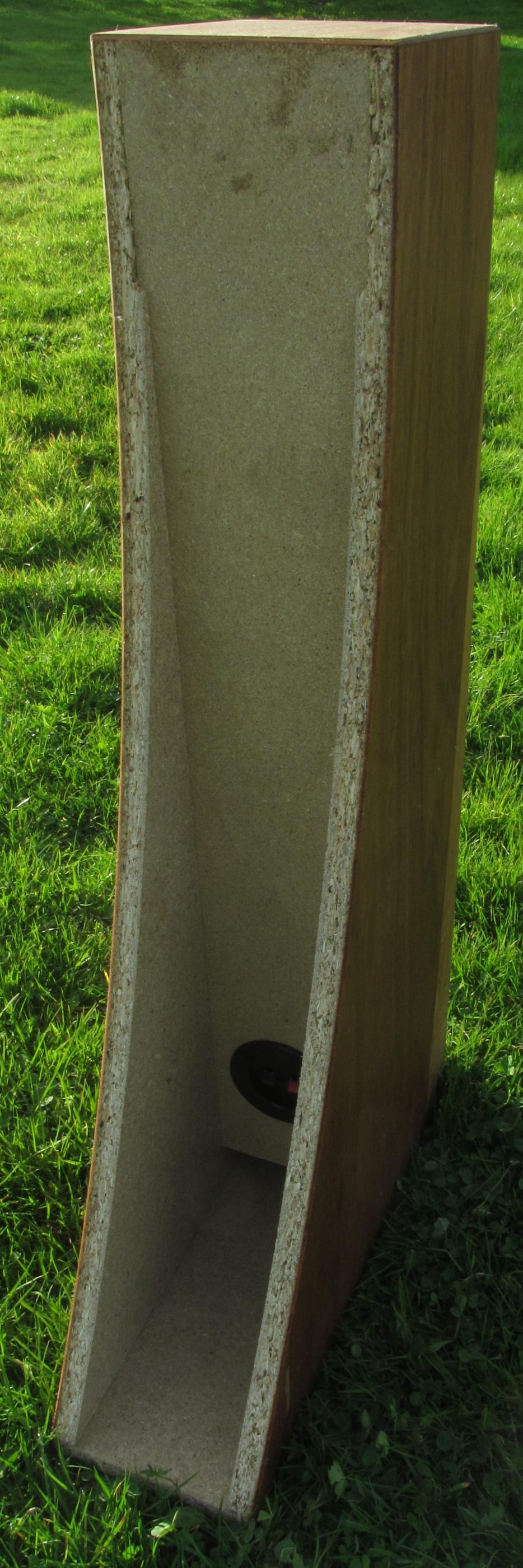

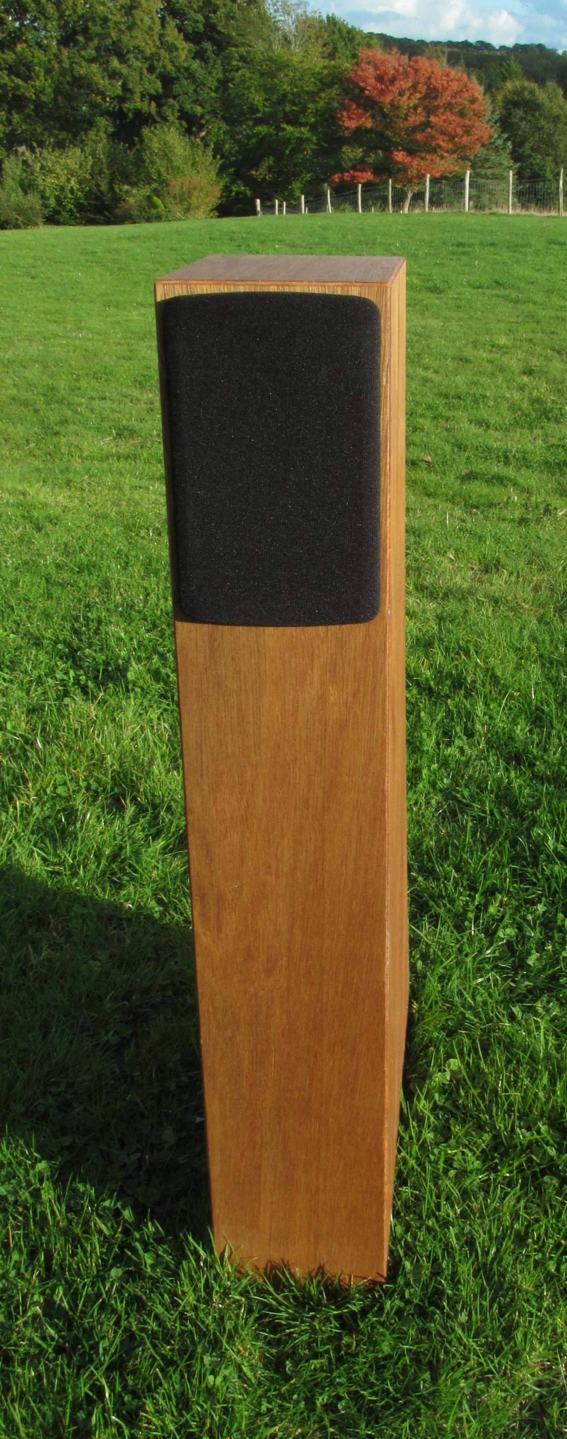

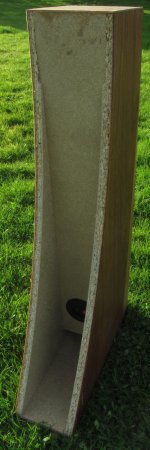

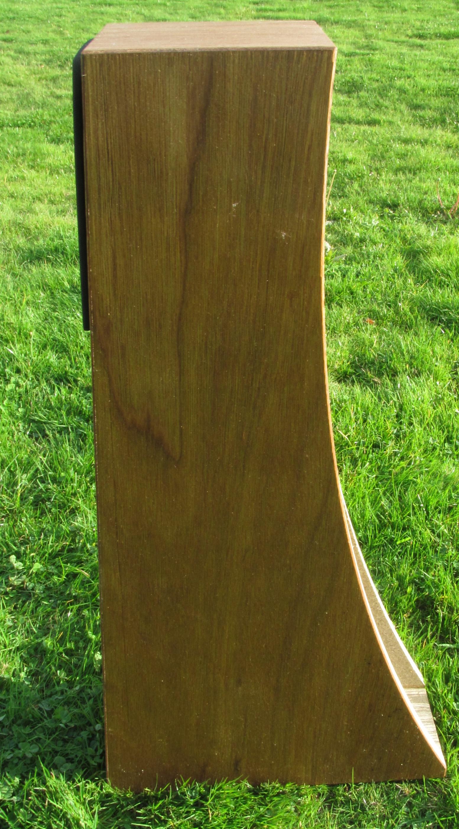

Thanks David. Here are some pics of the finished articles. Hope everyone is nice about them, because I am inordinately proud of the veneer finish I managed to achieve with what was actually a scrap piece of ply panelling from a friend that had obviously been used for protecting something from wet concrete...
I built these because I am a big fan of the FaitalPro 3FE22/3FE25, and I saw a comment from David somewhere on the forum that if you want the most bass out of these drivers, put them in a Frugel Horn Lite. I have to say that they do give more bass than my other enclosures (TABAQs) which is to be expected from a horn, I guess, but they also seem to do a better job of taming the rising high end response of the FaitalPros, which surprised me. I have a sub running with them, but I often turn it off, because for a lot of my music the bass from the FHLs is enough. The overall response is so smooth, even without a BSC. In the TABAQs, the Faitals are still a little shrill, even against the wall. This is just listening impressions, I haven't done any measuring or simulating...but I am really enjoying these speakers.
