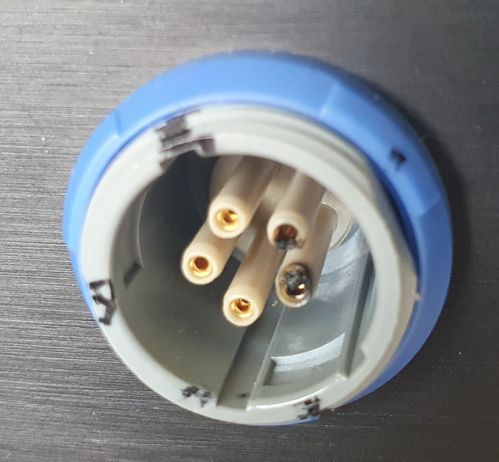

BTW I just found out the hard way that you should not leave high voltage connectors open ended. The mating plug construction is an integral part of the isolation.

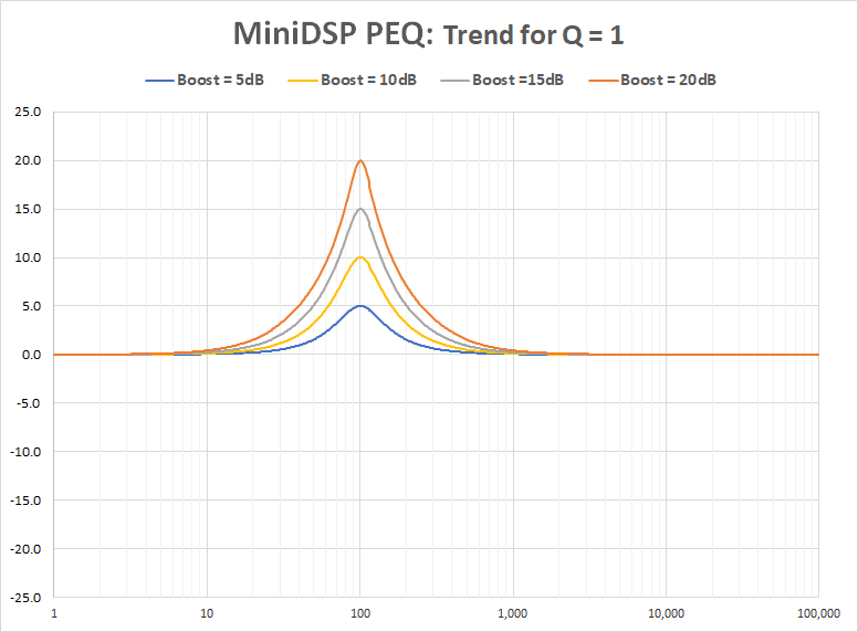

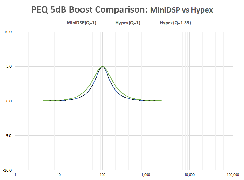

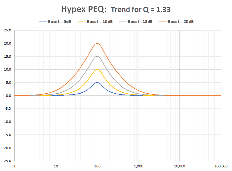

You may be interested to know that different manufacturers actually do use different definitions for PEQ filters. I noticed this when comparing MiniDSP and Hypex responses.
For example, if you put in a PEQ filter with Q=1 and gain = +5dB to both, you will notice that the responses are different.
You have to use Q=1.33 in the Hypex to get the responses to match.
Additionally, if you look at a trend of increasing boost, you will see that MiniDSP holds the -3dB bandwidth constant, but Hypex does not.
Instead you will see the shape of the central peak and slope transition to be constant.

Using the Qb and Qm naming convention in links above:
Qb = Qm/sqrt(gain) for gain >= 1
Qb = Qm*sqrt(gain) for gain < 1
The following products use Qb:
MiniDSP
Behringer iNuke DSP
REW
The following products use Qm:
Hypex
Behringer DCX2496
Multi-Sub Optimizer
FIR Creator
