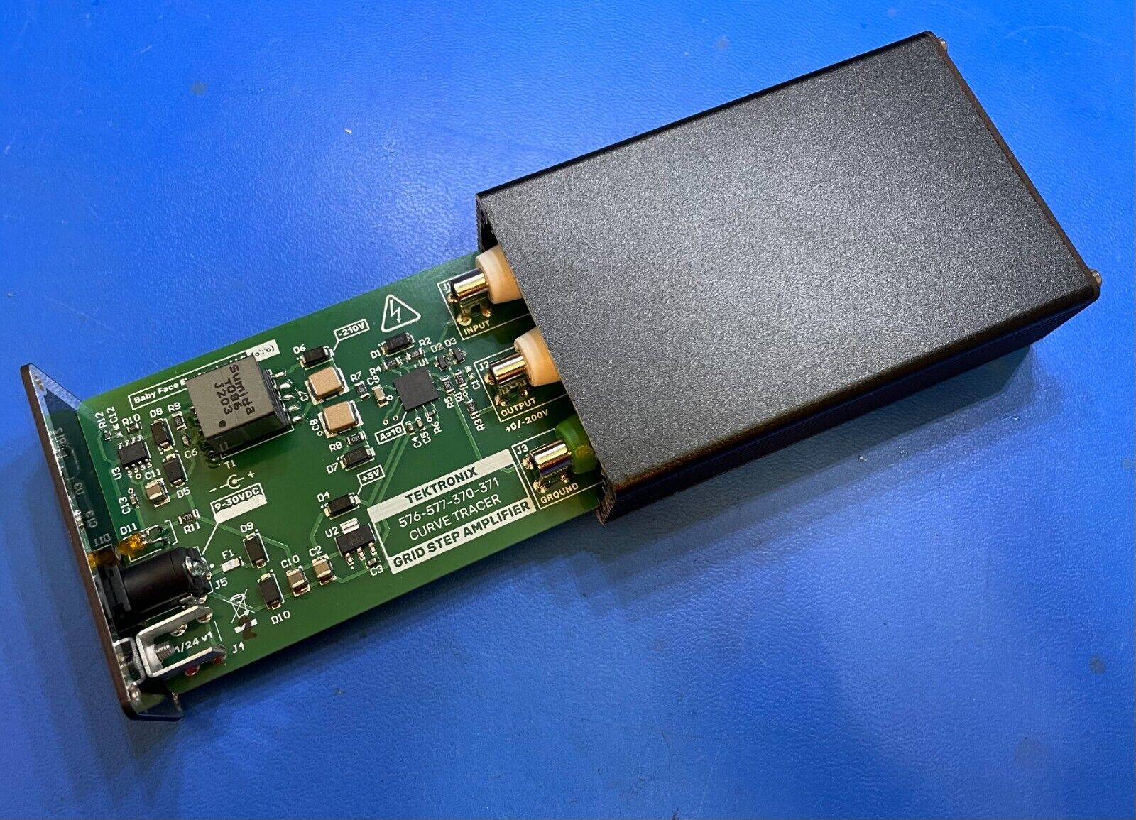

That Grid Step Amplifier adapter I mentioned before is advertised for use with the Sony-Tek 370 also. Gives you a 200 V neg. stepping range then.
Looks to be back in stock on Ebay.
https://www.ebay.com/itm/266781451716
But those TEK 370 type curve tracers are rather expensive on Ebay. I like the Tek 576 since there is no processor in it. You can figure everything out by looking at the schematics. Important if you want to change things.

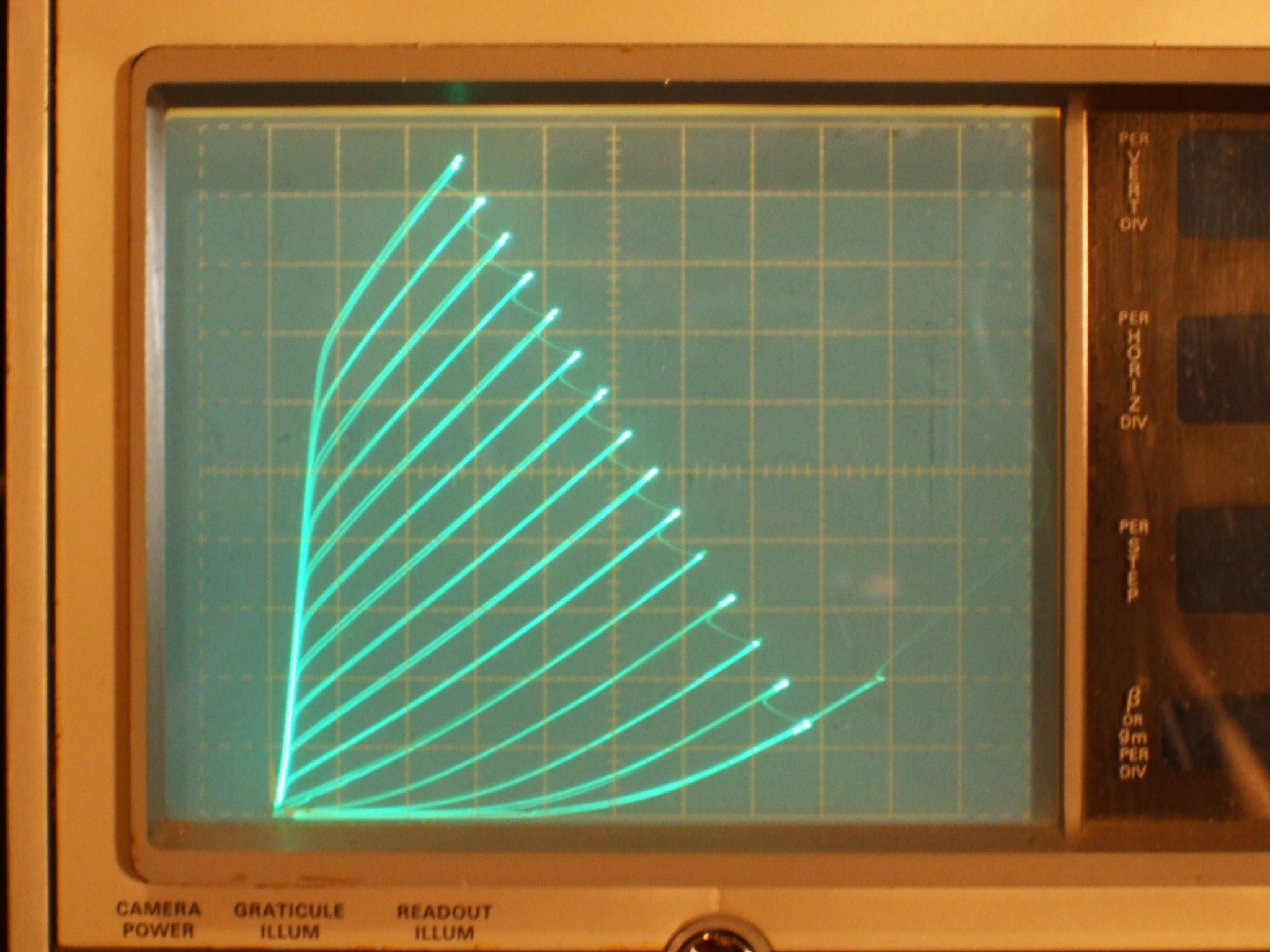

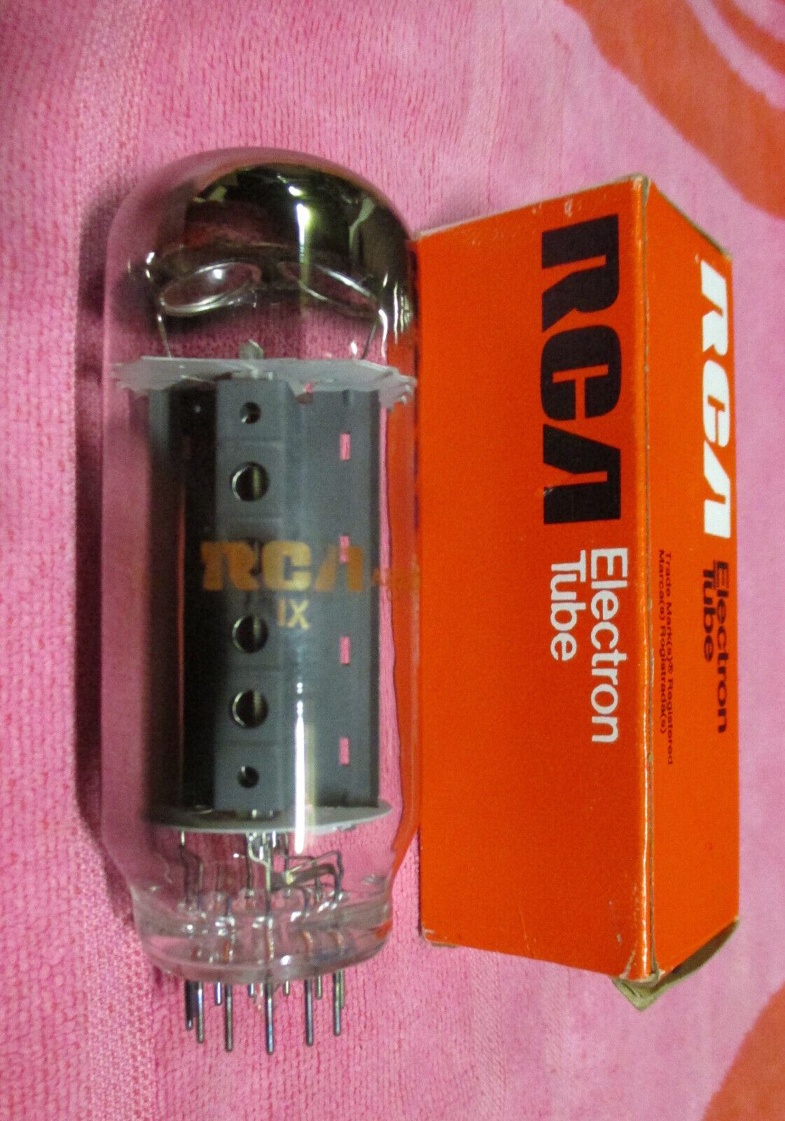

Here is another remarkable tube that -no one- wants. 6HZ5 (often marked 6JH5/6HZ5/6JD5 ) One of those despised HV Beam Triodes. -EXCEPT-, this tube type works at almost reasonable plate voltages. (the other beam triodes need 1000+ V ) That's because it has NO long/narrow plate "boxlet" between the cathode and plate. The plate support just comes right in to a square corner on the plate. Vacuum distance is minimized. Sometimes 6JD5 or 6JH5 will have this feature too, you have to check the plate picture. 30 Watt or 35 Watt Pdiss. Usually cheap. Curves are nearly the same as some very expensive old triodes which require 100- V grid swing. (this 6HZ5 runs on 7V grid swing)
100V/div Horiz., 20 mA/div Vert., 0.5V grid steps
