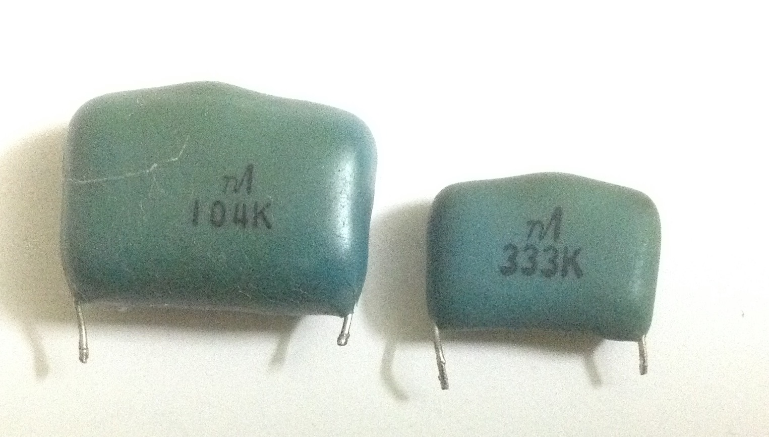

That is what they are all like. I purchased some and they were massive.Thanks for trying, but those are way too large and a bit expensive.
As it was said, cheap (and good) crossover film caps are motor ones (they are made of poplypropylene, usually).
And I haven't heard about 5 or 10 V rated film caps - they start fron 50 V.

I just got some WIMA MKP 1uF for $1 each and ASC polypropylenes 20uF for $2 each from Allelectronics:
