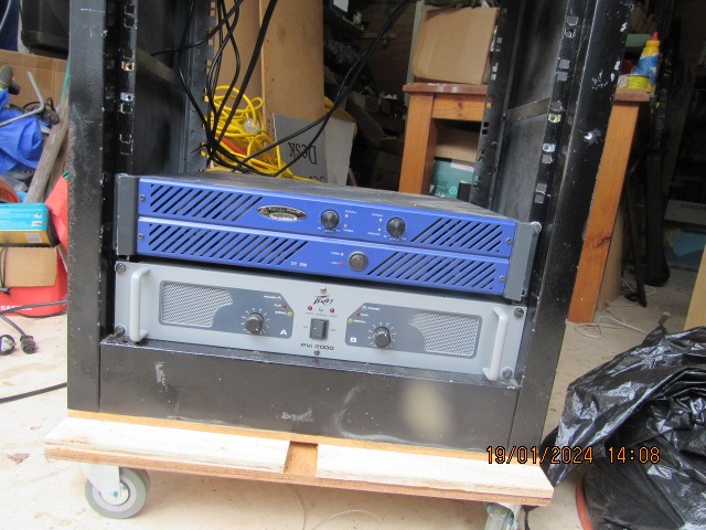

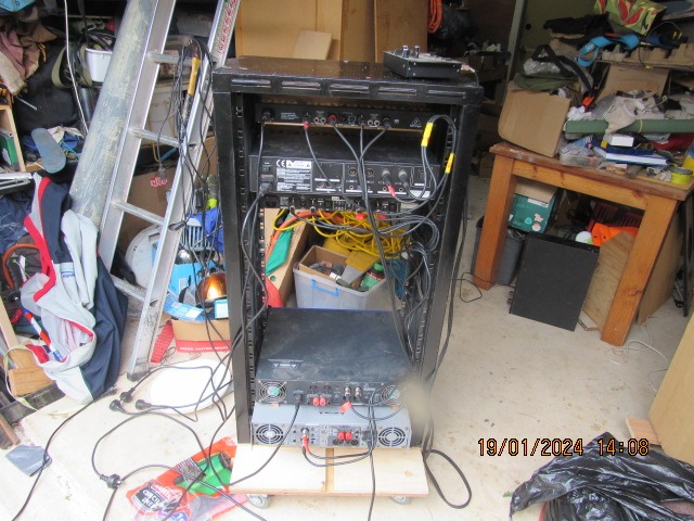

First thoughts are to try and buy a used set-up.
Can't really assist but "perhaps" a couple of used stereo Pro amps and a S/H Behringer CX2310
My own home party system didn't cost me much as it was all S/H stuff deemed too heavy for road use compared to modern digital amp gear but was still about $800-AuD for the rack
What about a whole heap of used car subwoofers wired up to give an even load for the woofers amp? Ask for donations of old subbies?
