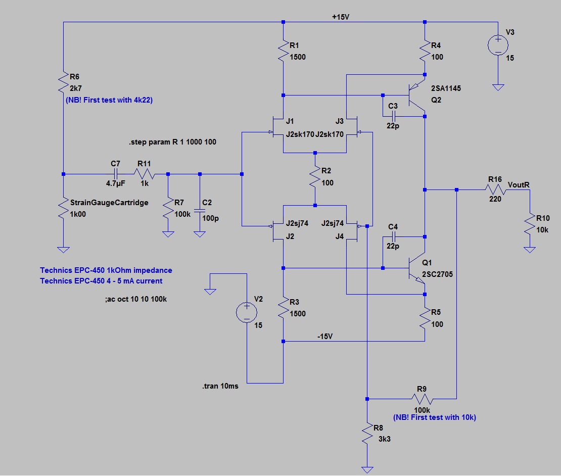

Attached is the circuit diagram of "my" solution. BTW the clone maker uses newer Japanese transistors than the original J212 and J175 JFETs and the then ubiquitous 2N4401 and 2N4402.
Transistors are 2SJ103BL and 2SK246BL for the JFETs and 2SC2705 & 2SA1145 for the bipolars. Passive components are also changed (obviously).
Anyway.

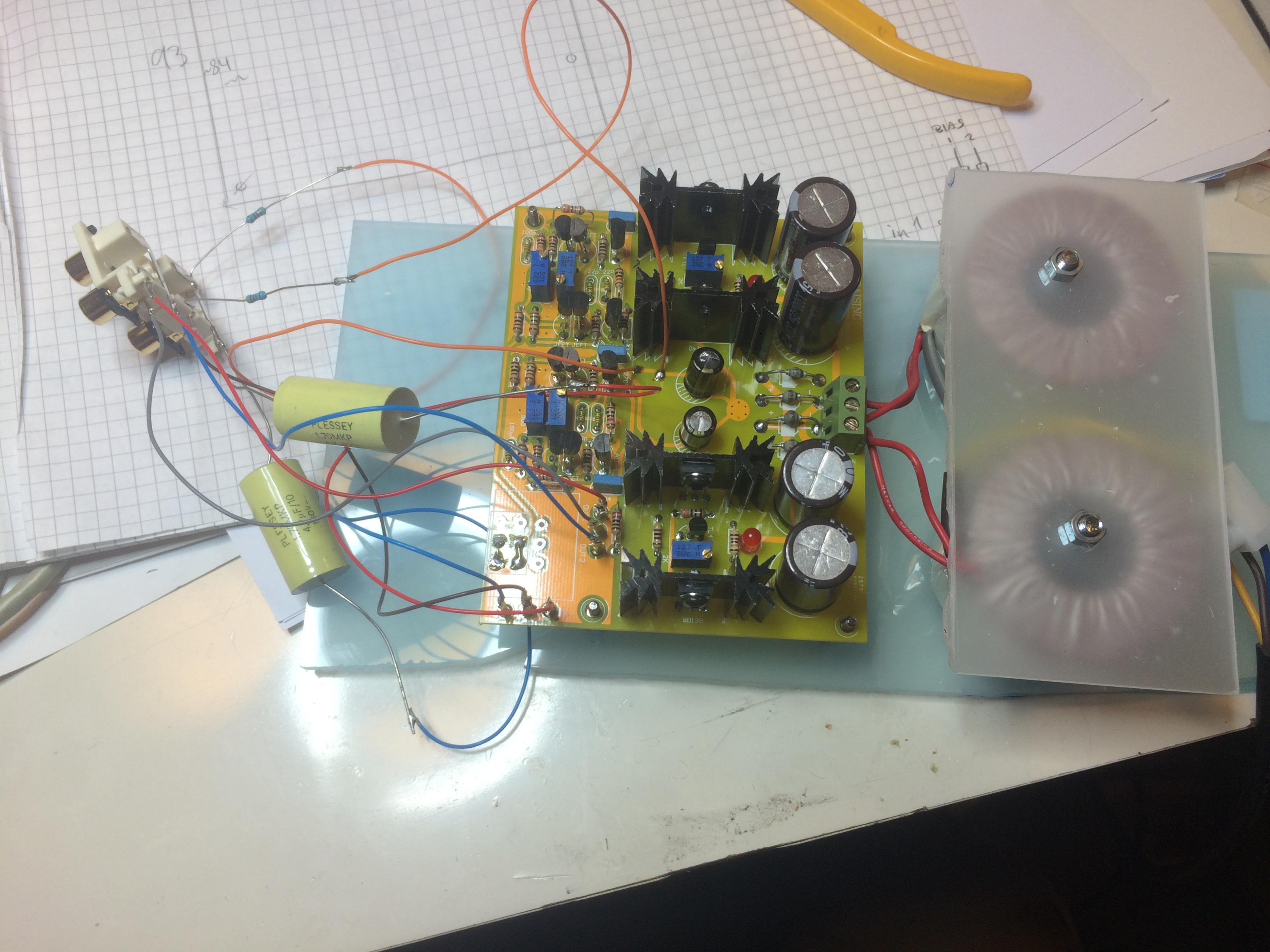

I simply built the circuit, adjusted the power rails to +/- 15V and adjusted offset (all by trimpotentiometers). Then added RCA in and out jacks, connected an iPhone to the input and the output went to my Pass DIY B-1. The circuit played music.
Then power off, and I added some old Plessey 4.7 polypropylene DC blocks at the input, see the picture. Bias should have come via 2k7 resistors from +15V, but I only had 4k22 as the closest higher value. So those were soldered in, and I simply connected everything together and played a record, and it sounded nice enough.
The gain of the circuit is intended quite a lot higher. Simulations indicates this should work. For now the gain is set by 10k and 3k3 to 4x or 12dB.
A word about the 4k22 (or 2k7) bias resistors. Both goes to +15V as there was two nice and handy plated holes for this. But I believe one of them could go to the -15V rail to preserve the phase. I did not care to swap the headshell leads at this time.

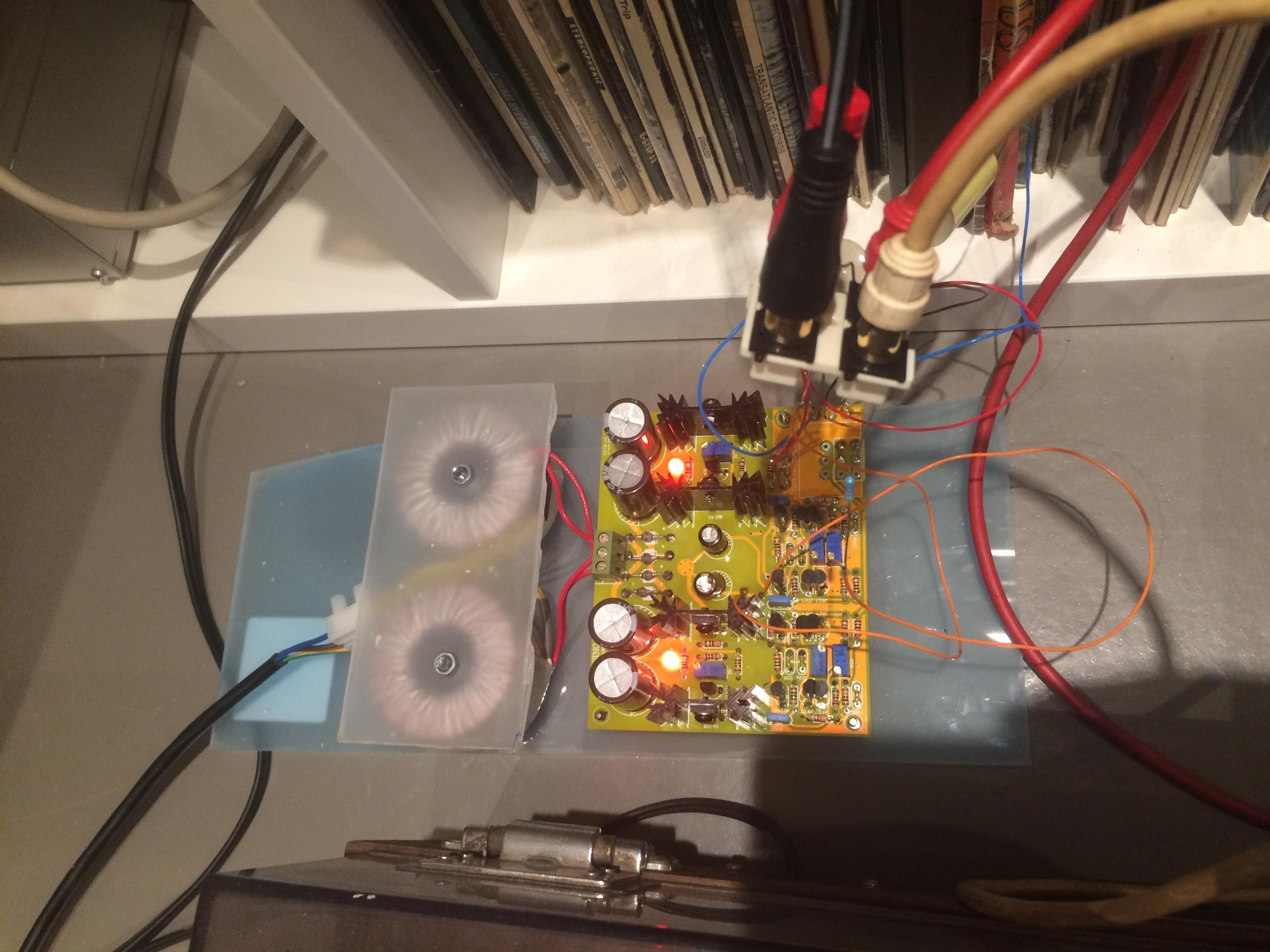

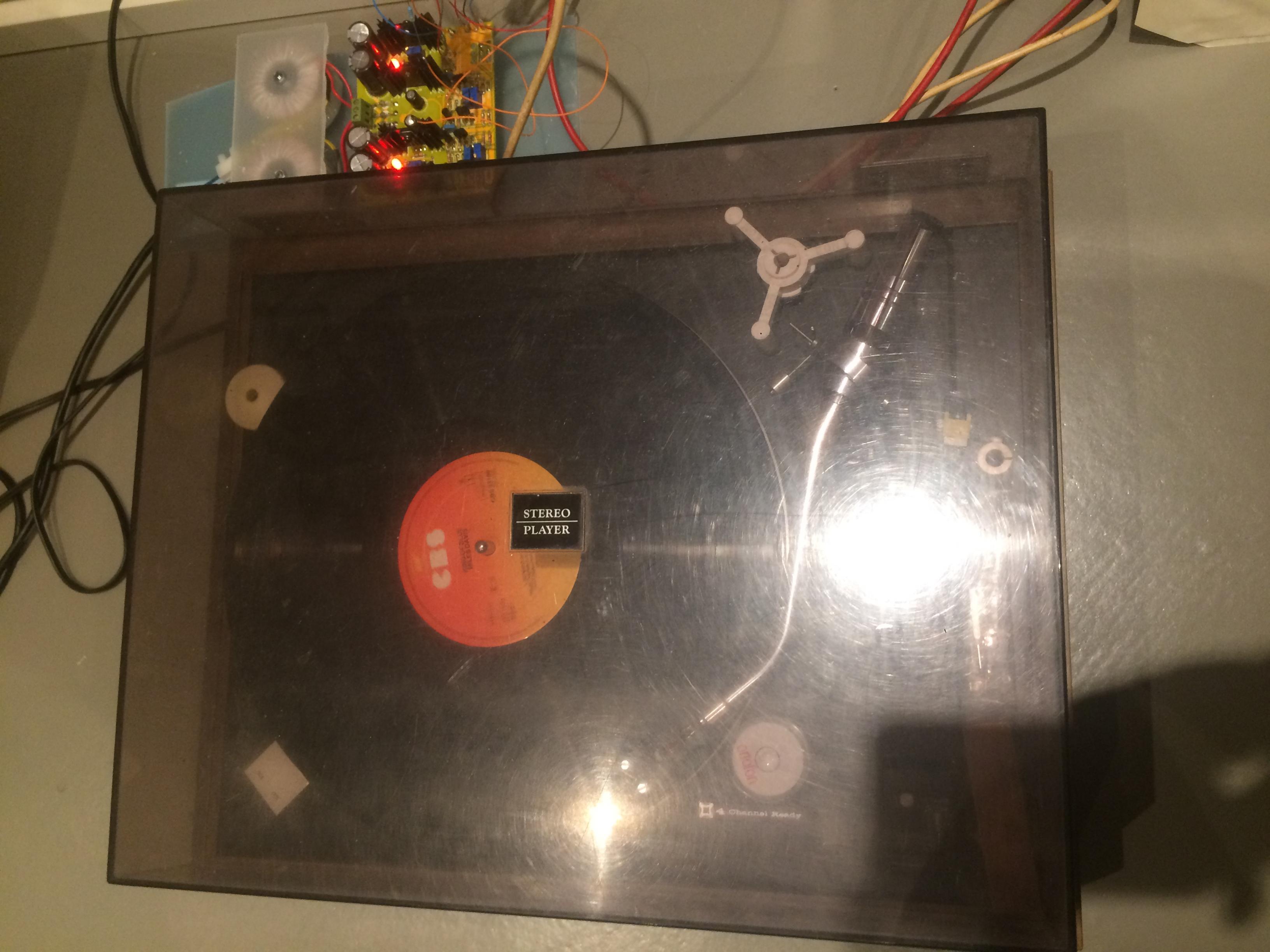

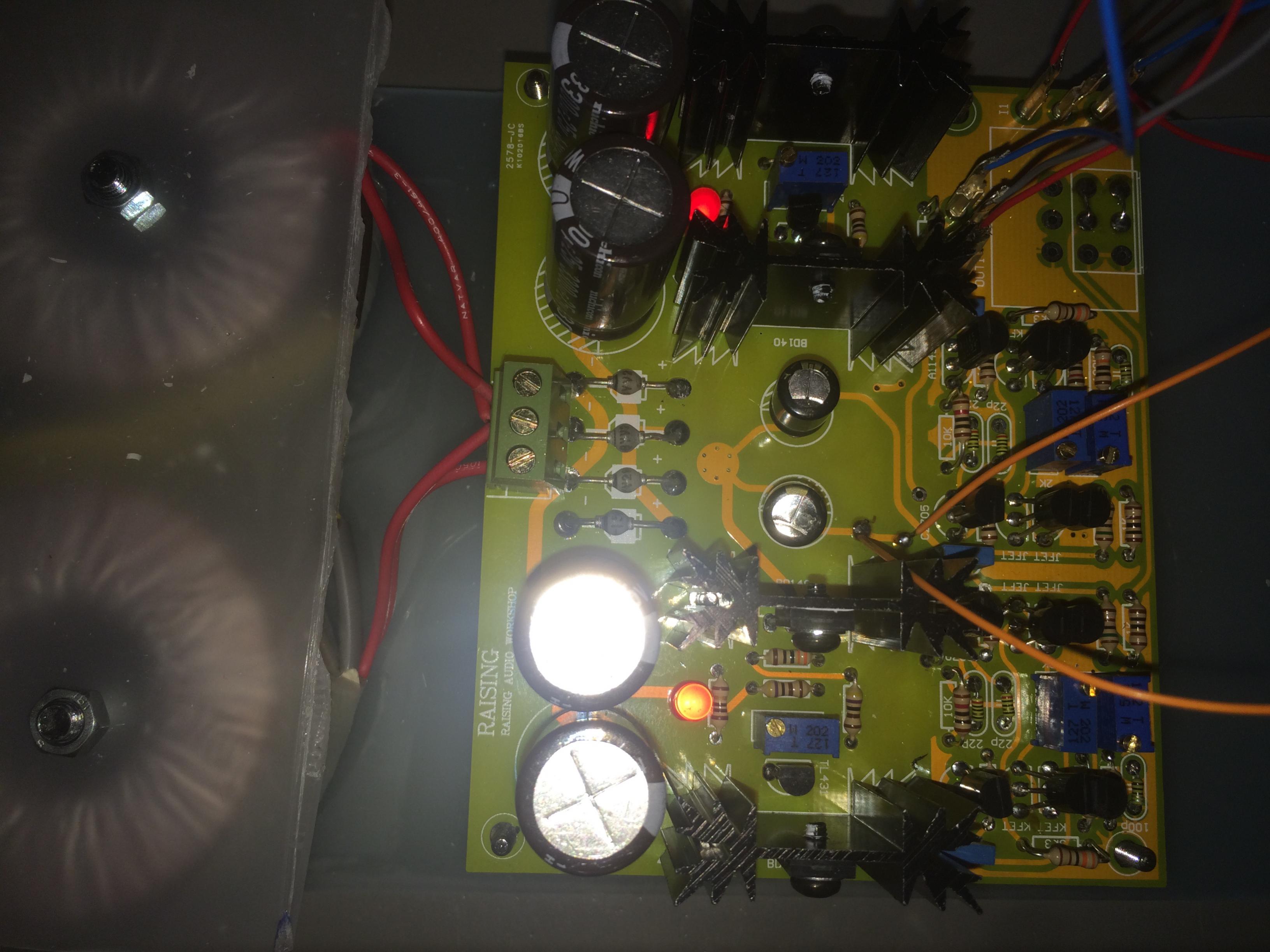

Pictures of JC-2 based strain gauge cartridge amplifier
Please find attached some pictures of my "demonstrator" circuit.
Of course, I will be more than happy to read your proposals for improvements, and even downright stupid things I have done.
One thing I also plan to test is to try my Stax CP-Y/II cartridge as a source. I believe this should work as well. Comments anyone?
/RK
PS. Please also start a discussion on shelf filters (or other solutions for the RIAA deviations).

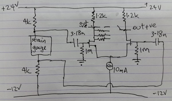

I have a WIN strain gauge and was reading this thread with interest until I saw this link. That was 4 years ago!! I still use that circuit and it works well but I have redesigned the input. My audio buddy is using the updated circuit and reports that he didn't notice any significant change when updating the circuit so I haven't rushed in yet and made the changes myself. In short, the changes are:
1. Old circuit is single end in, differential out. New circuit is diff in, diff out. This matters to me, because my power amps are differential and I like the idea of differential all the way.
2. The cartridge was direct coupled in original circuit, it is now capacitor coupled. In general I avoid in-line capacitors, but in this case it is actually a positive - the cap, in combination with the gate resistor, forms a high pass filter, that in combination with the natural roll-off of the SG, creates the response shelf below 50Hz, so the SG response is now a little bit closer to RIAA curve.
The circuit shown is a simple LTP as implemented by my mate, but it can easily be cascoded like my original circuit. The output sits at 12V dc so needs to be coupled via capacitor or transformer (I use a 1:1 Lundahl 1527XL).
One of the nice things about differential circuits is that attenuation is really easy. I have a 24 position switch wired across the drains of the LTP, first position is open circuit (no attenuation) and then other positions are taken up by other resistors which lower the load, and hence the gain of the LTP. This circuit feeds directly into my power amps. No pre-amp required! Also it is easy to reverse the phase on one channel by reversing the outputs of the LTP.
And the other advantage of differential circuit is that you don't need complementary devices. I think that complementary circuits are unnecessarily complicated. I'm a simple guy and I like simple circuits.

Hi Hazard500
I just read it with great interest. Nice and simple.
I have not had any time for the SG amp the last few weeks.
I intent to lower the input cap and raise the gain and also increase the SG current to 5mA. I had it at around 3mA.
Later I might try to eq it by a passive shelf filter at the output (but buffered with a e.g a JFET follower.
Later ....

I did a few changes simultaneously. I increased the current through the SG to 5mA, I reduced the input capacitor to 30nF and I increased the gain of the circuit to around 40dB by increasing the feedback resistor.
I also increased the noise (or it is much more audible now). I should have expected this... :mad:
So, I decided the solution shown above, plus the LSK probably, is to noisy. I found another solution with 2SK389V and 2SK109V in the front stage. Not exactly a "Papa" design, so it should probably not reside here. It is promising (just a quick test with PCB all over the floor). I shall finish it, take some pictures, and write up some lines about it just to conclude the thread. no more.
