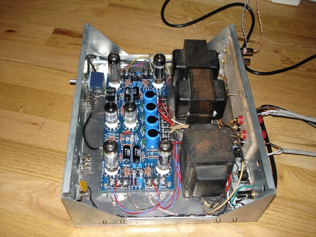

I got a good deal on one of those a couple of years ago. Not quite that good, though! I ended up doing a complete rebuild on my sca-35, but kept it in the same chassis. It's still my favorite PP amp.

With an SCA-35 you already have two of the most important components to build an outstanding tube amplifier, and those are the Z-565 output transformers! The SCA-35 was sort of a "mixed bag" featuring an excellent power output section, preceded by a cost compromised, rather poor line and phono stage.
The post above suggests replacing the PC-10 boards with PC-13 boards, which, using the other existing hardware, will turn the unit into a ST-35. This is a great idea. If you look around the 'net, you will find these boards available both as "pre-stuffed", or " bare boards".
A couple posts above, "Wicked1" shows a different approach which is also an excellent idea. His picture shows that he installed a DIY Tube ST-35 complete pc board in his chassis. This single board has the advantages of having a step-by-step manual available for free, some built-in power supply upgrades, and a wider choice of input and phase inverter tubes. With the original Dynaco PC-10 setup, you are pretty much stuck with using the 12DW7/7247 driver, which has it's drawbacks. The DIY board is available from Triode Electronics, again both "stuffed" and "unstuffed".

Hey Wicked1,
Where did you find the circuitboard in your picture!

diyAudio Member
Join Date: Jan 2008
Quote:
Originally Posted by revintage View Post
Hey Wicked1,
DIYTube ST35 Driver Board with Parts
