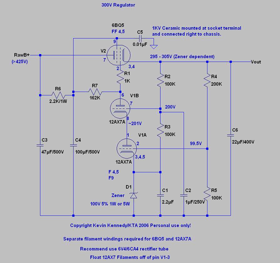

Here is my standard 300V regulator, note that it is zener based. Getting good performance with the 5651 gas reference is a little trickier. This design works right out of the box. Note I provide it for none commercial use only.
The voltage can be easily reset for different output values from about 200V to 350V with a few component value changes which I will happily provide to anyone who asks.
To make life easier for the 6BQ5 I recommend a tube rectifier, that said it works fine with ss rectification to output voltages of 300V, higher than that a tube rectifier is de riguer to prevent pass tube arcing. Currents higher than 40mA should use the 6L6 otherwise its the same.
Keeping the noise down on the output depends on how clean the screen supply is, and how much feedback margin is available. Typically I aim for a margin of >30dB if possible.
Open loop gain is in the range of 43dB +/-3dB and I recommend not scaling voltages by more than a factor of 3 to 4 in order to maintain sufficient loop gain for good regulation.
The cascode error amplifier works best with output voltages of 200V and above, the only limitation is to avoid exceeding the voltage ratings of the 12AX7A - in practice up to 500V output voltage is practical with a 6550 pass tube and a few other minor changes.
Note that you must provide separate filament supplies for the 6BQ5 and 12AX7A. Regulated dc on the 12AX7A filament is not necessary but does not hurt either. A 6CA4 may be operated on the same winding as the 6BQ5 if necessary.
Warm up drift is mostly dependent on the zener chosen, and I recommend 5W types for lower drift. Once stable the voltage should drift less than 1% in a 24 hr period.
Output ripple of <1mVrms is possible with careful layout and a 12AX7LPS in the error amplifier. Line and load regulation is better than 1% no load to full load as long as the raw supply is at least 100V greater than the output voltage at lowest line voltage encountered.

Hi Sy,
Yes I just connect the cathode of the pass tube directly to the filament (in this case pins 3 &4) - this obviously necessitates the use of a separate filament winding for the pass tube and error amplifier.
I noticed I forgot to show the ground connection on the negative side of the supply. The center tap of the power transformer (or negative lead of bridge rectifier if used) should be connected right at the very first filter cap. I usually bring a bus ground back to this point which is usually also the point at which I make a single connection to chassis. This is also usually the point I recommend connecting the ground return from the load. (Modified star ground basically)
Incidentally with really great care in layout it is possible to get ripple and noise down below 100uVrms at the output.
I know the 12AX7 is not nearly the optimum choice in terms of transconductance for a cascode amplifier configuration, but despite this the performance is actually quite good, and the 12AX7 can stand off quite high voltages with a little aforethought. I umm have done 1KV regulators with only a few changes to the topology..

Hi Kevin,
I know is an old thread, could you tell me the component value changes for 280V?
TIA
Felipe
Hi Kevin,
TIA
Felipe
Add a 10 or 20k good guality pot (or trimmer) between R4 and R5 and adjust for desired voltage around 300V. Don´t use a dirty or old pot where the wiper can become disconnected from the track.
Thanks, guys, but no. Easiest just to change R4 to 180K.
Note that you can also shunt across R4 with a very good quality film cap, if you do this I would make R4 361K and R5 200K, and use a 0.22uF cap. This should reduce ripple at the output by about 10dB and reduce output impedance substantially at audio frequencies (not DC).
I would recommend further changes, I no longer connect the filament to cathode directly even with the dedicated winding due to common mode ripple injection into the output DC. I now recommend using a 470K resistor from cathode to filament and a 0.22uF 400V film cap from that point to ground.
FWIW I also no longer recommend this circuit be used below 250V, nine years is a long time. (And in that case a lower voltage zener must be used)
