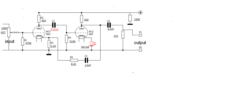

Hello guys,
since there is no schematic on the net, I visually rebuilt the connections, I noticed that the schematic is much like Little Bear Tube preamp.
I want to try to improve it and I want to reduce the gain, what do you advise?
These are the values and schematic detected in my preamp Preamplificatore valvolare stereo

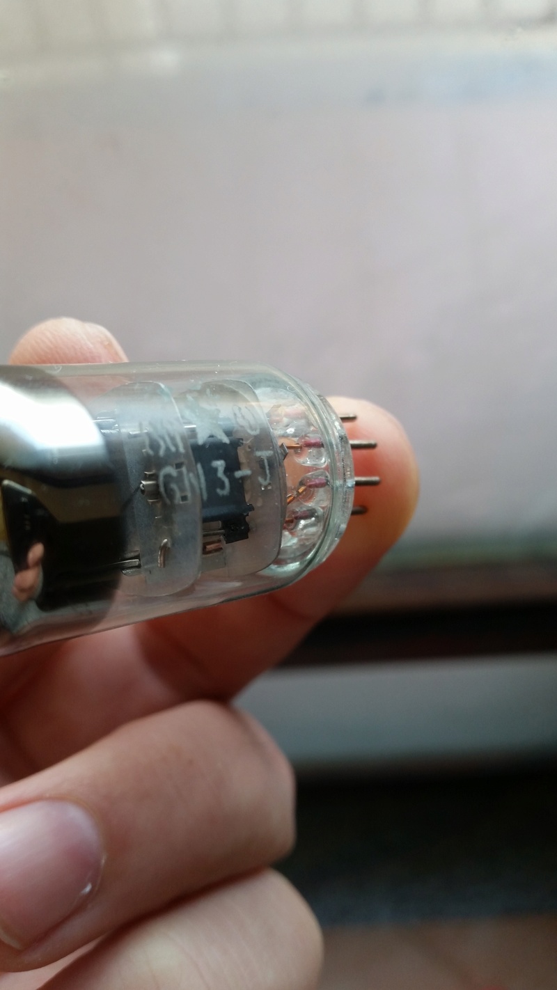

6N3?
6N3, Tube 6N3; Röhre 6N3 ID21974, Half-Wave Vacuum Rectifier
I suspect you mean 6N3P
https://frank.pocnet.net/sheets/112/6/6N3PE.pdf
If you increase R8 to 1k2 that should reduce the gain. There is a mismatch though, 33k anode load working into a lower than 8k load. (47k load resistor in parallel with 10.4k).
2u2F and 510k, have you worked out the low frequency pass 3db point yet. Sub sonic!
220nF should be adequate.

6N3 (not the rectifier tube lol) is the Chinese equivalent of the Russian 6N3P.

.. This is the valve with the original KIT ..6n3-J ...

are not very practical with the valves, I did not understand this you say "" "There is a mismatch though, 33k anode working load into a load lower than 8k. (47k load resistor in parallel with 10.4k)" .... I have to reduce the resistance of the anode from 33k to 8 K? thank you.

... Based on your advice, I changed how to see the schematic (values in red) .... I did not understand your advice "" There is a mismatch though, 33k anode working load into a load lower than 8k. (47k load resistor in parallel with 10.4k) ""
Since this modification have not detected a significant reduction Gain is, but the detail, the scene and the sound is much improved, ....... was reduced, however, the low sound range!
Take 1 step not two. Focus on 1 "problem" not two at same time.
You replaced both C2 and R8 and don't know what caused bass level to drop, AND make remark about gain not being lower, but detail improved.
I read in Jon's post that the low value of feedback resistor R5 (then 10k) is too low for RO2 to work properly, next you lowered resistor R5 further to 8k2. Further deteriorating situation for RO2 valve.
I suggest for now to forget about the too much gain part of your problem and first make amplifier work better, not affecting signal too much.

...you are right, one step at a time, I was wrong 😡...... I can go back to C2 and put back 2,2uF ... you say? .. while I did not understand about R5 .... I have to increase the value (already 8k2)? ...

Now I would replace R2 by the 33k resistor that is now on plate RO2. I would use much lower value for plate RO2, 5k maybe. And I think R5 then can easier be like 20K. Biascurrents go up a little, if transformer is small maybe voltages will drop, I think you can test.
