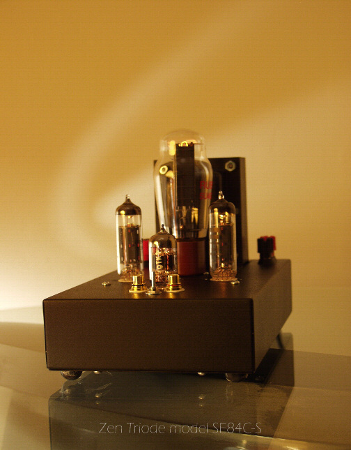

The Decware Zen is a really nice little amp (about 2W) and comes as a fully documented kit with all the parts.
Click the image to open in full size.
There are a couple other variations if you want to spend more or less.
dave
