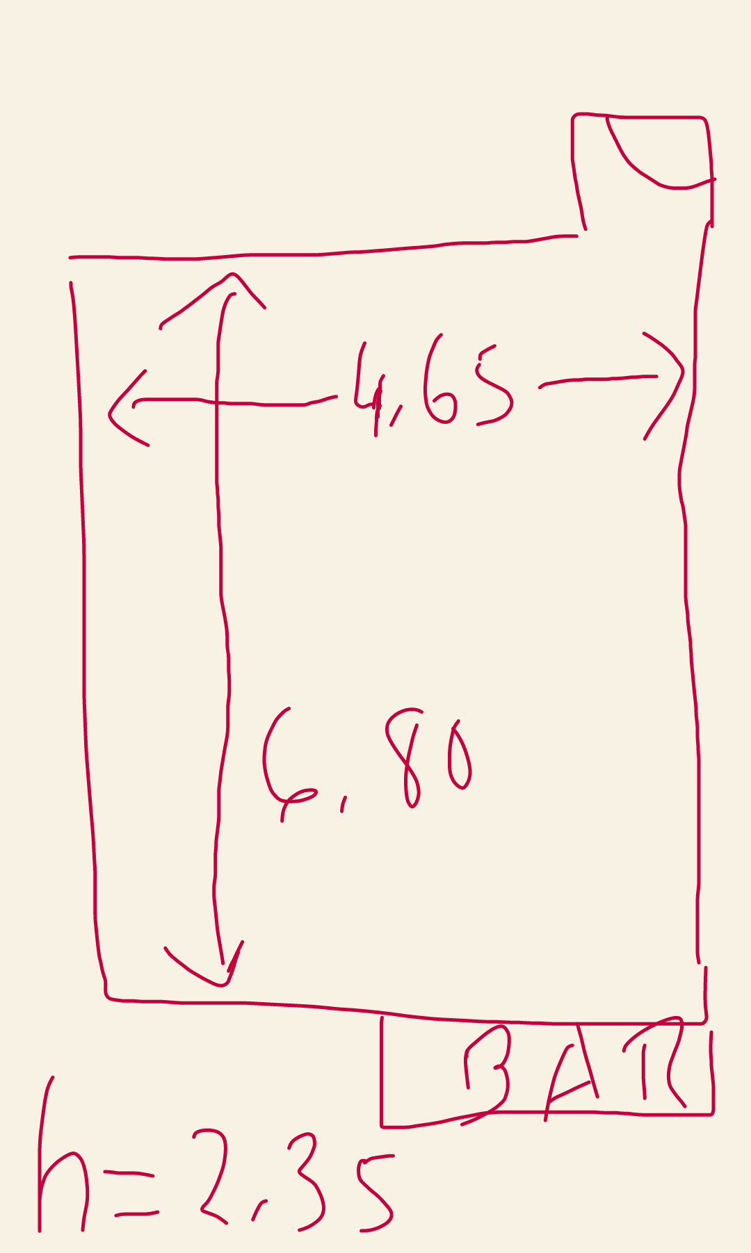

I'm a pianist/musician. I'm trying to find out whats the best choice for me. I want to hear mostly classical music and also jazz, blues. My room has this measurements:
All measures in meters
I would like to know your opinions regarding my initial choice : the tubelab se (not the simple one) and the fostex 206en (enclosure to decide). I'm a recent diy guy but i have someone with electronic skills to help me and i also have the right tools to build everything. I'm open to discuss all your suggestions.
Thank you very much. I hope you can advise me wiselly.

That is similar to the room I have my tubelab SE in. My speakers are fostex ff165k's.
I have a subwoofer.
It is definitely loud enough.
I'm very happy w/ the Tubelab SE and the Fostex speakers.

I have for my Fostex 206E: Dallas II BLH Plan
http://p10hifi.net/FH/downloads/Dallas2-plans-redraw-270113.pdf
For listening Instruments, voices, simph. music, jazz, soul....and I'm very glad. /IMO, hornes are one of the best variants for listening/.
