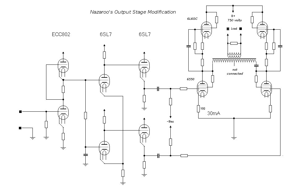

Hey Stee:
Feedback loops over 4 stages + transformer are just crap.
Try this instead. You will get far far lower distortion, for just two more tubes and couple of caps.
Click on pic to enlarge:
A bit off-topic, Nazaroo, but what are you using to draw schematics?
I just used his posted schematic.
And GIMP (Linux)
Ahh - missed that. Thanks. I thought there might have been some clever program at work. No. Just a skilled user.
I could write the clever program,
but I'd make both of us obselete.
