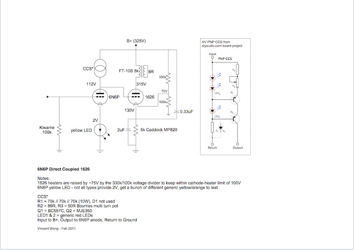

Hi Dsavitsk,
It looks like a plausible design. I built something similar recently, but without the CSS at the output tube. I used some Caddock resistor instead and had some hum feedback loop.
Click the image to open in full size.
