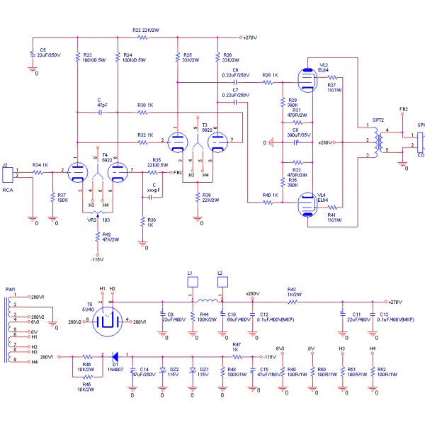

As we soon move to a new house, it is time for a new tube amplifier!
I am looking for a really nice sounding push pull design, using el84 or also kt 88 tubes (as I like them). Initially I wanted to do a Single ended KT88 project, but yesterday night a colleague who is an audio professional convinced me to build a push pull amp.
I do not need a lot of power, actually I have an 8W tube amp which works fine, but I would like something around 15-20W to drive some less efficient speakers.
What I am looking for is a working schematics for a really nice sounding amplifier (other call it "high end").
Can anybody help me ? (I looked a lot into SE designs lately but am kind of lost of finding "the" schematics for a nice push pull amp.

Do you want to build an integrated amp or mono block power amp?
Cheers
Christoph,
I get the feeling that an "El Cheapo Grande" would do nicely for your project. Power O/P is "15" WPC in triode and "30" WPC in UL. The EC schematic uploaded shows 6V6 family tubes. To get a "Grande" you use 7591 "finals" and a higher B+ voltage voltage. Small signal circuitry that works with "12" W. O/P tubes also works with 7591s. Fisher, Scott, etc. took full advantage of that fact. You can too.

Thanks a lot for the info so far. I am looking more into an integrated amp, no monoblock. i am not really fixed on the kt88, just like the design.
Best regards
Christoph
Ok cgraf. I would recomend building Triode Dick´s Bill UL KT88. I have just finished building one, se post above, and I would say it´s the best PP amp Ivé built. I did change the PS to tube rectified GZ34 instead of using bridge SS rectifier. I have schematics for the PS if you are interested. Also if you need power transformer and doubble C-core output transformers I could set you up with Bartolucci transformers. Shoot me a message.....
