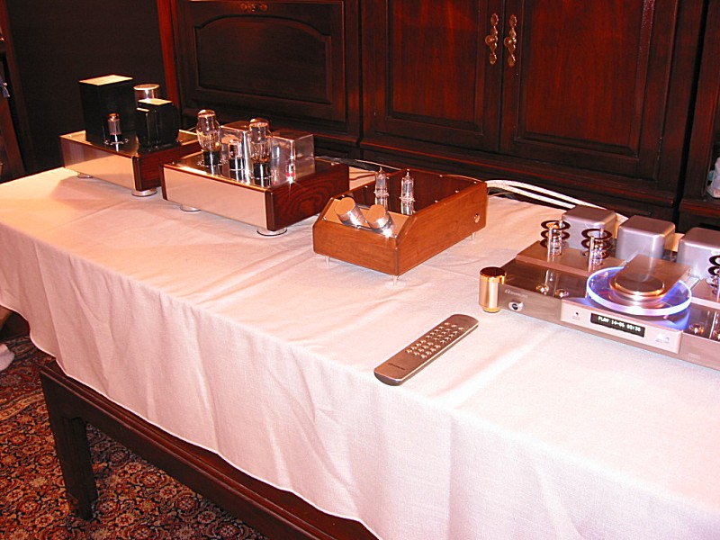

After a couple of final tweaks to get it dialed in, I got .33 ripple at the first filter cap and 2mV at the speaker terminals. Not the best amp money can buy but I'm real happy with my first endevor to the tube amp world.
