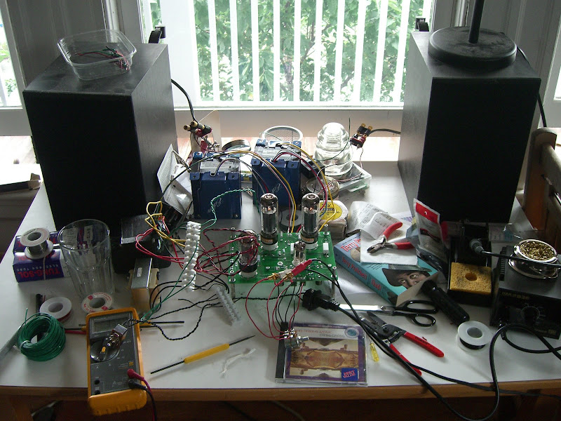

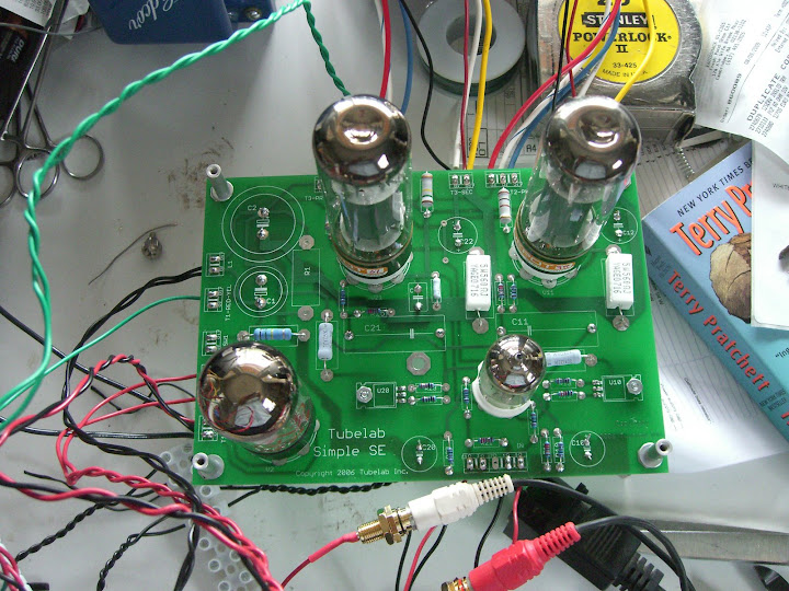

I powered up my first build ever, a Tubelab Simple SE, just now -- beautiful music on the very first try!
No motorboating, no hum, and definitely no magic grey smoke, just sweet Thelonious Monk.
George, thanks for making it so easy and fun!

Details:
Tung-Sol EL34B, Electro-Harmonix 12AT7, JJ GZ34 (all new stock)
Vacuum-state rectification only, no FREDs.
Allied Electronics 6K7VG power transformer
Edcor CXSE25-8-5K output transformers
Triad C-14X choke
560 ohm R17 (cathode bias resistor)
Alpha 24mm pot
Radio Shack switches
eBay RCA connectors and binding posts
Mojo courtesy of George of tubelab.com
It's currently hard-wired for ultra-linear and cathode feedback; when put in the chassis those will be switchable.
It took, all in all:
- 2-3 months of planning and ordering.
- Three hours of soldering the board yesterday.
- Two hours of soldering together all of the connectors today.
- One scary moment installing the 12AT7 (it took a lot of force)

Congratulations!
Mr. Safety here...
One suggestion; I would keep the loose conductive objects further
away from the "high" voltage. The Stanley tape measure and scissors
look to me like an accident waiting to happen.
Personally, on my own breadboards, anything not meant to be in the
circuit is removed from the surface before power is applied.
Cheers and stay alive,
Michael
