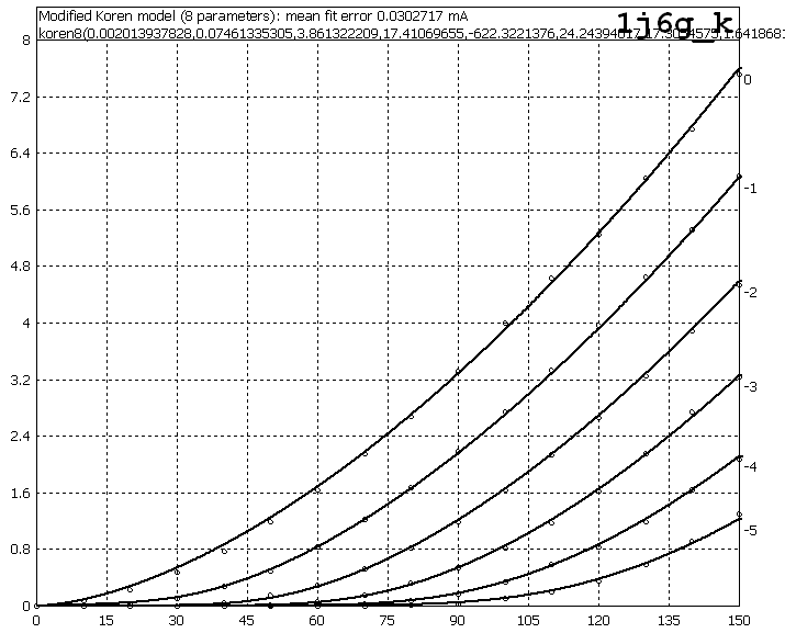

Hi all, I got some 1J6G dhts but can't find anything but class B typical operation specs. Does anyone who's used them have any suggestions?
I managed to measure the current and then draw the curves using curvecaptor.
I'm thinking of 4.9mA, Vg=-1V, Vp=135V. I'm sure someone uses these tubes, please advise.

Just looking at your plate curves 4.9ma at 135v would leave very little room to swing any voltage and would likely exceed maximum plate power dissipation as well.
Try drawing a line from 135 volts to about 4 or maybe 5.6 ma.
This defines your load resistor R=E/I. Grid bias somewhere between -1 and -2.5 volts depending on if you want lowest distortion or highest gain/headroom.
Cheers.

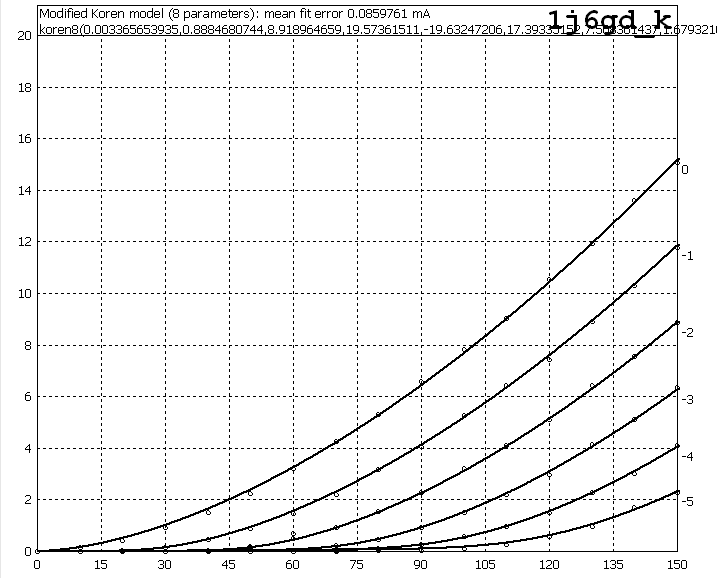

From the data sheet it's not clear what the max plate voltage or current should be. The swing at the plate should be around 8-9V, for the headphone amp I'm planning to build. Also, I'd like to keep the input p-p signal to about 500mV.
Since this is a double triode, I've also measured the two halves paralleled. Here's what it looks like, if anyone may need it for simulation or design. For the two in parallel maybe 3mA at 140V. Since I'm planning to use either a ccs load or a gyrator load, it's not exactly like drawing a resistor load line, or am I wrong here?

I would suspect that with the operating point near the upper right hand part of the curves, the tube may be running too hot.
Don't know what a gyrator is but with a ccs, loadline is horizontal at your chosen current.
