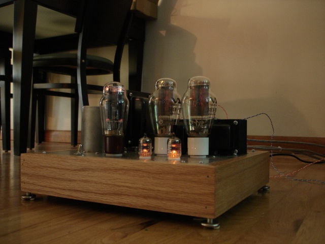

I've got a pair of the valve art 300b-98c titanium mesh plate tubes, and was just looking for another pair. I can't find them anywhere. Last year a few vendors had them, and a lot more 300b's. Now the selection seems to be slim. Have some tube manufacturers gone out of business, or something?
and, here's a photo of my amp w/ those tubes.

Really nice looking amp. The layout reminds me of the Tubelab SE, but I thought the board didn't lend itself well to under chassis mounting. That's an awfully fine looking rectifier, too. Is it GZ37?
I started building an under deck Tubelab SE almost a year ago, then things got hectic, and that amp never got finished. I went through all of 2008 without building a single amplifier! I promise not to let it happen again. Other builders have figured out ways to mount the Tubelab SE under deck.
The secret of an under deck Tubelab SE is to make socket extensions similar to the old "socket savers". This lets you build the board in the normal fashion but raise the tubes up about 1 and a half inches to be flush with the deck.
There are some excellent photos of wicked1's and akirasugai's amps in the Photo Galery thread, including detailed photos of the socket extensions. I made my extensions out of brass tubing from a hobby shop with no housing. See page 93, posts #2307, 2308, 2309, 2312, 2314,2315,2316. Page 94 post # 2350 shows wicked1's amp.

Hi, thanks for the comments!
There are a couple of better (better angle, more light) pictures of my amp a page back in the photo section.
It is indeed a tubelab SE. (Thank you, George!)
I also used brass tubes to make the extensions for my input tubes. Basicly, bringing them to the height of the output tube and rectifier sockets. My resistors are on top of the PCB, and my caps are on the bottom. The IC's are also on the bottom of the PCB w/ their heatsinks. The 5pin ic is connected via very short jumper wires from the top of the board, so that it can lay flat.
Last night the 5pin ic, 5v regulator, shut down from overheating. I guess I need a better heatsink now that it is closed up in a case. I was happy to see it was the auto shutdown of the IC, rather than having blown my tubes or something!
And I'm really sad to hear these tubes are probably not being made anymore. V.A. had 3 or 4 different 300b's on the market. I was hoping I'd be able to try different tubes over the years. Now it looks like we've only got a few choices on the market for 300b's, and maybe only one inexpensive option.
Rectifier is a 5u4g, cheap one, too. I was getting far too much voltage from my Hammond pt, and the 5u4g brought the voltage down about 20 volts.
If mounted in a closed box a fairly large heat sink is required to stop the thermal shut down. My original Tubelab SE worked fine with the small heat sink specified in the parts list with 45 and 300B's, until I mounted it in the small Lexan box. I added a heat sink that I liberated from the Pentium chip in a junk computer and all is well.
