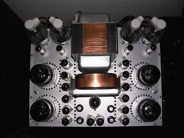

Here is my amp seen from above with the big toroidal choke and its magnetic shield,

Since I am an amateur and since I have no means to exactly calculate such a choke, I did it by trial and error.... In my old amp I used a 150 W industrial mercury arc lamp choke as rectifier input choke, and in this big amp now I took a 250 VA toroidal core (former mains xfmr with all coils removed) and put on it a (former) 24 V and a 12 V coil - just to have some variation possibilities. Finally I came to using the 24 V coil - the entire coil certainly gives better limitation results, but voltages start to drop significantly on high load.
The small rf choke in the plate lines of the 866A is to reduce rf and ignition noise, and the 22 Ohms - 47 uF - 22 ohms - 470 uF chain allows for good smoothing with moderate input currents.
