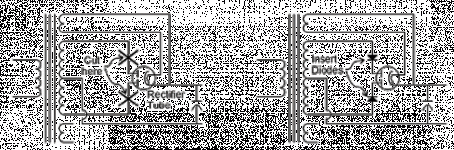

for capacitor input power supplies, like the SSE/TSE/SPP, the 5AR4 needs a minimum amount of resistance in the plate supply feeding each plate of the rectifier tube. RATING TABLE III on page 3 shows that as the transformer voltage increases, more resistance is needed in the transformer circuit. In my SSE build, I used a 400V Antek toroid power transformer which has only 28 ohms resistance and 50 ohms impedance (according to PSUD software) in the secondary circuit. So I added a pair of 100 ohm wirewound resistors in series between the transformer HV leads and the PCB to comply with RATING TABLE III. I had 25 watters which I used although 5 watt rating would probably be plenty.
As far as I can tell when playing around with PSUD, there are two times when the 5AR4's current draw I(D1) rating is approached or exceeded; during inital startup to charge the capacitors, and after startup if using power hungry tubes like KT-88s/6550s in the SSE.
For the parts I used and operating conditions, adding the resistors made the error messages go away on PSUD power supply simulator under both scenarios (startup and after 11 seconds or so).
Adding the recommended optional in-rush limiter thermistors (on negative leg of B+ and in series with power transformer primary) will help for startup, but I'm not sure if they have enough resistance after warming up to limit the 5AR4 current surges when driving the bigger tubes in the SSE under all conditions as the tubes age when using low impedance power transformers.
Although most folks don't have problems, I've read about the fireworks some experience and decided to play it safe and spend a few pennies on resistors to potentially save expensive transformers and tubes.
Hopefully this will help. I'm still pretty new to all this, so feel free to chime in if I'm leading anybody astray. Thanks.

Adding a silicon diode in series with each plate of a tube rectifier does offer some added protection against rectifier arcing. Actually it helps quench the arc once it starts.
The rectifier tube has a tough life. It must fill the empty filter caps as its cathode is just starting to emit electrons. The filter caps look like a nearly short circuit load on the rectifier tube as it is warming up and at a fraction of its emission capacity. The tubes produced 50 years ago have a cathode coating that is nearly uniform and all of it heats at the same rate. Some of the tubes sold today have an uneven coating which heats up faster in the thin spots forcing all of the start up current to take place in a small area. The total current demands on the tube may be in spec, but the current density may be very high in one small area of the cathode. This can lead to an arc if the current density is too great.
Once an arc starts it is hard to stop. If the input filter cap has partially charged the voltage across the arc will be higher when the plate swings negative. Adding the solid state diode in series with the plate removes that negative half cycle stress from the rectifier tube, and it halves the total time of voltage stress that is feeding the arc. This 16mS of no voltage across the arc can be enough to stop it.
Adding a silicon diode in series with the plate should not cause the harsh harmonic hash that a pure silicon rectifier does since the tube is still doing the work. In a pure silicon rectifier the diode switches on rather abruptly as soon as the secondary voltage rises 0.7 to 1.0 volts above the voltage stored in the filter cap. This abrupt switch - on causes a current spike that can find its way into other circuits and into your audio.
With the tube / diode combination the diode will turn on as the secondary voltage rises 1 volt or so above the capacitors voltage, but the current will still flow until according to rectifier tubes VI characteristic as it does with the tube alone. You will just lose about 1 volt of B+.
This mod is relatively easy to do on the SSE. Simply disconnect the red transformer wires from the PC board, solder a 1N4007 or UF4007 diode on the end of each wire with the stripe on the end not soldered to the red wire, cover the diode with heat shrink tubing, and insert the striped end of the diode back inth the connector on the board where the red wire was.
This mod will also work on the Simple P-P board but DO NOT do it to the Tubelab SE board or you will not have any negative bias and your output tubes will fry!

Hi George,
There are several reasons why rectifier diodes shouldn't be used to replace rectifier tubes in older gear. You know this, but many people don't. For similar reasons, using a #83 rectifier (or similar) as an "upgrade" causes very similar problems, being a mercury rectifier with an almost constant 15 V drop with varying current draw.
You can use silicon diodes if you also include enough series resistance to duplicate the tube versions I-V curve. I guess a purist could also install a series zener for the static voltage drop, but that's way out there. The added resistance will help with generated noise on switching, and a parallel R-C snubber across the diode will silence the beast. Snubber circuits can be seen across tube rectifiers in some designs, although this may just be a capacitor without the resistor.
The point is that there is no reason why using a silicon diode means you have to live with HF noise bursts at the line frequency. Just think a bit when the design is finalized.
