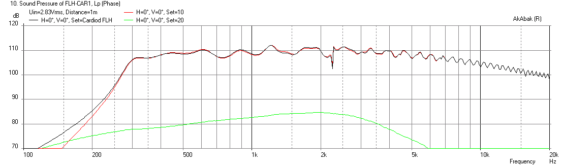

Oh cool, I didn't realize you could define the location of the radiator in space.
So you're saying that if I had a picture like this, that I could model the two radiators in Akabak, while including the gap between the two radiators and their size?
Updated script with physical locations of radiators
Yes. I have done it here below...
Here is the result of a script modified to include radiator locations and orientations. The horn loaded driver is very efficient and overpowers the dipole driver so not much cardiod action going on. You can see the output of dipole driver in red is 85dB and FLH one is 110dB. You will need a 100dB sensitive woofer for the dipole driver for it to make a difference in cardiod polars.
Freq Response (black=combined, red=horn mouth, green=rear dipole rad):
Polar (500Hz, 1kHz, 2kHz):

"The horn loaded driver is very efficient and overpowers the dipole driver so not much cardiod action going on. "
So, how much directivity are you assuming for the FLH portion of the horn?
Standing behind a small horn stack (4' x 4') shows a big difference in output, such that a big driver driven as I suggested above will achive a large degree of cancellation.
Can you write an AkAbak scrip to model this?
I don't know what directivity assumption you are asking about. In the above script I have modeled the FLH output per Patrick Bateman's script but with the addition of physical placement, size (based on area of mouth radiator) and direction of output (assumed front firing and serving as axis of reference). The dipole driver is firing backwards with slight vertical offset as suggested in the patent drawing (although that effect is negligible). The directivity is calculated by AkAbak assuming a piston radiator model for the driver. For the horn mouth - I am not sure what radiator model is used - will have to look it up in manual but probably assumed to be a uniform planar area.
For your 4x4 stack what are the details? Is it 4x4 FLH what mouth area vs box size, drivers, horn length, flare rate, rear chamber etc? Easy to model as you can see from script above but your question completely lacks details.
