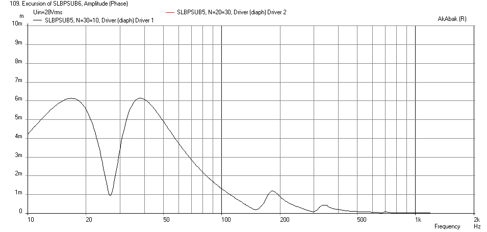

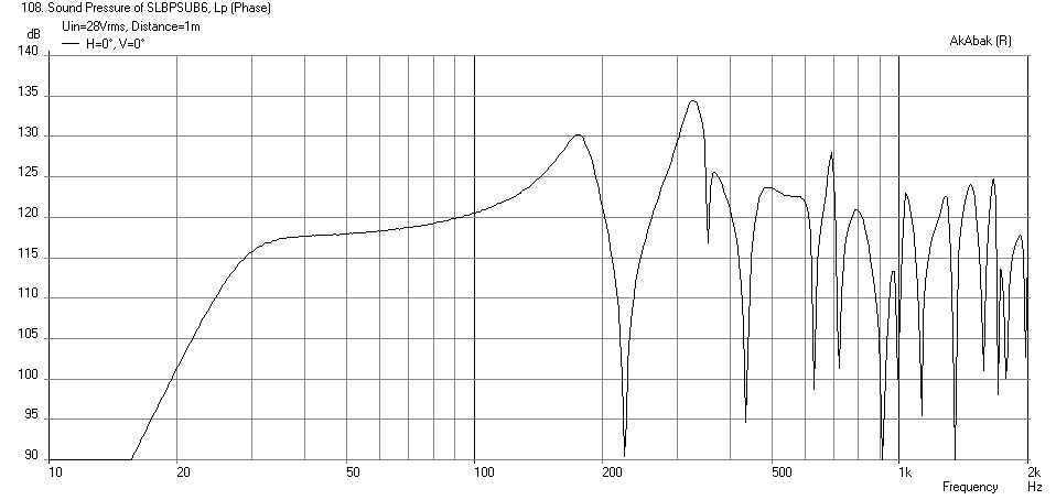

Sim of Slot Loaded P-P Band Pass Sub (SLPPBPS)
Using 300 liters for the chamber and dual 3.0 in deep x 19.0 in high x 20.0 in long channel vents leading to the single 19 in tall x 9 in wide x 19 in deep front-firing slot port, I get the following results. To get a flat response and maximize bass extension, I set the -12 dB/oct high pass filter at 25 Hz. You run out of xmax at around 28 volts. This gives a max SPL (into half space) of 117.5 dB at 40 Hz and -3dB point is 29 Hz.
Freq response at xmax with 28 volts drive:
Cone excursion at 28 volts:

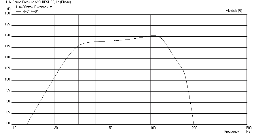

With 120 Hz -24dB/oct low pass filter applied:

Thanks for the replies... Quick question on the above design.
Would increasing the chamber size to 400 or even 500 liters help with extending the bottom end closer to 20Hz with 12db HP and 24db LP?
This design can sacrifice output for extension

the real issue is that the sigma 18 runs out of xmax ABOVE The displacement minima (aka, above 28 hz, around 38hz) with little power in. It would be beneficial (IF YOU GO PORTED) to both slightly increase box size, and tune a little higher (moveing excursion minima up to around 35hz would likely help.
a 12 db hp is not going going to cut it.

Guiness,
Yes, the picture is close - I removed the front horn expansion on yours as you did not seem to have or want that. The design on the other thread was done for CLS and is essentially the same but with tweaked dimensions to match what you specified. I think both are fine but like the extension if the one I did for CLS better. If you can sacrifice SPL then that one is better. You should build it. 😀
Btw, go with a -24dB/oct HPF to achieve better bass extension as it lets you cut the excursion deeper down.
