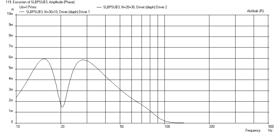

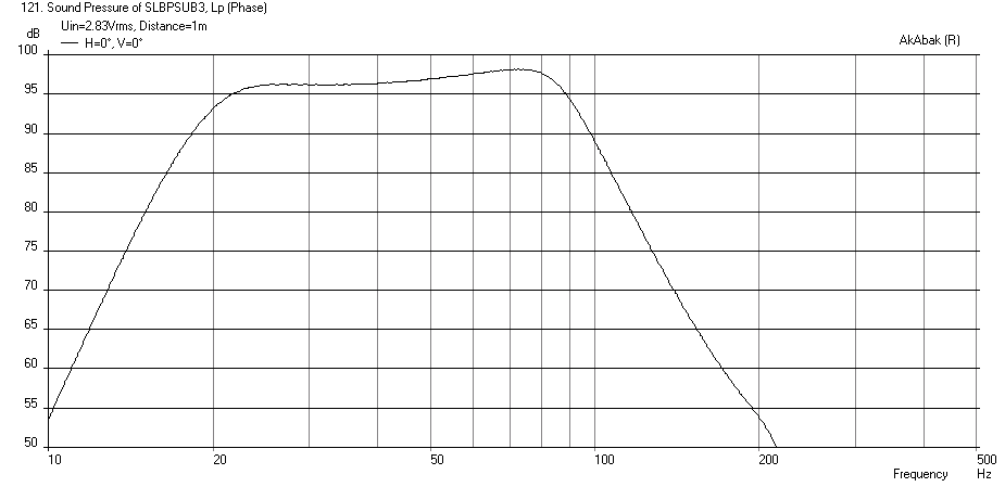

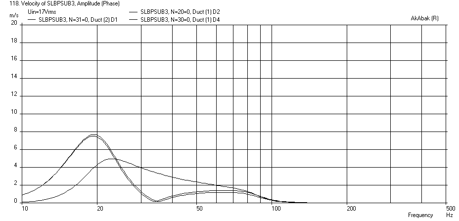

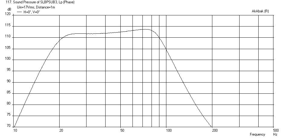

Here are the details of the simulation: 225 liter chambers behind each driver, 1.75 in x 21 in high x 14 in long vents connecting each chamber to central slot with dimensions of 6.0 in wide x 18 in long x 21 in tall, slot leading to front horn with mouth of 18 in wide x 21 in tall x 8 in long. Have not calculated overall box dimensions but it appears to be under 500 liters per your request at 21 in tall.
Sensitivity response with 2.83 volt driver:
Cone displacement at 17 volts at xmax:
SPL vs Freq response at xmax:
Port velocities:
Impedance:
For home hifi use, it should be loud enough and quite sensitive at 96 dB at 2.83V for 25 Hz and 93 dB at 20 Hz. It peaks out at 112 dB near 20 Hz and this is something that you definitely feel and probably all that is needed on transient peaks for normal listening at circa 80 to 85 dB program.
Port velocities:
Impedance:

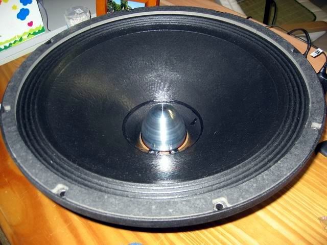

The current product of Eminence is Sigma Pro 18A-2. Mine is the old version without "A-2".
The differences -as I can see on the datasheet- are only the magnet size (90 vs 120 oz) and power rating (400 vs 650 W), all other parameters are identical. How interesting.
And I've done the following modifications on it:
De-cap, adding phase plug, PVA coating on the cone (both sides), softening the spider by silicon oil and some minor cut (or scratch?).
So, compare to the published numbers, the measured t/s of my own woofer are somewhat different. You may see the dropped fs & Q. (Before the mods, I remember the measured numbers were pretty close to the publish.)
I've been using 4 of them on OB for years. Alas, for OB, this is probably the last choice. This size of driver is hard to sell here, I just have to find ways to use it.

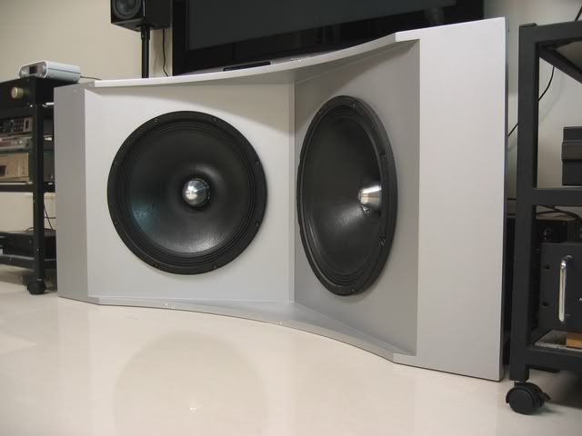

Do you have photos of your hot-rodded Sigma Pro's? Four of them in an OB would sound indeed very good and I think if you wanted, use two of them in a slot loaded OB like this would be very nice too: http://www.diyaudio.com/forums/full-range/249984-cheap-fast-ob-literally.html
Yeah, I like slot loaded, too. And, actually they already are ! 😀
About the modded woofer:
I won't call it a hot-rod, patched rather.
Looked nicer in a distance (on an old V-shape baffle, now history):

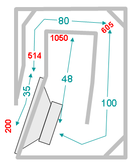

Hi X,
With the woofer specs in post #1, I made a rough drawing of a tapped horn and associated sim on hornresp:
Numbers in green are path lengths in cm, red are cross section areas in cm^2. (The internal width of the box is set to 50cm.)
The sketch is not to scale and I know there'd be quite a lot of problems in the details, but this is more of a concept than a blue print.
Sim:
Helped by the tapering path, it gets pretty low with a short length. 120dB max SPL can be as low as 26Hz or so, not bad for a 202.87 liter box.
Now, here is what I need for your help -- would you please modify the last section and make it a Karlsonator?
Thanks in advance 😀

This may take a bit longer to model as I have to change the geometry almost from scratch compared to a Karlsonator. Note that when you add the K-aperture it will reduce the effective path length of the system and the tuning will go higher. You can compensate by designing for a deeper extension first before the K-aperture.
