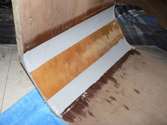

Excellent. Personally, I like braces that are in line with direction of airflow, to cut down on flow losses. Braces perpendicular to the air flow cause resistance. I also feel its very important to roundover the entrance and exit to the ports to cut down on compression. Check out this quote from my recent build thread:
Inside end of the slot port inner wall, has an extra slat of wood for a larger 180 deg round over, picked up this idea from someone making high output slot port boxes with various rounded transitions...
Port wall mounted, 45 degree angle in place, should make for a reasonably smooth transition. I may bondo or add wood to the 45 to smooth it a bit further...
Inside of port, minimal braces, still need to add a port brace to the front...
Back of box without top, cross brace ties the side braces together making one very stiff section, but off the back wall, which will hopefully allow better flow to the port. The panels are very stiff here because the bracing is exceptionally stiff, even though the unsupported panel span is ~8"...
Box as it sits so far, need to fit baffle. Roundover on port is not glued in yet. Front face is 20x16". You can see where the woofer will screw into the braces. The baffle will be 1/2" ply also, recessed from the port face 1", giving space for a square grille around just the woofer area, the port will have no grille. Will probably do 45 degree bracing behind the baffle that will catch the other mounting screws. Need to internally dampen the box with coating or dynamat, because it certainly has some higher frequency resonances....

I put masking tape on both sides of the 45° corners, about an inch away.
Then liberally put on Universal Construction Sealant and made the rounding with the back of an empty sealant container. Removed the masking tape, a bit of touching up (that's why the wood looks wet) Done!
