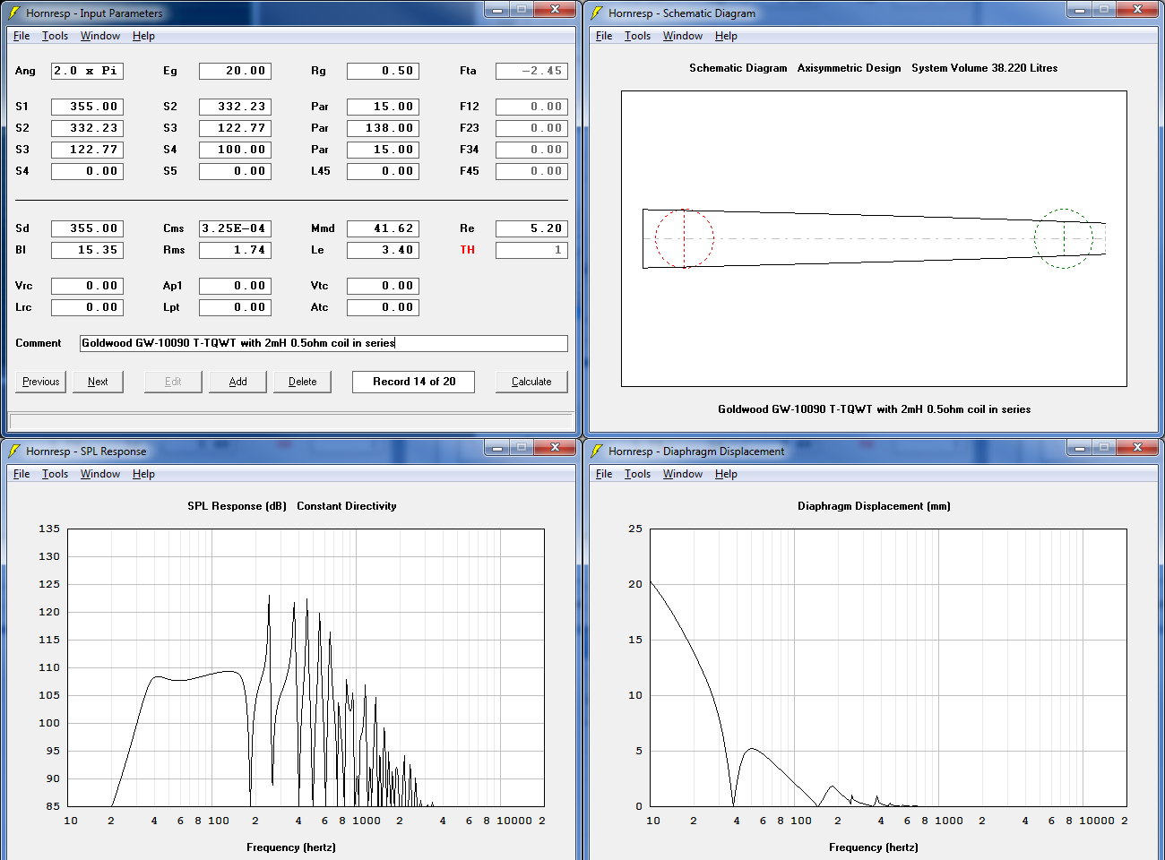

I just started with hornresp and here is my first attempt with the Goldwood 10090. Can you critique?
Why are you setting Rg @1.10? Bad speaker cables? 🙂
Good choice modelling in 2PI space first though. Easier to compare the results of your HR models with simple sealed and vented models from other design programs.
He probably took that from me, my apologies. I had an inductor in series with a design, and removed the Inductance, but forgot to take away the resistance. Rg should be 0.

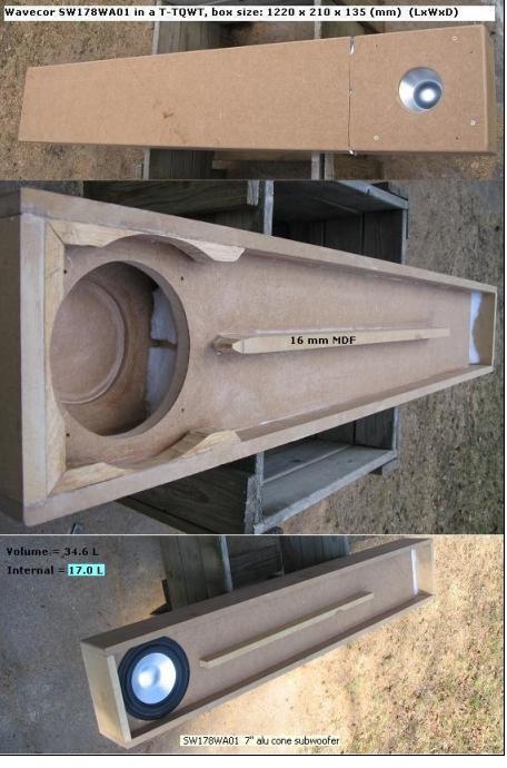

Hello James, do you have a link to an example of the cab construction for the above mentioned?

Hey Randy.
Take a look at these images detailing a T-TQWT:
The sketchup model is one I made illustrating how to translate the hornresp inputs into a real model. Yellow, Orange, Red are L12, L23, L34. Green, Blue, Violet, Magenta are S1, S2, S3, S4.
As for your Goldwood, looks alright to me, but a bit of a peak in the 40s there... and if you put the box in a corner that peak will get a bit more pronounced.
You're exceeding xmax by at bit in the mid 40s, you might want to lower Eg by one or two volts and check the displacement. Oh, and if you're using a solid state amp, you're probably safe setting Rg to 0. Unless you want to try putting a coil in series with the driver, this can often help to smooth out the response. For example, to add this coil, you'd increase the Le of the driver by 2, and set the Rg to 0.5 (the coils resistance). That's what I had been doing when I made my design suggestions for you, and carelessly left the Rg changes when I took away the Le (inductance). Oh, and one more thing, if you're looking at designing a square box, where two sides are always parallel, and the cross-section increases only due to one slanted side, your expansion rates should be Par, not Con. Double click the Con until it says Par.
(if you did want to build a horn with Con expansion rates, it would have to expand equally in all directions, ie be shaped like a cone).
EDIT: If you want to see something incorporating an inductor (coil), take a look at this design. It plays down to 35Hz with the Goldwood, but not as loud as your design. Significantly smaller though.
