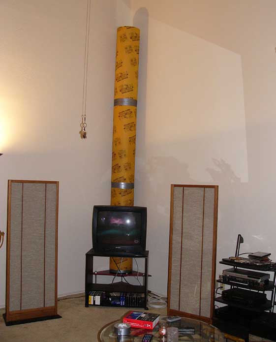

No good reason 🙂 Seriously though, TLs sound subjectively better to me than reflexes, and my last expt with a T-TQWT a few years back was encouraging enough, so I'd like to try this experiment again. For a number of years, I had the shiva in a 145 liter EBS tuned enclosure tuned to below 20 Hz and it was great for home theater purposes as long as the main speakers weren't super efficient. When I went hi-efficiency, I had to dismantle that experiment
Just for kicks, here's a 20 Hz TL subwoofer set up of mine from even longer ago, paired with vintage magneplanars , .. eventually ended up being even taller. Sadly had to be dismantled due to several major room suckouts in that room of the house I was living in. Shorty after that, I gave up trying to get any form of decent sound from that room.
http://www.diyaudio.com/forums/subw...be-transmission-line-advice-6.html#post449907
