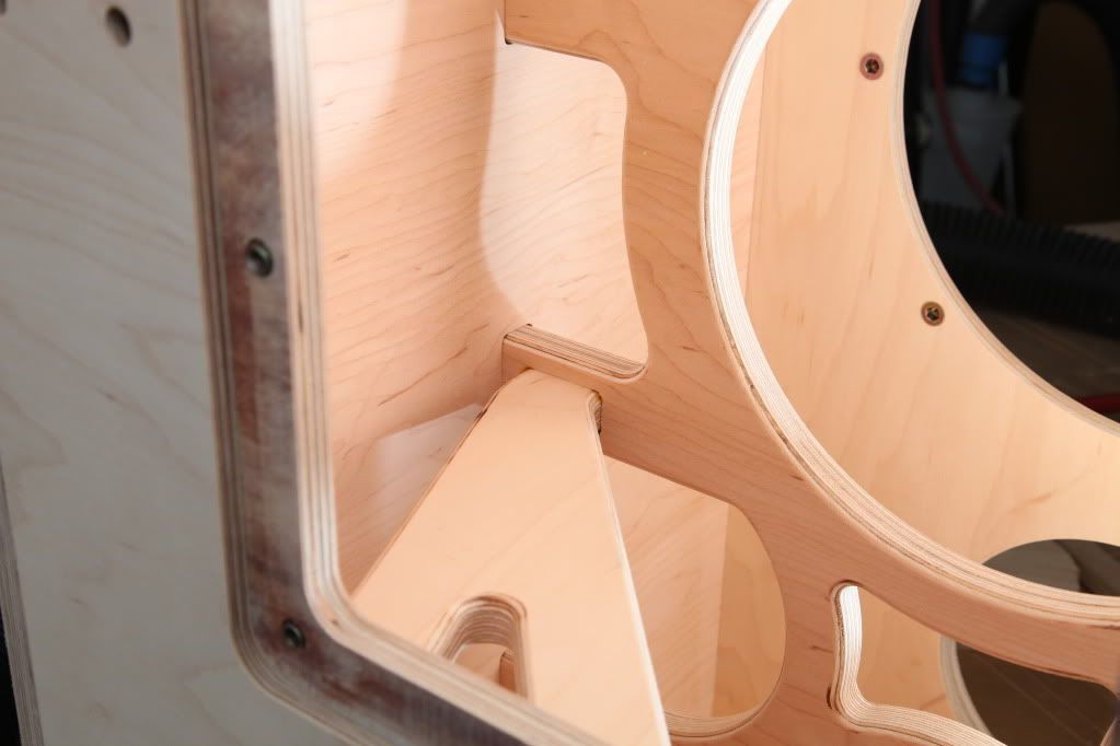

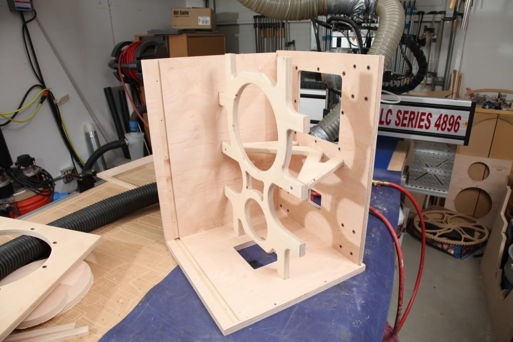

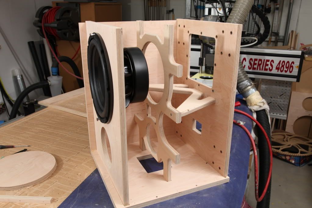

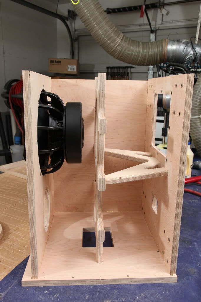

I'm building 2 of these boxes... ~3.3 cf, 4" port x 13" length
3/4" Apple ply is becoming a preferable material to use The entire box took less than 3/4 of a 4x8 sheet, all CNC machined. everything fits like a sprayed on glove
Top & bottom will have handles, the back will have 3" wheels, bottom 1" rubber feet.
Click the image to open in full size.

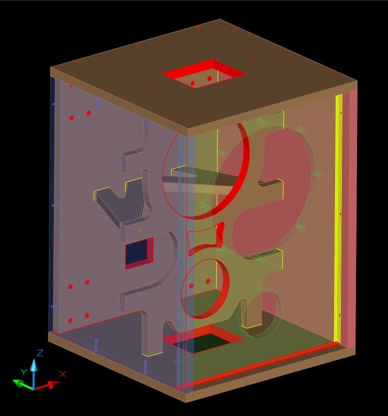

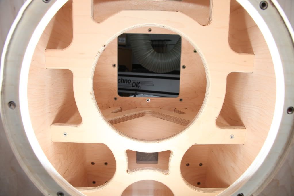

@Drumsz
Thank you, it is always fun to assemble parts that fit perfectly & nicely
@event
The CNC is a very nice build, sturdy & accurate. At the time, the choice was Shopbot or TechnoCNC
The CNC is a great tool. 80% of the time is designing & I also 3-D assemble to make sure all the parts fit before bringing into ArtCAM > CNC.
