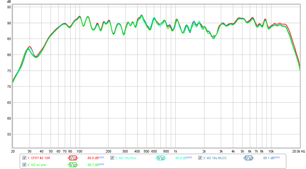

Here is measured response vs CFH7 with and without pre-amp:

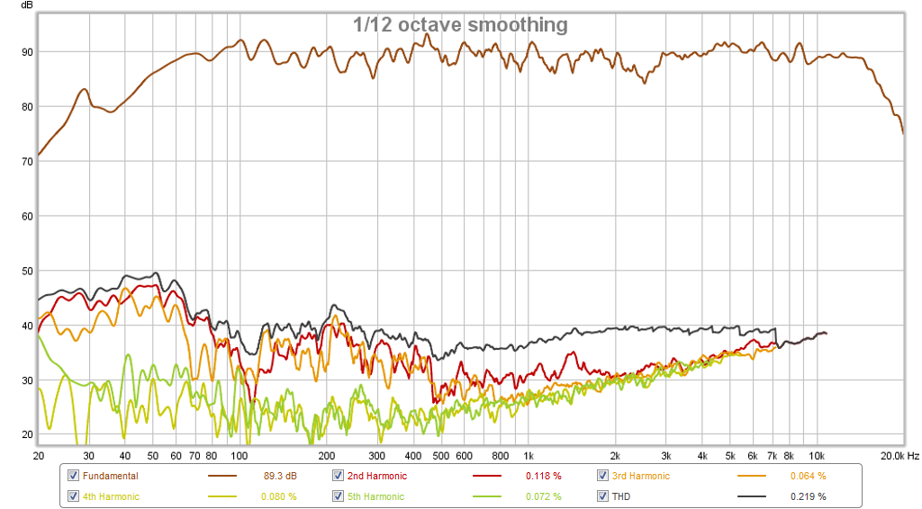

Here is measured harmonic distortion, note increased level of HD in bass region vs previous amps and also a bit more 3rd harmonic bumps:

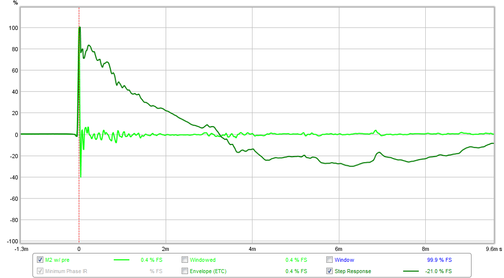

Here is measured impulse and step:

I don't know what the transformer can do to the harmonic profile. From experience listening to transformers, they are fatiguing as if producing more 3rd distortion than 2nd...
I have heard opinions (and had supporting little experience) that transformer must be of high quality to avoid the obvious sonic disadvantage. I have 6 big output transformers (size of 5A EI transformer) and 6 input transformers and have no use for them because I don't like the sound.
The dominant distortion is indeed H3 due to the transformer as pointed out by Pass in the user's manual with scope trace showing 3f sine vs 1f input. It's the signal trafo that you don't like then. In general, 3H is more egregious than 2H so not sure why so many people like all the transformers that tube amps require. The Edcor used here, although not expensive is thought to be the same as the OEM one on the M2. One other possibility is the P channel MOSFET. The PCB layout and GB by Teabag - he says that avoid the Vishay IRFP9240 and use one from different manufacturer. The sound signature is harsh with the Vishay. Fairchild FQ series may improve things some?
