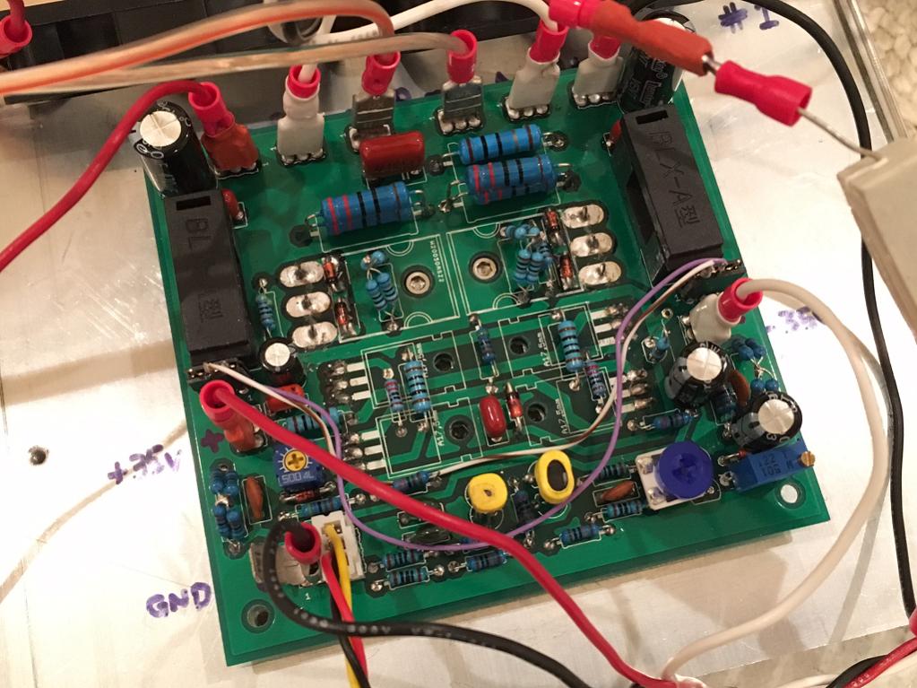

I went in stages as you suggested. Using resistor as current source. I tested the output and saw that I could adjust first get 5mA in each leg of the LTP. Then I installed the drivers and saw that I could adjust the amplitude (bias) and offset on the outputs of the IRF610/9610 via the trimpots from nice range. The I added the IRFP240's and proceeded to operate with 10R safety resistors. Bias current adjustable from zero to huge several amps, and offset was tricky (single turn pot) but stable within 10mV. I set bias for solid pure class A region of 1.3amps similar to Pass amps. Connected the speaker, DAC on input and it's now singing.
I liked what I heard and proceeded to remove the safety resistors and upon power up, the 3A fuses blew. Thinking it was inrush transient I changed to 6A fuses and it still blew. At which point I replaced safety resistors and see that circuit is sorted as it was drawing 20V across the 10R. I probed the IRFP240's and they are blown - reading of 10R to 0R - shorted. These are the first IRFP240's I have ever killed. It's got to be thermal runaway.
I replaced the MOSFETs and am running with safety resistors as current limiters. Playing music at least. I guess we need to find a way to put a current limiter - maybe the Pass opto-coupler and resistor network for current sensing? I don't think thermal feedback will work, it needs to sense the current and limit that because the thermal runaway happened in maybe 2 seconds before the fuse blew.

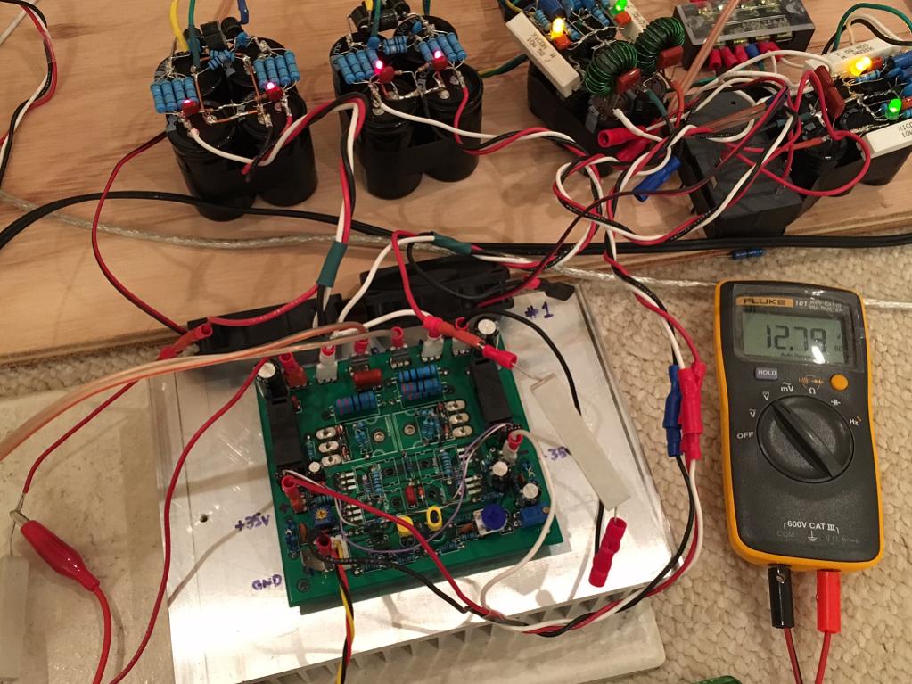

Here is the setup showing 1.3 amps across the 10R resistor:
Closeup:
Closeup:
Nice to see your creation up and running.
Under what load conditions did you test the amp?
I did test the amp with 4.7 ohm resistor.
The square overshoots you see it from the generator, this has a little amp who does that. It is very fast if the amp let it through unharmed doe you think not.
I have no caps in the amp for stability, it is just stable, no oscillations whatso ever, even with input open it do not give trouble.
I go test with the diodes, I did see I need when warming up have to use lower resistance, if you make the 10 ohm smaller the idle current drops, therefore a NTC cab be used, on top of driver things are reversed, when smaller resistance the idle current get higher, so need the PTC, this for clearance.
The bottom is so a nice place however does a diode get lower when warmed? if not it can not be used.
regards
That is sad, you did blew the mosfets, yes thermal runaway is very bad, special because you did put it on 3 amps, do you have good thermal kontact heatsink with mosfets?
I have a supply who can be limited I have put it on 0.5 amps so it can never blow.
It is not bad the sim ehh, so close it was.
Did you also try fiull feedback? by using the middel and outside pins. The new board is complete adjusted now.

The MOSFETs are not expensive so not a big deal. More of a pain to replace them that's all. I have feedback connected with red and blue wire like the diagram you posted earlier. I don't know if that is called full feedback?

... It's got to be thermal runaway.
...[/IMG]
That is no surprise. You don't have any compensation. I have build a circlotron a few years ago and I use a current source for compensation:
http://www.diyaudio.com/forums/soli...-circlotron-power-mosfets-11.html#post3070645
Q10 is mounted at the heatsink. D3 is necessary against overcompensation, so there is air to play.
D3 is an LED, and it controls the BD140 like a Vbe multiplier. I have never seen LED used as thermal sensor before.
D3 is not the sensor, Q10 is it. The LED is only voltage reference like zenerdiode. It restricts the effect of Q10.

I guess I made good progress following your tips. I now sit back and let you work out the temperature compensation and come back in again later. Getting first sound is huge accomplishment for me as I was worried I would never hear this amp sing 🙂
Hi Welcome here Moschfet.
My idea was a NTC resistor with a parallell resistor for compensation, I have now try a darlington in diode mode and this overcompensate (not at sim 🙁), so at cold start the current is in amps region, the NTc can do fine, needed in the lower section, for what X concerns he want class a and 1.3 amps idle, so mounting the ntc on the mosfet give a quick respons, your idea however is worth trying, a current source can be a splendid compensator, did not now it can act as a Vbe multiplier also, we need here experimentation, I did try with the darlington, it do work, but for x when need in class a we have to put temp sensor on the irfp itself, for class AB it go run at first but stabilizes later.
Using a fet as a sensor I can also try.
Last photo is without compensation and as you see a runaway, the other is with a darlington transistor who seems to sim oke, but it is not in real, Vbe multiplyer is just trial and error.
