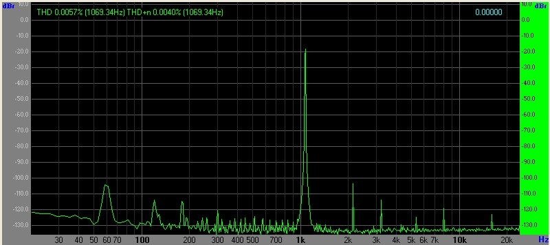

Here are some measurements I ran before I had the switching supplies. The idle current is only about 910 mA rather than 1.2A so the 8W THD figures will be somewhat lower.
8 mW into 8 Ohms Iq 910 mA no analyzer attenuation
80 mW into 8 Ohms Iq 910 mA no analyzer attenuation
660 mW into 8 Ohms Iq 910 mA

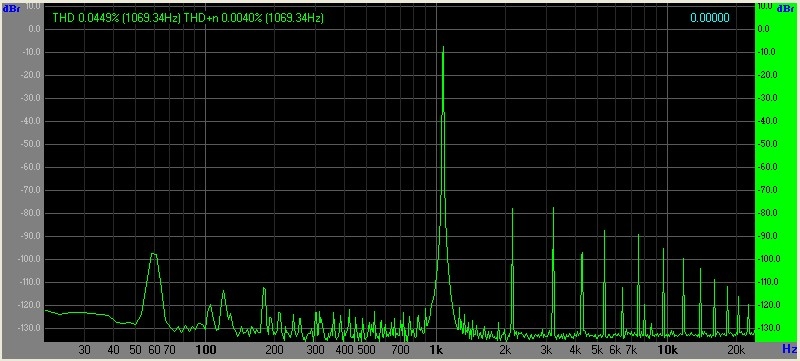

8W into 8 Ohms Iq 910 mA

Looking at how the distortion rises - in particular the higher order harmonics - at higher output levels I'm curious whether those would improve with CCS loading.
Joined 2009
I would not expect that to make much of a difference. I suspect the distortion is from the output power devices running open loop. If it sounds good, I wouldn't change a thing.
You're never curious even when something sounds good that maybe something could be changed to get it to sound even better? My curiosity's been rewarded like that on more than one occasion....😛
I'm pretty sure that the output stage was under-biased with an Iq of 910 mA at the 8W level. 910 mA would probably be sufficient for about 6W out into 8R. I'm currently running it at 1.2A/channel Iq. (0.75x1.6Apk)
I think what were seeing is compressive output stage distortion at Iq 910 mA and 8W output. Some of it is also IG-18 generator at the top of its output range.
The DRV134 and THAT1646 on their own don't produce that kind of signature. I've run a a lot of high-level highly-capacitive-loaded tests on them as line drivers and it is uncharacteristic.
I reckon (just a gut inclination no more) that when the OPS starts going out of classA the input currents start to make it look like a very non-linear load. The DRV's output Rs (50R) are going to end up with fairly nasty-looking haversine voltages imposed across them and that could be the cause of all the higher-order stuff.
I suspect that you're right about the role of the DRV134's 50 Ohm output resistors once the OPS drops out of class-A.
Having said that 8W/910mA Iq is right at the OPS class-A drop-out. Below that THD drops very rapidly. The idle current is directly related to that point. I suppose I should have posted FFTs of it near 10W with an Iq of 1.2A rather than 910 mA but that's what I had.
When I first tried it the Iq was 85 mA (small devices tiny heatsinks for HPA use) and the THD was in the 3-10% range at high levels driving 8 Ohms. And it still sounded good because the distortion occurs in compressive form at signal peaks. Low-level detail isn't affected.
I'm not gonna complain about the 0.04% THD at 8W when it was under-biased by 25-30%.
