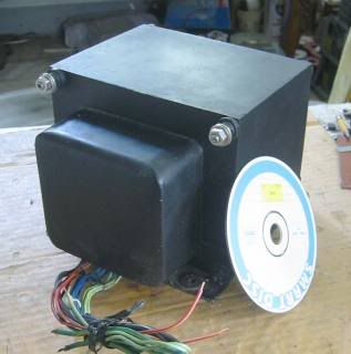

i made it myself....i design and build traffos for my own projects....😀
fyi that traffo is about 20 years old...
My hat off to you it looks fabulous! But I must warn you.... the jury is still out on whether 1750VA is sufficient for your 250W stereo amp. You may need at least a 2kW unit instead 🙂
with that traffo is was able to test my super leach amp,
with both channels driven to 45volts ac output into an 8 ohm dummy load, as per FTC....
i did not have a camera 20 years ago....
this is an even bigger traffo i made about the same time...
it has a 2 1/4 center leg and stacked to about 5 1/2 inches..
good for 4800 volt-amperes,
